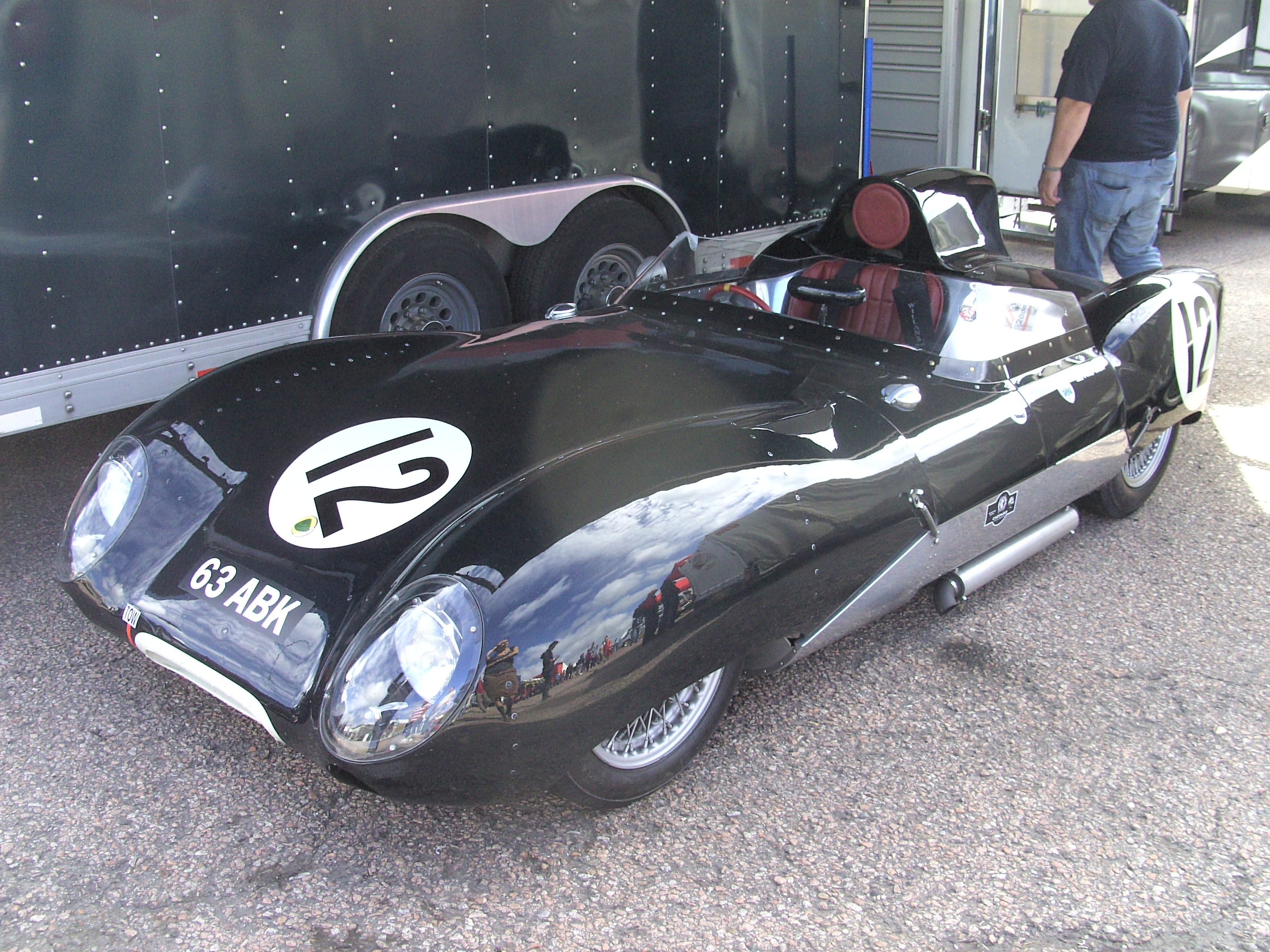

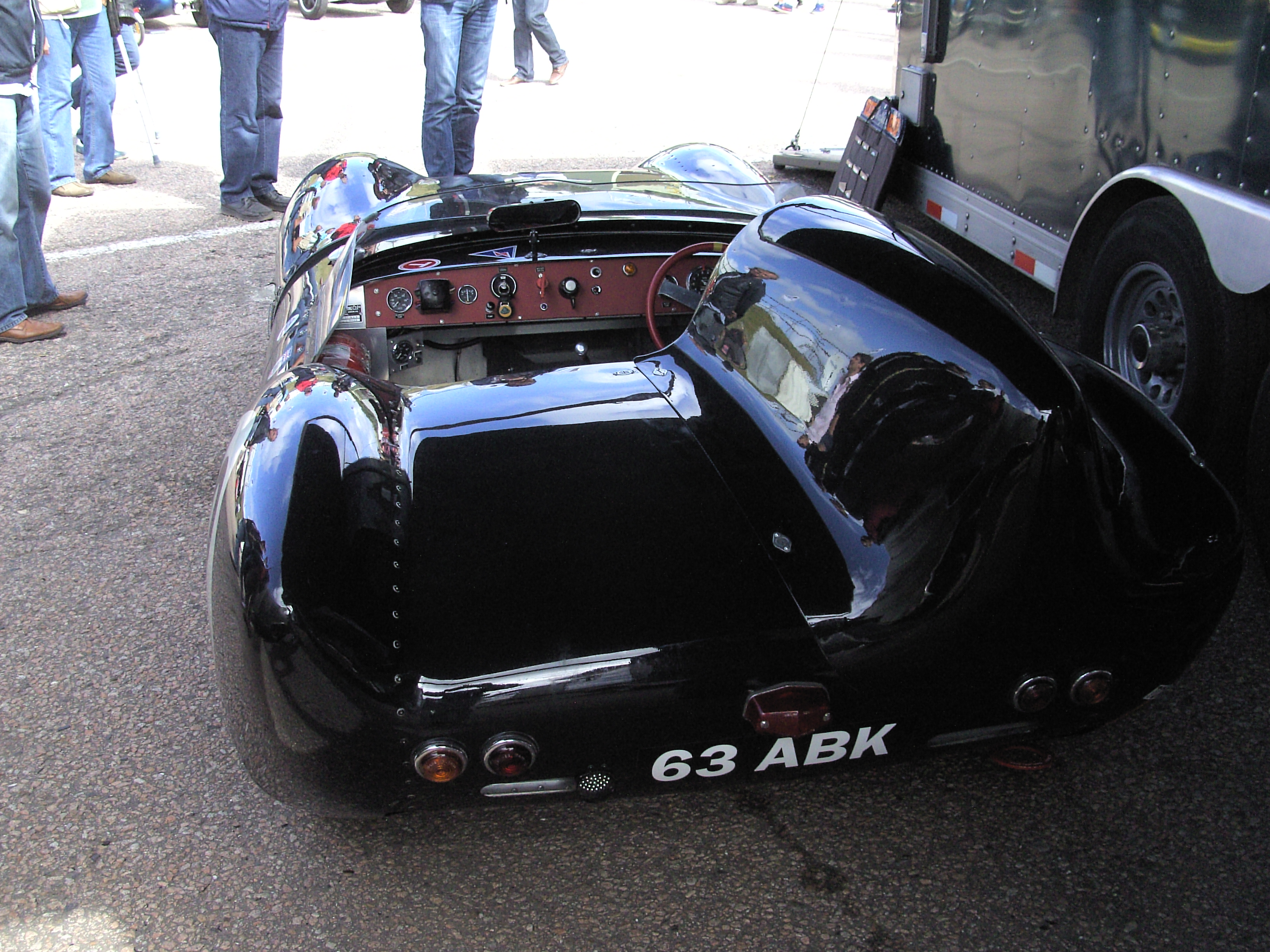

Last week I saw this Lotus XI in the paddock at the historic GP Zandvoort.
Does anyone of you know this car? Is it a real Lotus or a replica, it is certainly not a Westfield.
You know, the odd thing about this XI is, that the rear bodywork is series 1, but the frontsection of the bodywork is Series 2.
(No it was not GRP, this one was in alluminium)

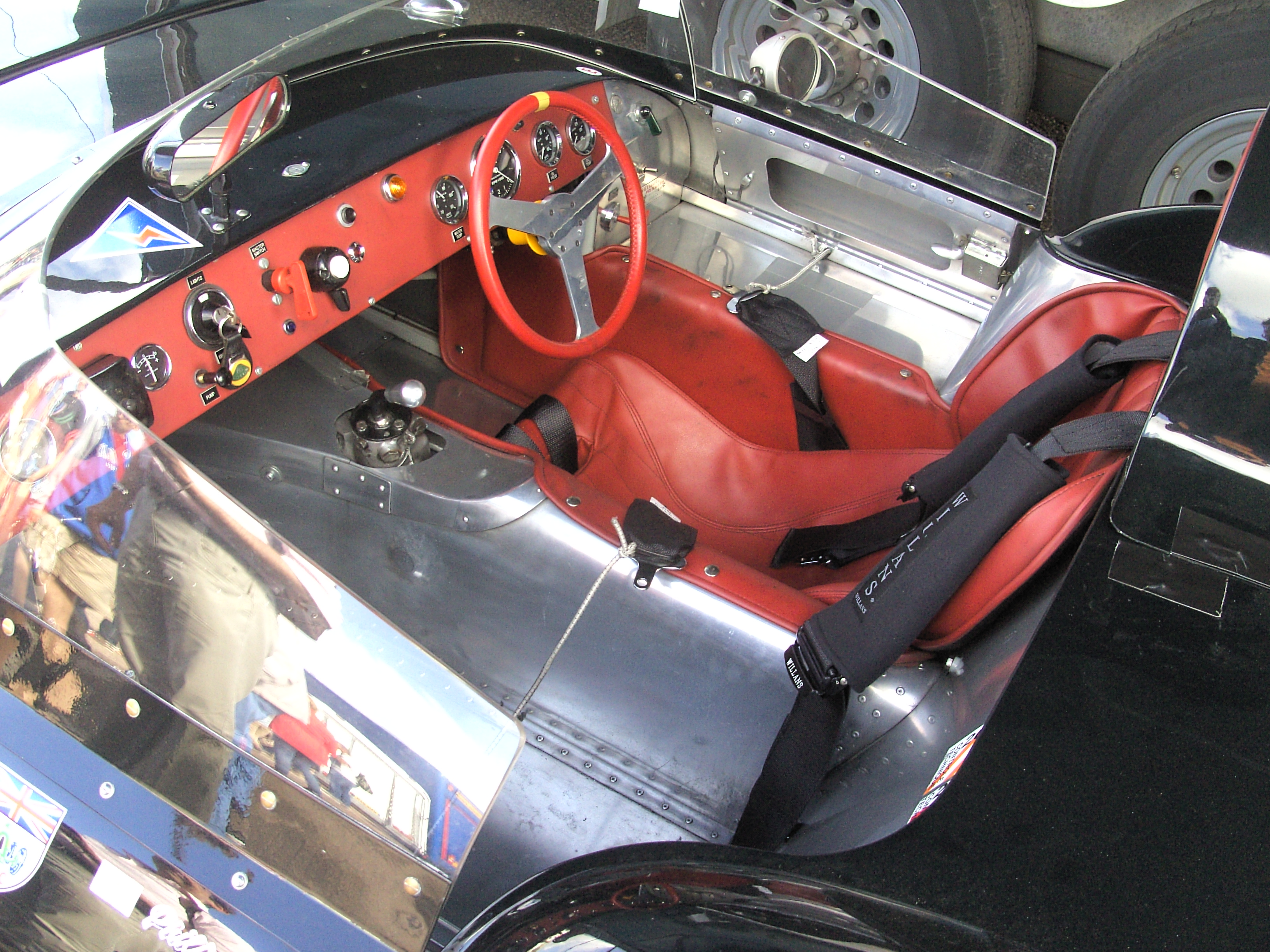

Hi Pluscat, what makes you think the rear is Series one ? Looks like series 2 to me, series one wings are much narrower. also the interior shot shows the series two rounded shape on the elbow panel, series one have a sharp fold with a cut recessed for elbow on the drivers side. it may be a replica, who really knows these days? its not the prettiest body by a long way. but its being used as intended! raced.

Pretty sure that this lotus is run by a guy called Philip walker. I had a good look at this car when it was racing at donington back in 2008/9 ish. I took loads of reference shots, especially under-bonnet which helped out when building mine, i did notice a lot of areas that had been done differently on this to other elevens that i had pictures of.... Body wise it actually looks quite nice in the flesh, there are far worse out there, and from what i remember it was a pretty quick car. It did have lotus chassis plate on it, so i guess its a real one- because as we all know that means its original.....
But what is that silencer arrangement! I can only think it is like that for noise limitation?

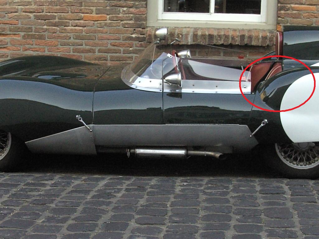

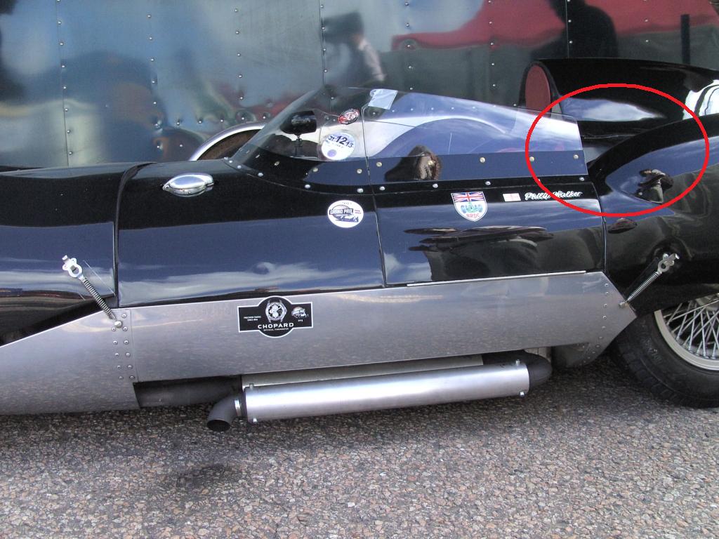

It is the Phlip Walker car, and it does have a dubble silencer. The rear looks like a series 1 because it has the low wings. Series 2 car had higher rear wings. Compare the pictures. The second car is a Westfied (which is modeled after the series 2) with the high rear wings.

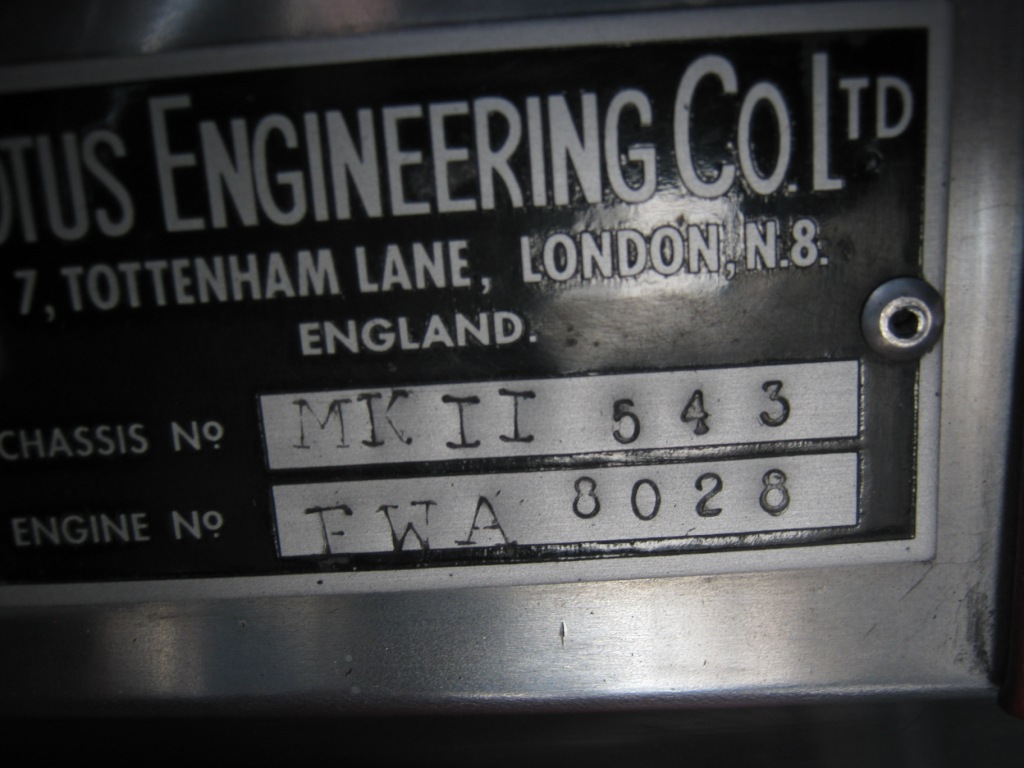

I thnk the car is not a genuine Lotus XI, this is the chassis plate, and XI numbers don't go in to the 500's, I believe
