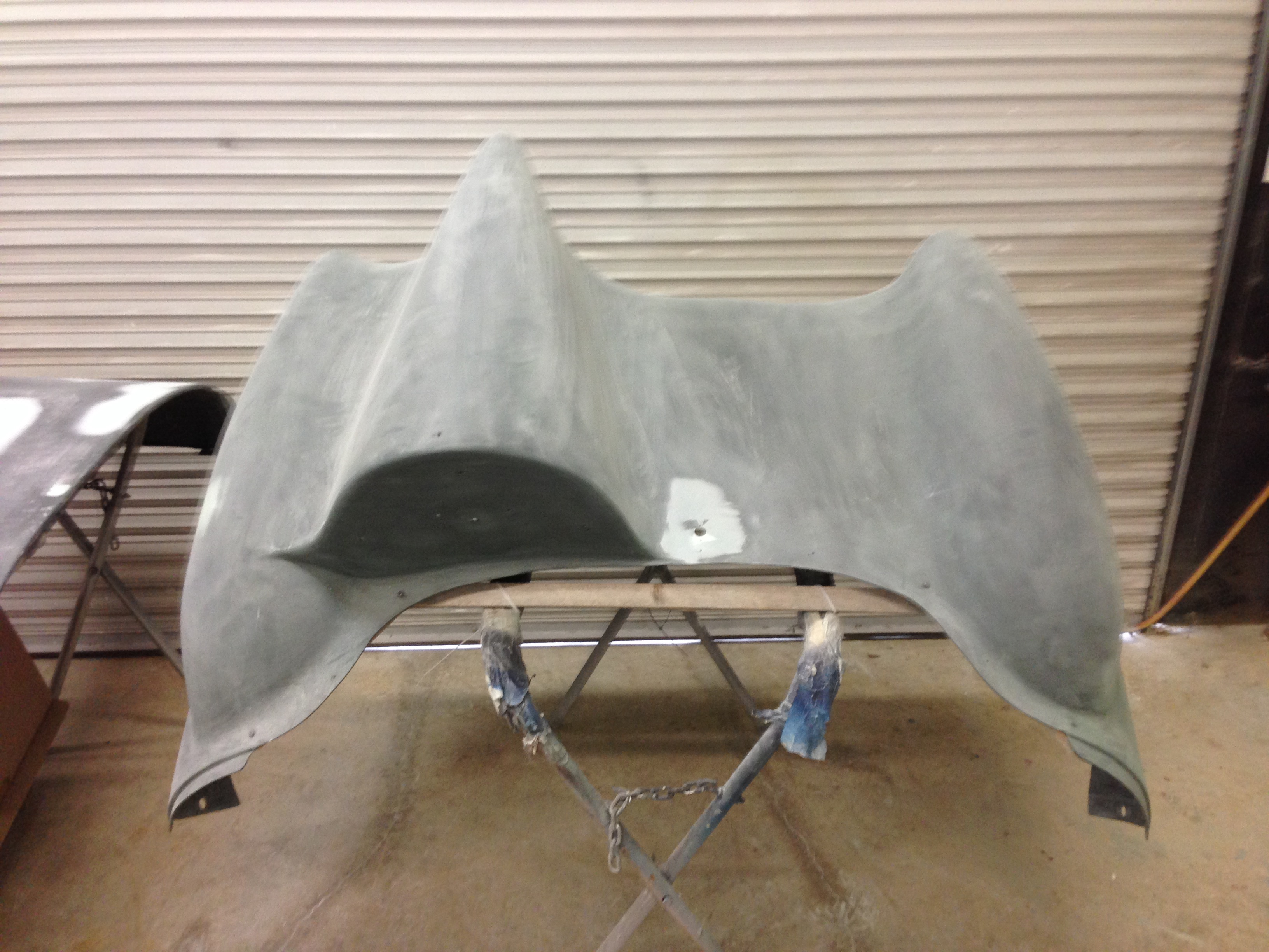

The improvements and repairs on my Eleven are progressing nicely: (PIctures attached)

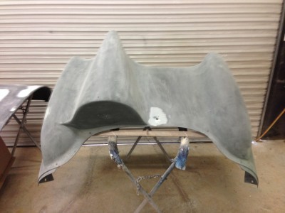

Body is off and the doors had their first sanding, fairing and primer. This sequence will be done twice before painting. The rear bodywork and scuttle has been repaired and sanded. 1st coat of fairing primer is next. We sourced a small scoop to cover the hole that was cut into it with electrical tape put over it over to clear the fuel injection throttle body.
The seats, dash, headrest are in for re-upholstery. Once out of the car and inspected....well, let's just leave it that it won't be hard to improve on the existing workmanship of the initial installer.
The fiberglass bulkhead behind the seats and all of the plastic wheel well liners are being remade in aluminum. I should be able post some photos of those within the next 10 days.

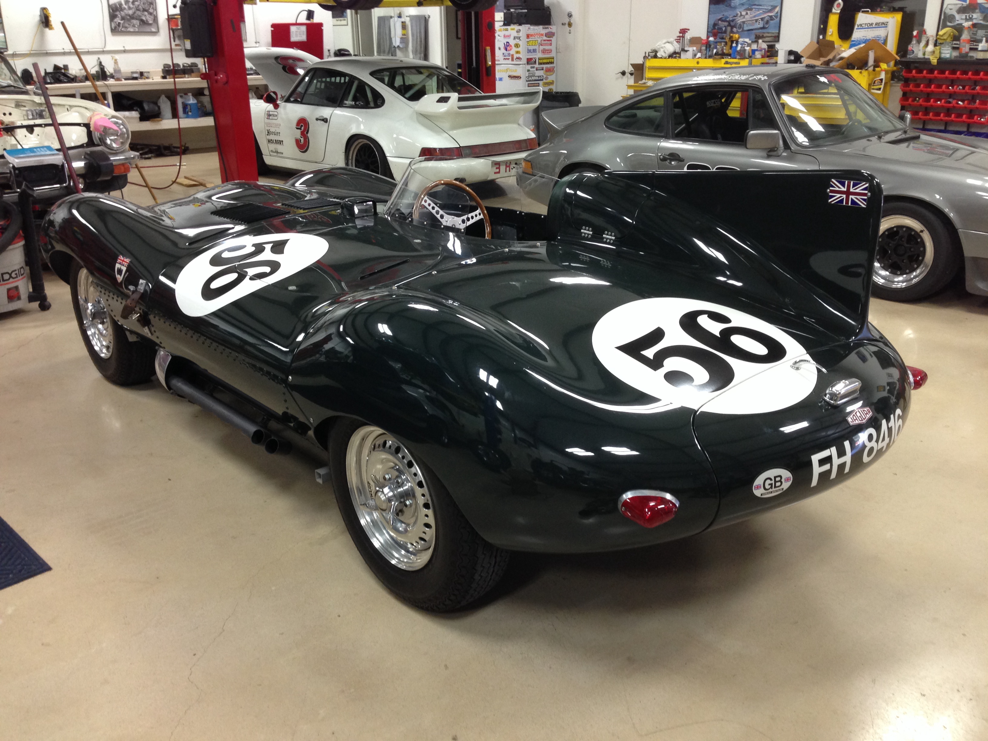

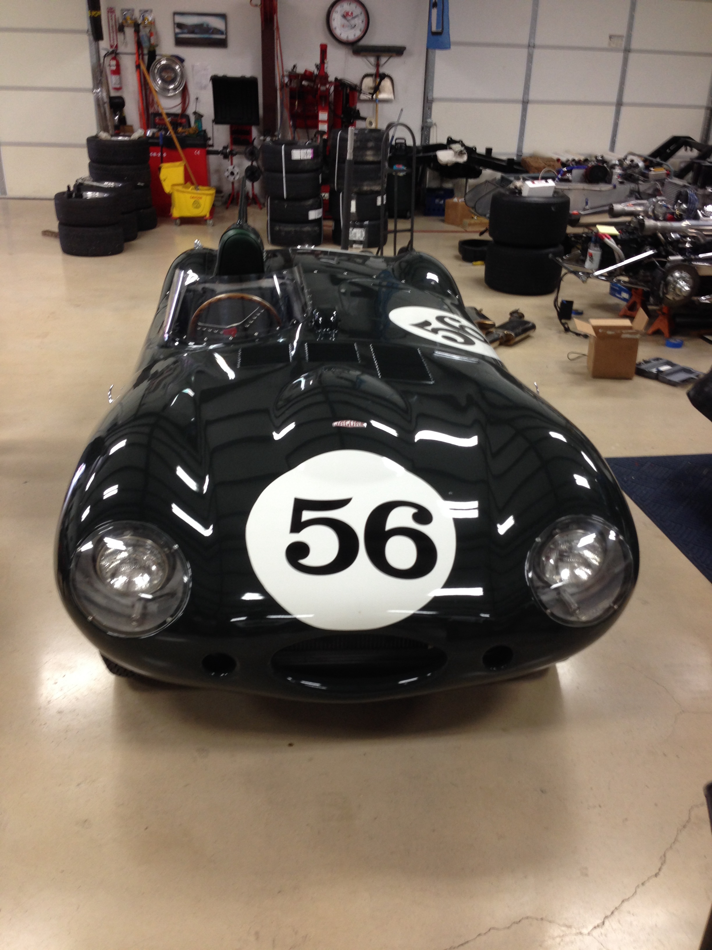

For your viewing pleasure, I have also put up a few photos of a Jaguar D type that came into the shop since I delivered the Eleven to them. If you look behind the Jag, you can also see my maroon Lola T70 on a lift. We are doing a suspension mod in the front and changing gear ratios out back.

D-type w/Lola behind
D-Type 2
D-Type 2
D-Type Eye Candy
D-Type Eye Candy

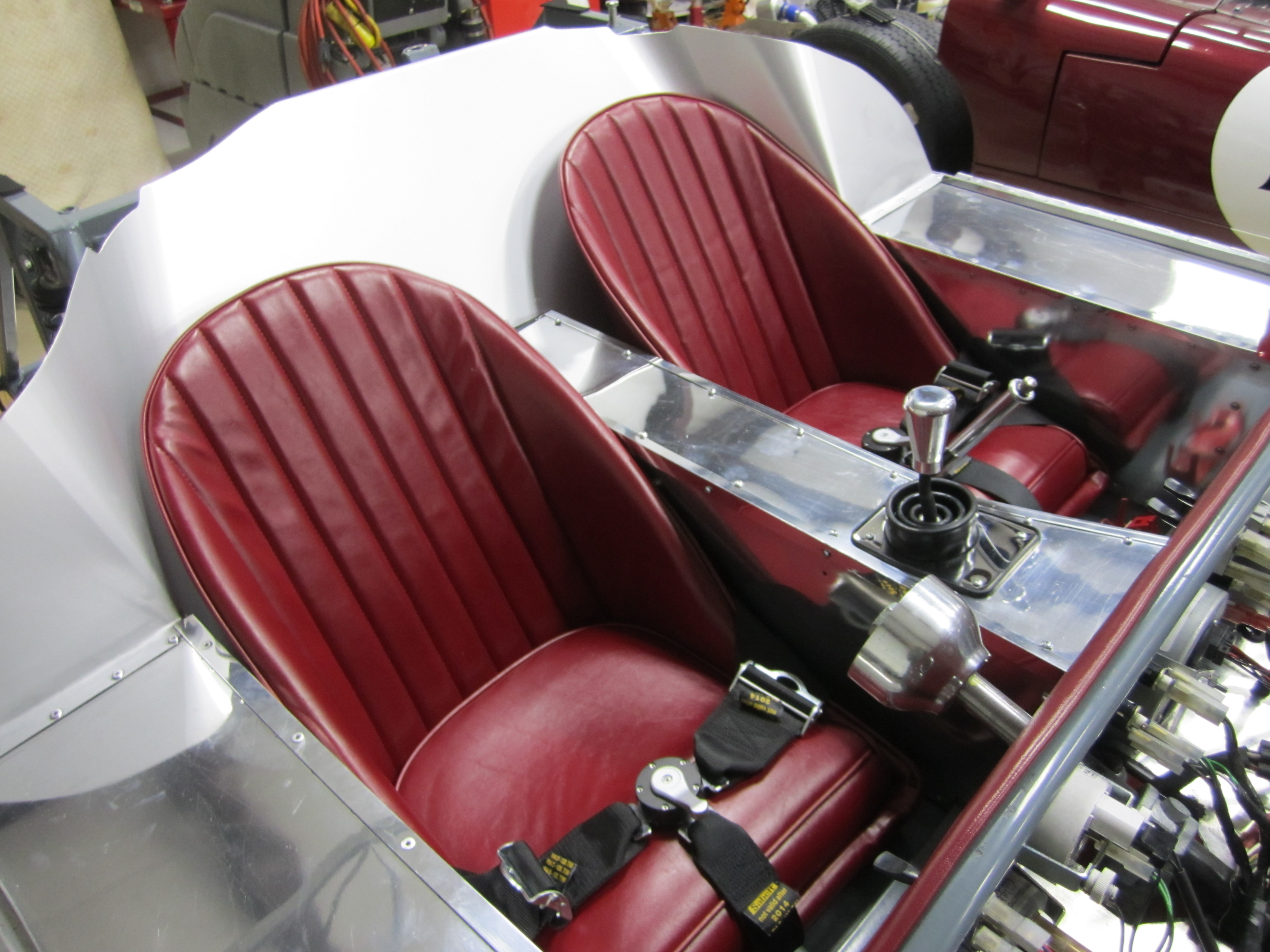

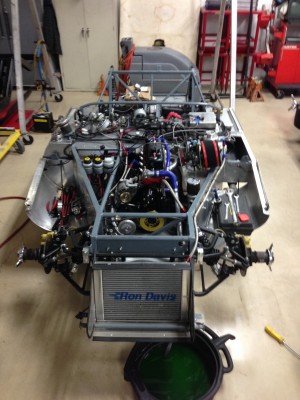

Progress Update:

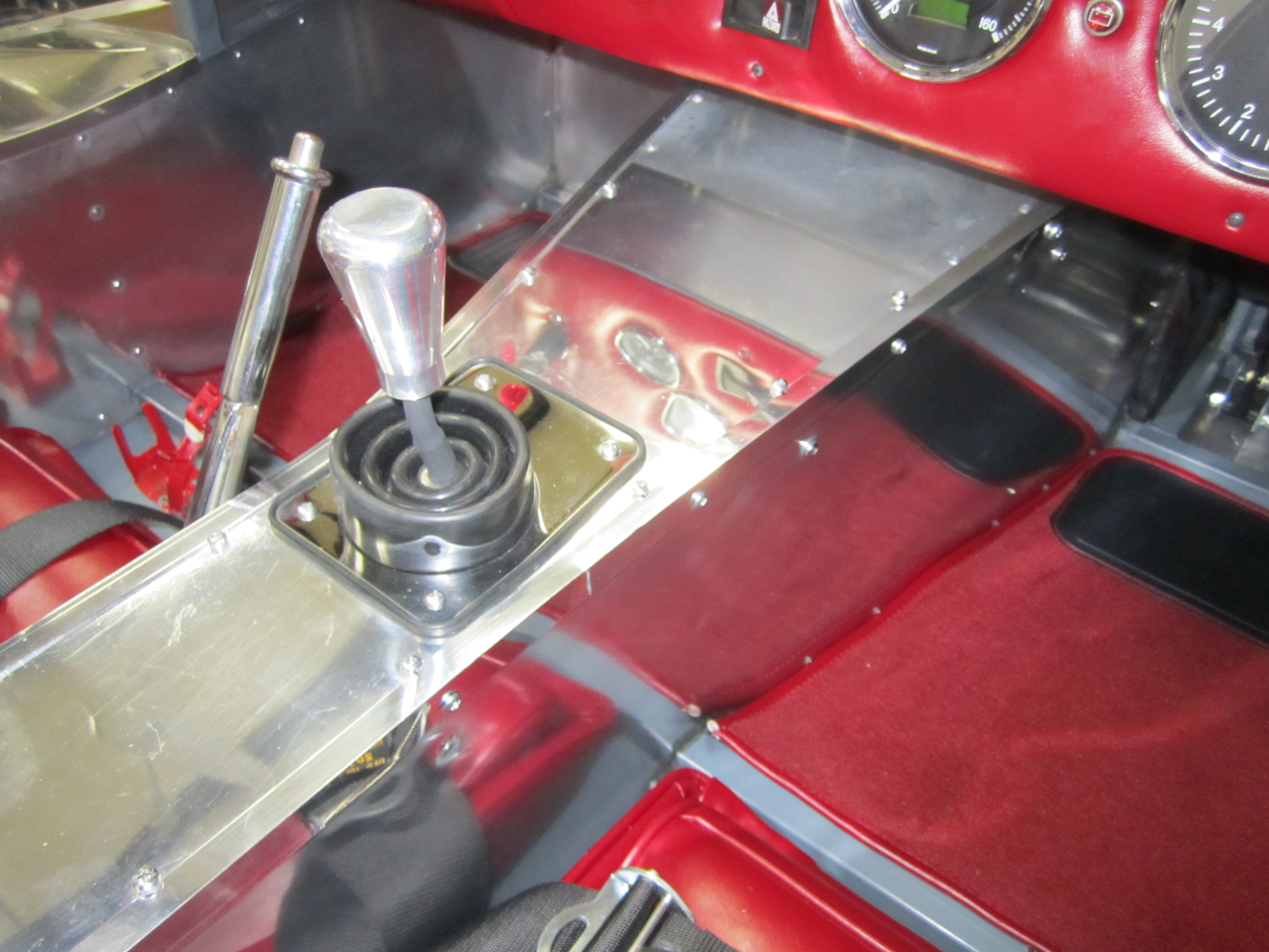

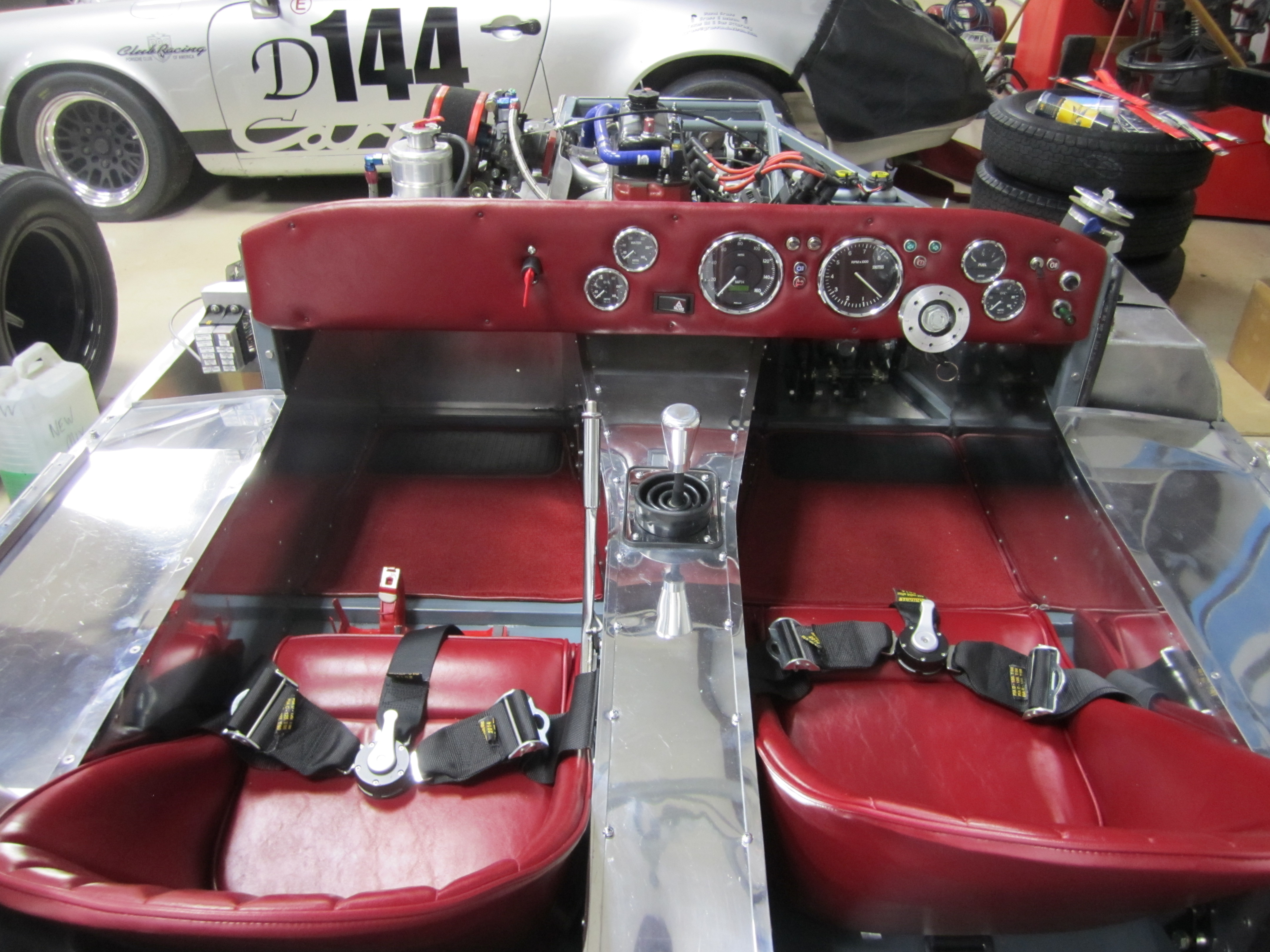

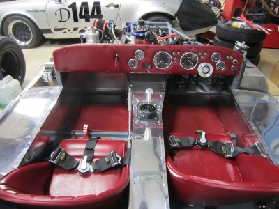

The interior has been completely polished and seats and dash are reupholstered.
New removable floor mats were made to protect the polished panels.
Fabricated, polished and installed aluminum edge trim.
Installed new aluminum back panel to replace tattered carpet.

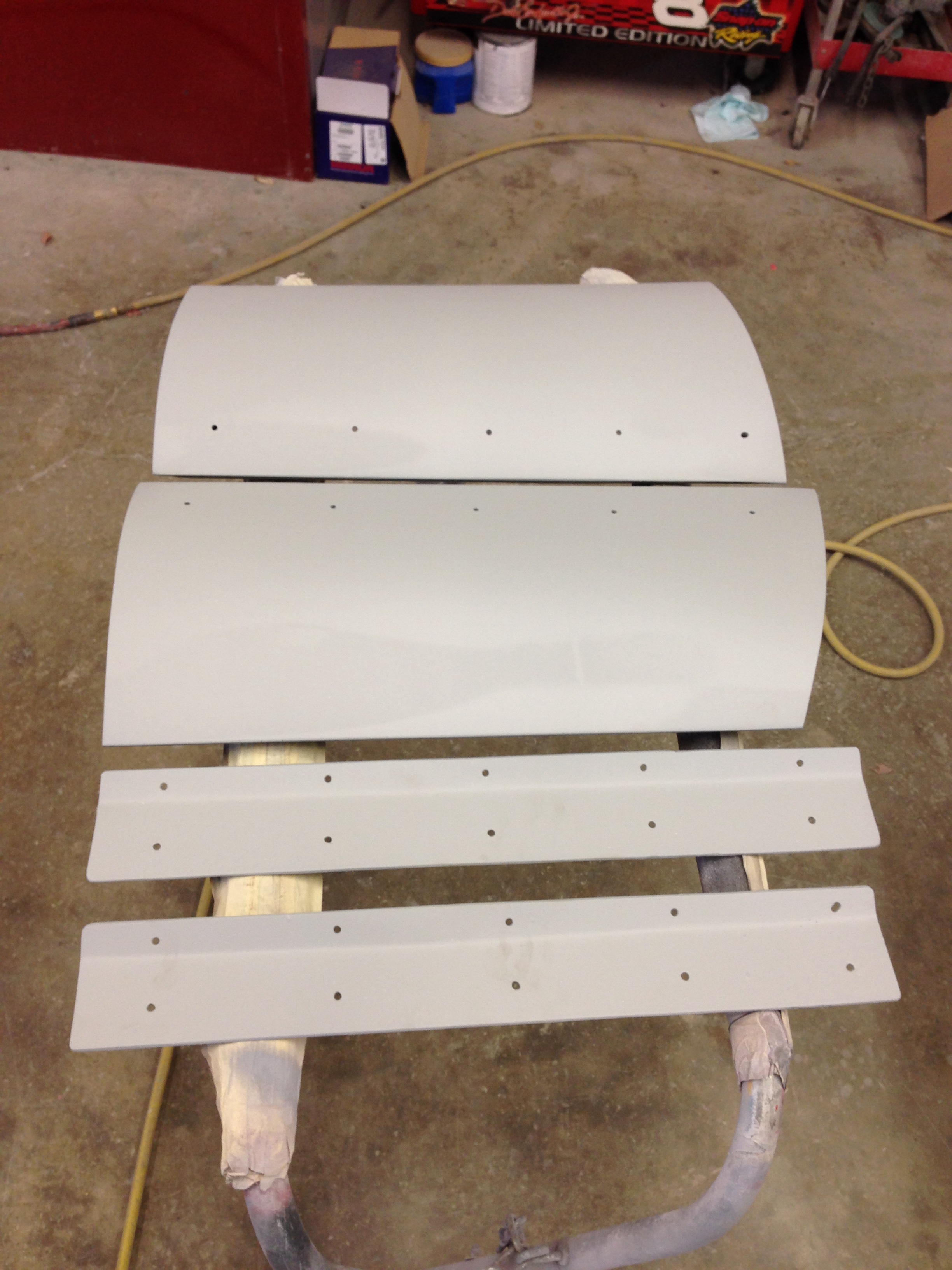

Body is repaired, faired, block-sanded by hand twice between primer coats, and ready for paint. Hopefully, temperatures will rise enough in Texas to take that on next week.
Received a new complete chassis bushing set by DHL yesterday from Westfield in UK. They now have them back in stock. Fabricated our own bushing spacers for upper A arms to eliminate deformation of brackets
All coolant and oil leaks have been addressed and new fluids in place.
Wire Wheels are tightened, trued and balanced with new Dunlops aboard.
Exhaust system and muffler is out for new ceramic coating.
New throttle return spring system installed to alleviate hypersensitive throttle on motorcycle fuel injection
Installed clutch pedal stop
New wheel wells fabricated from aluminum are complete and ready for installation.
Single cockpit body work on order from Westfield
Pictures of interior attached....should be done by Christmas.
Glenn
Re: Magnificent W11 Sold In US
'Love the alloy rear bulkhead. I am thinking of doing that on my own car. I have just stripped out the 30 year old carpet and I am contemplating my next move. Polish, or some diamond stitched upholstery on the tunnel... I just cut a new dash panel as well. You are an inspiration...
Your car is looking good.
