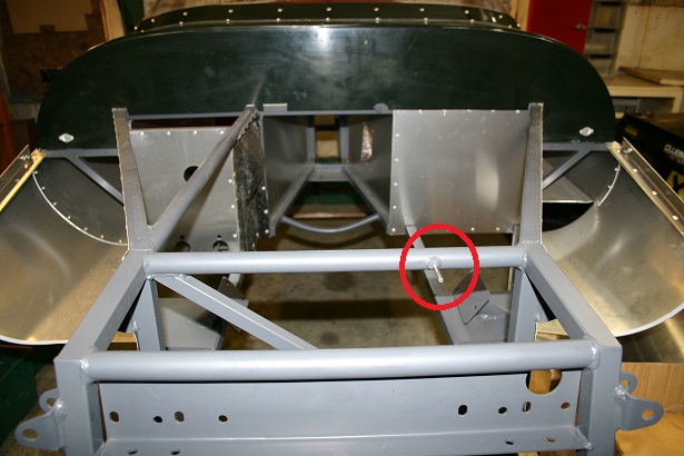

I have started to install the brake pipes today and set about working out which one goes where. The only one left is the main front pipe but it doesn't appear to be long enough. I believe the problem maybe that the front chassis Tee Union mounting screw has been fitted on the wrong side (possibly for a left hand drive car) as if it were on the Off side rather than the Near Side as can be seen in the picture it would work. Any advice would be greatly appreciated.

Si,
Sorry to be the bearer of bad news...
Mine is on the offside.

Yep reality is sinking in that it's definitely on the wrong side but unless you guys tell me otherwise the easiest fix is for Westfields to make me up a slightly longer pipe?

Yep - that'll be what I would do. Can't see how the positioning of that Tee would change the price of fish. Does your other pipe need shortening, then Si?
I assume you'll have access to a good flaring tool - shouldn't be too much hassle to sort out.

Seems like the easiest way to me. Luckily no shortening should be required as I can swap the N/S pipe for the O/S pipe (yankee style!!!!!)

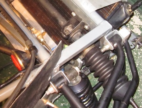

Re: Brake pipe fitting help please
No bad news at all.
Here is a picture. More are in the album on my site. If you need more detail about the brake lines, let me know. I have plenty of pictures. If you check out the album, you will find numerous pictures of the brake line runs.
http://groups.yahoo.com/neo/groups/West ... tOrder=asc
The union is on the off side. You need to run the brake lines on the near side, through the tunnel. The lines are plenty long.
