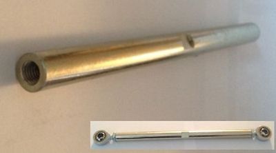

Making the lower mount turnbuckle is pretty easy, and requires a pair of inexpensive rod ends in LH and RH threads. Use hex material for the connecting tube and it becomes very easy to adjust the tension with fingers, or with a 1/2" spanner, and a couple of jam nuts. I will try to get some pictures of the entire installation with the lower turnbuckle bracket.

"Making the lower mount turnbuckle is pretty easy, and requires a pair of inexpensive rod ends in LH and RH threads. Use hex material for the connecting tube and it becomes very easy to adjust the tension with fingers, or with a 1/2" spanner, and a couple of jam nuts. I will try to get some pictures of the entire installation with the lower turnbuckle bracket. "
Do you have any dims/specs for the rod ends and length of stock, please Jan?
Once I have these, I'll find the UK suppliers parts numbers/stock suppliers, tap details and post info here. It'll be useful if anyone wants to mod their cars with the leggera alternator version.
BTW, I take it that the standard single-groove pulley that comes with the chinese Denso copy works without modification.
ETA: McGill Motorsport supply everything we'd need in a kit - including turnbuckles etc

Longer lengths are in darker carbon steel and will need painting or coating.

The hex stock I am using is only 2.5" long, plus the thickness of the thin jam nuts (You can order longer bar hex stock and send it to your friends once you work out the measurements, and have the stock drilled and tapped), drilled and tapped to fit the LH and RH thread rod ends. This part will have to be cut to fit, depending on the rod end threaded area. Pick the stock to match your rod end's requirements. All thread sizes are bored to fractional. I only like to carry one set of tools to the car...
I am using the forklift type, small alternator listed as a replacement for ND 18504.
Rod end size will match the fasteners.
Thread the lower mount of the small alternator to eliminate the nut, and align everything with washers. The original stand off mount for the original alternator/generator works fine or you can use a stack of washers.
My setup uses the standard lower mount point for the generator/alternator, attached to the engine's motor mount plate.
Any angle on the lower mount rod is of no consequence. It will be angled somewhat when mounted, but this is handled by the rod ends.
The standard V belt pulley supplied with the alternator works fine. You may find that some of the suppliers of BMC A competition parts may have other "under drive" pulley sets. If you decide to use one of those, it may require additional change to the alternator case mount tab.

3/8" Fine thread. The rod ends will be 3/8" as well with thin jam nuts.
Use 9/16 hex stock for the lower mount. That way, you only need a single wrench to adjust the belt tension.
