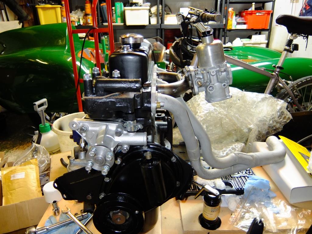

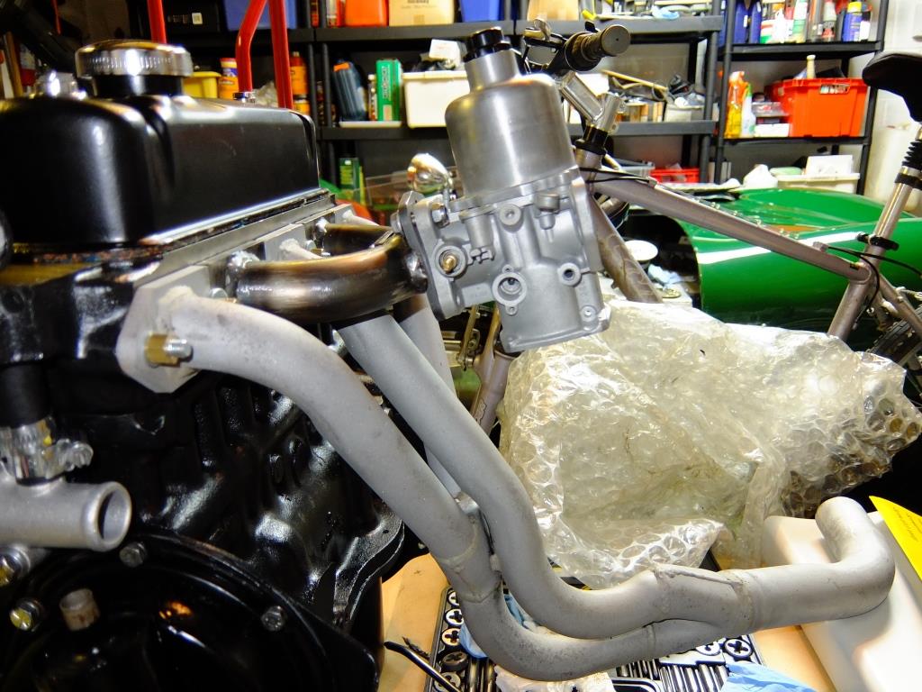

Here you go - sorry about the delay.
The Maniflow manifold is standard midget. It is angled where the carb meets the manifold, but pretty straight from the head.
Use exhaust wrap to stop vapourisation, and there is scope to angle the carb to at least level.
Charles' assessment was spot on. The dashpot cover is around 1/2" higher than the filler cap, so will, sadly, either require a hole, or a revised manifold.
HTH
