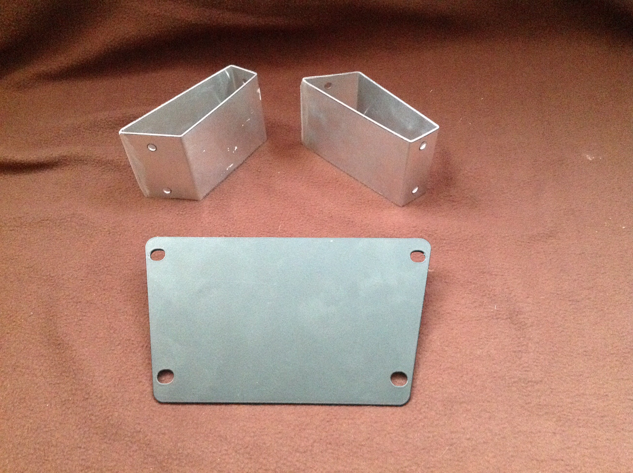

Hi All,
Have been unpacking my kit and trying to understand how the gearbox X member is fitted.
All I seem to have is a 8"x4" plate with angled sides and drilled with 4 holes that match holes drilled in chassis. Do you drill this plate once the gearbox is fitted to suit the modified midget X member?
I have looked but can't find any photo online that shows the gearbox mount fitted to the chassis.

[attachment=0]image.jpg[/attachment]
Photo of steel plate X-member drilled for chassis only and two as yet unidentified alloy brackets from latest XI kit of parts.
Would like to see a photo of the plate X-member installed in chassis with gearbox mounting attached if possible.
Daggers
Daggers
- Posts: 462
Re: Gearbox X member
Over the past few years I've disassembled and rebuilt every inch of my 2006 car and I haven't a clue as to what they are. And, sorry but mine too has a T9 'box. Congratulations, good luck, enjoy the build and keep us informed. And I don't know where you are but you're more than welcome to paw over mine in Andover if you need inspiration at any time (see the "photos" thread, currently on page two of "induction noise", I think).

The two box shaped parts look like motor mounts. They might be listed on your parts inventory sheet.
The flat plate is the mount plate for the ribcase transmission. You don't fit it unless you need it to hold the transmission into the chassis.
Remember, this is a "kit car" and not everything is done for you. You may have to drill the odd hole or two to get things to fit properly.
I built one of the first new production cars around '06 for the distributor here in the US, and I have found that there have been small changes along the way with subsequent late chassis I have worked on. Among the changes was to a "universal" chassis that would accept both the Type 9 and the ribcase, using the welded in plate for the longer T9, and the bolt in plate for the ribcase, Datsun 210 5 speed or Toyota 5 speed.
There are weldments fitted to the chassis to bolt on the mount plate. I suggest using larger bolts, and threading the chassis fittings to eliminate some extra fasteners, and the need to reach down the tunnel to tighten up the bolts. I also recommend threading the steering column mounts in the chassis at the panel as well. Much easier assembly... Fewer fasteners to deal with.

I still haven't worked out what the alloy box pieces are as they didnt seem strong enough for engine mounts. I have the midget box and used that plate to mount my gearbox using the original MG mount slightly modified. It was a fiddly job but now it's in it works a treat.
