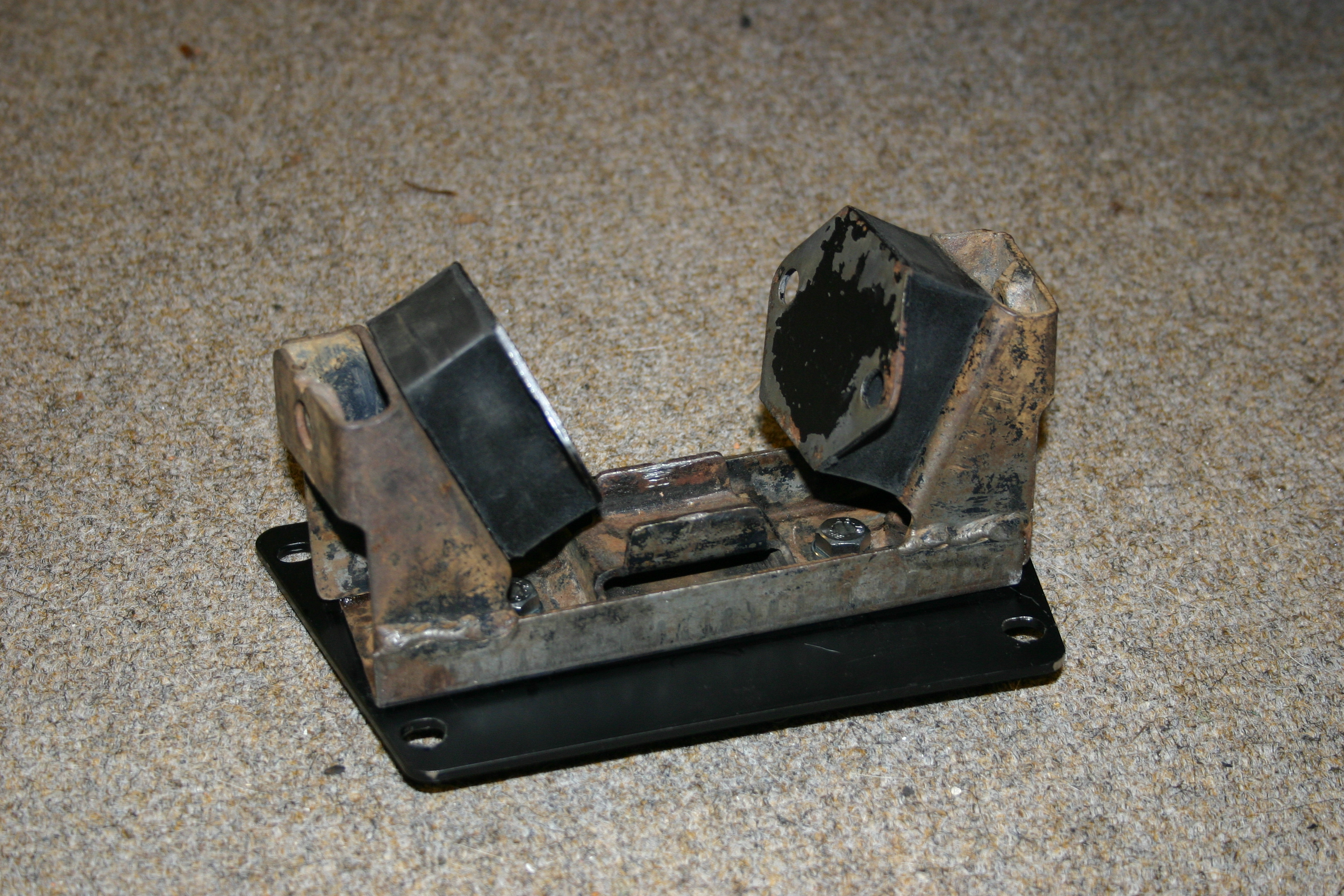

Hi Daggers
I have found a picture of the gearbox mount on the plate just prior to painting and then installing it. I fitted it after installing the engine and box as found it was easier to lift the back of the engine then bolt the plate with the mount already fitted to the chassis then lower the gearbox down and bolt it all up. It was fiddly very painful and helps if you have child sized hands and I did lots of measuring and card templates to get it just right but it does what it needs too once in place.

Re: Gearbox X member
How about fitting the mount to the transmission, lifting it into position, then affix some two sided foam tape to the mount and press the plate into position?
This will give a positive indication of where the mount will be sitting on the trans mount plate. Once the transmission is lowered, you can scribe the mount position on the plate, remove the tape and drill... This should take about 15 minutes (maybe less), and greatly reduce the time needed to make templates, and eliminate the need for small hands, as the plate can be fitted prior to lifting the trans into position as you describe. The trick will be bolting in the plate, but if you drill and tap the welded fittings, you can use larger bolts, and no nuts, making the whole installation from beneath, with an air wrench. Lock washers or flat washers and safety wire can ensure tightness.
I would also suggest an alternative of welding the nuts to the chassis, but tapping the welded plate mounts is actually a bit easier, and requires no repainting. Also, it is easier to check for mount tightness when doing the annual checks.
I would tap for fractional bolts, so that all of the major chassis bolts are fractional in size, eliminating the need to carry two sets of wrenches to the car when building. I pretty much eliminated the metrics from the chassis/drive train installation. Much easier to work on the car that way. While I love metric fasteners, and have a full duplicate tool set for metric fasteners, I prefer to work on a single car with a single set of tools. Much easier clean up at the end of the build day... Also, I can use aircraft grade AN hardware, which is far superior hardware, especially for the suspension components.

Si,
Thanks for photo, will try the Assy method suggested by Jan and see what happens, this will not happen for a few weeks as engine is not here yet.
