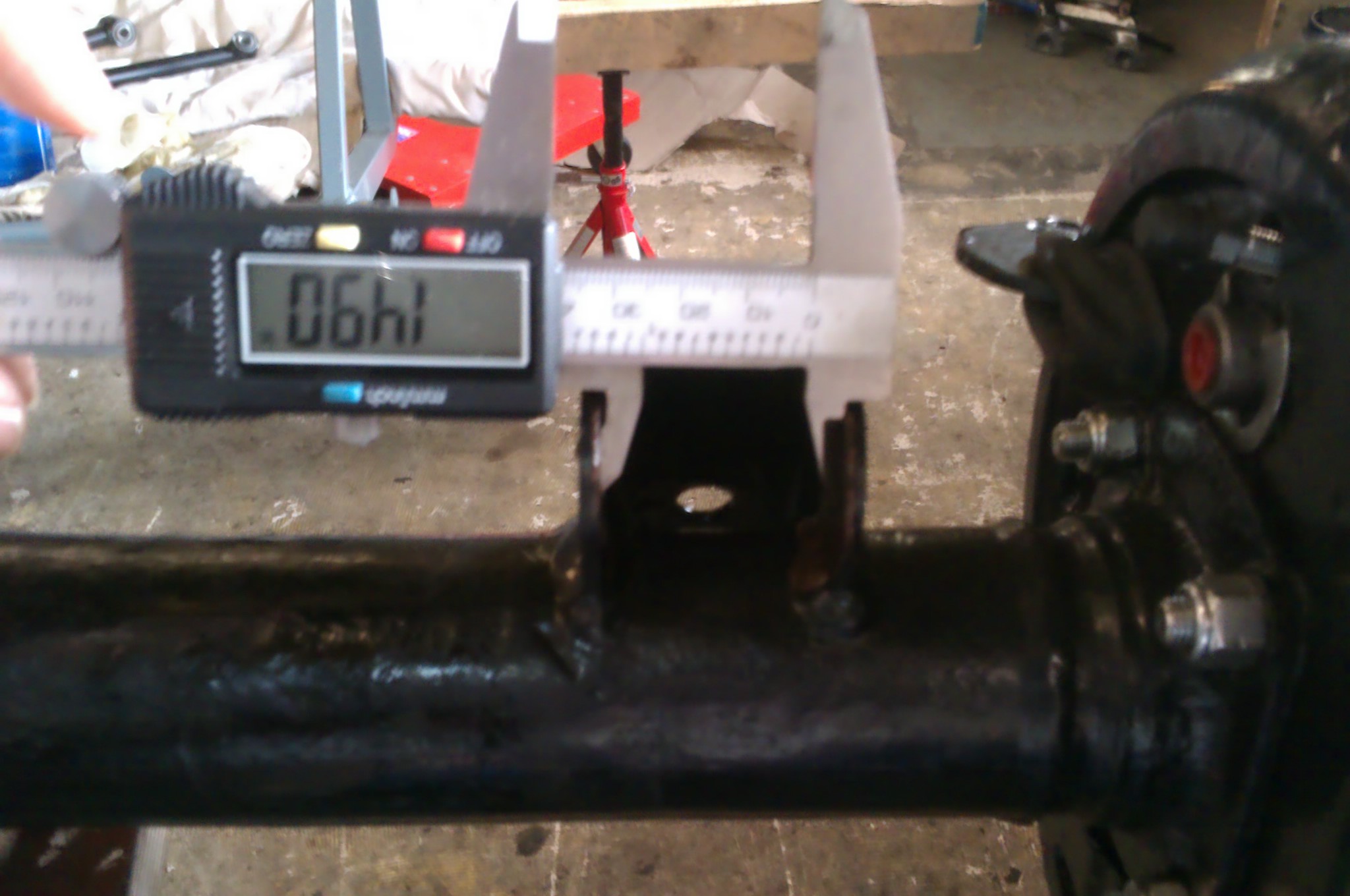

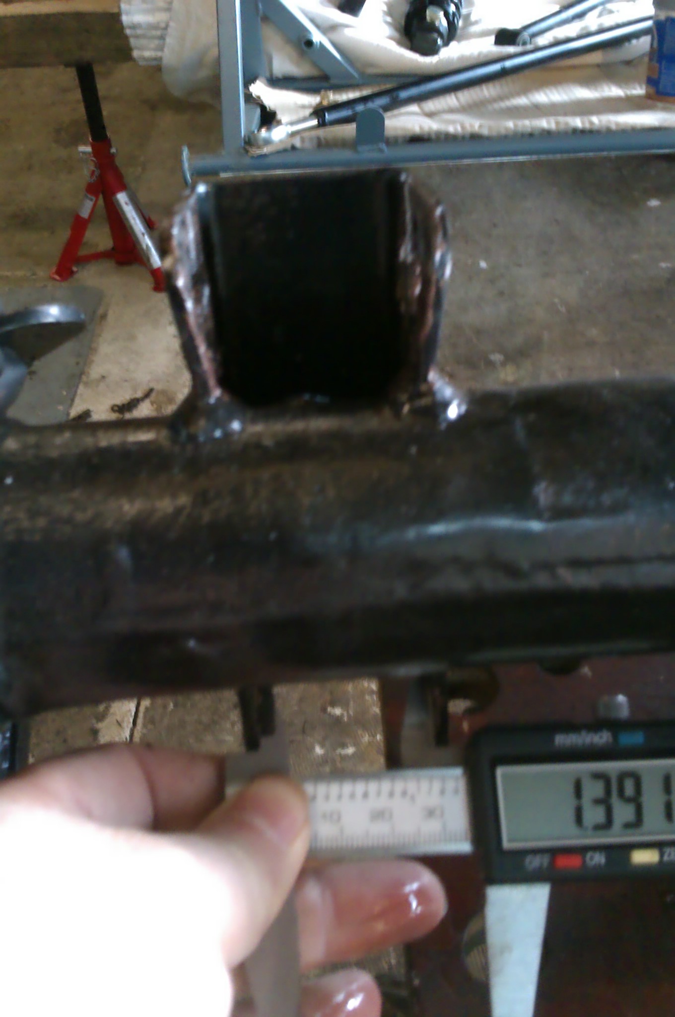

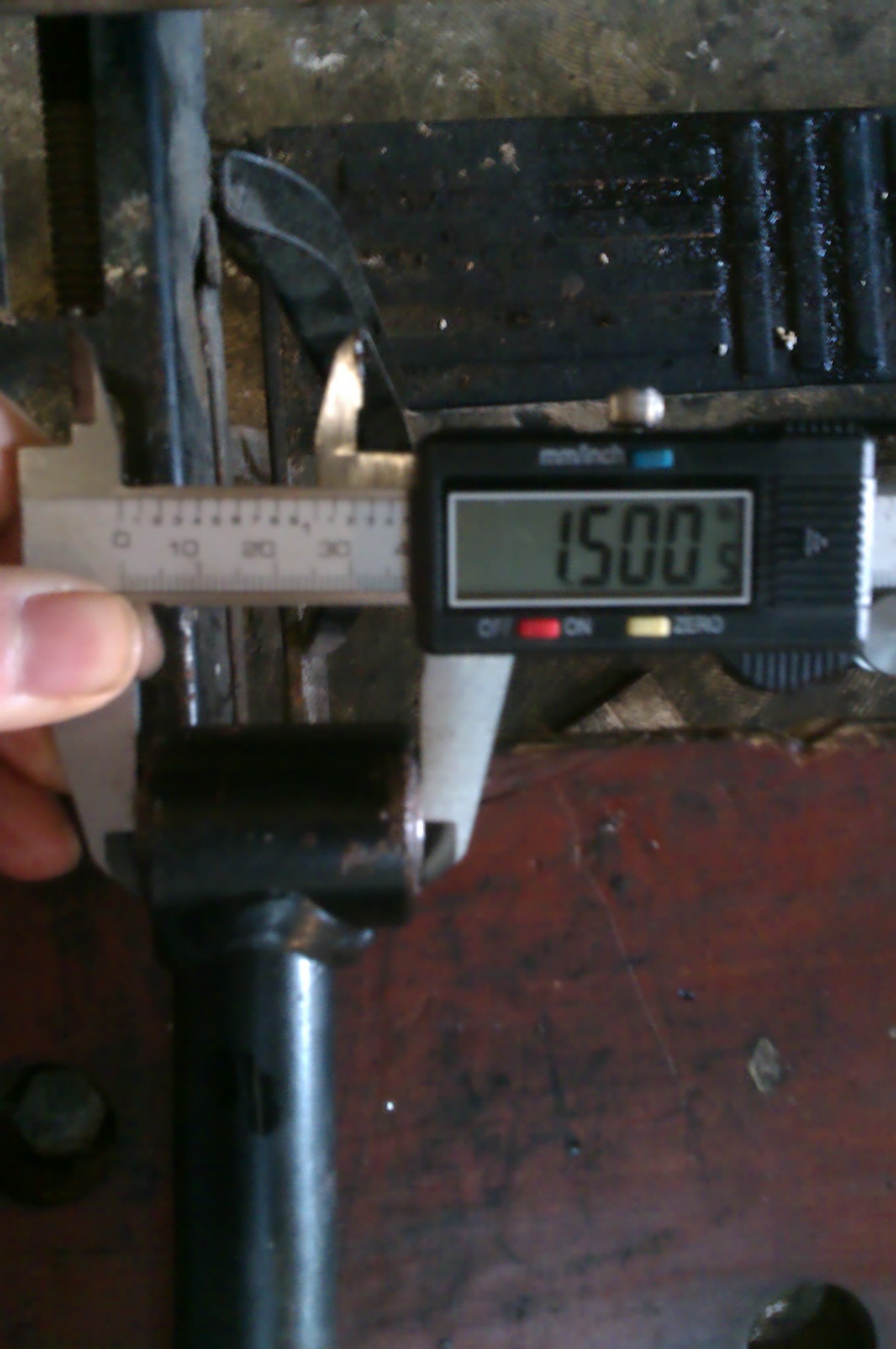

I have just started to build my XI and was planning to put the rear axle in first. I have run into a problem straight off with the brackets on the axle casing ( the ones westfield have put on ) that take the traing arms/panhard/shocks. The metal tubes in the rubber bushes in the trailing arms are 1.5inch long and the bracket on one side is only 1.4inch (panhard rod side) and the other slightly larger so the bushes won't fit. I can just get the bush in on one side with a hammer but there is no chance on the other side. Any clues as to what I am doing wrong or suggestions on what next? ( i dont fancy grinding down the bracket or the bush sleeves but taking the bracket off and remaking is a bigger job than I fancy doing.

Thanks for looking. I have tried to add some pics to the original post but they are not the best. On the panhard rod side I did try to persuade the busy into the bracket to see if it would bend things to fit...  it didn't but it did mess up one side of the bracket by flaring it out which you can see on the pic.

For some reason, the brackets are pinched and welded on your car. Not the best work... But easily fixed.

The brackets measure between 1.45" and 1.46" with the bushes at a constant 1.5". I am initially reluctant to distort my nice shiny brackets, thinking of setting arms up on the milling machine and shaving inner sleeves.

Hello again thanks for the pictures.
The simple answer as you have had already, is to simply bend the bracket locally.
I do suggest that you inform Westfield of the problem so they can look into changing the way they do things, on future parts.

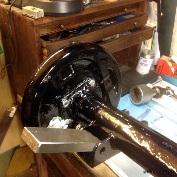

5inches of 1.5inch x 1inch M/s bar with radius on leading edge, to tap into bracket which should bend the two sides out at an angle but quite evenly, then with the bar still in place tap the sides back square this should get you most of the way.

I agree Malc it would make sense to make a wedge and distort the brackets locally, just goes against the grain. I'll make a wedge this morning and report back.
