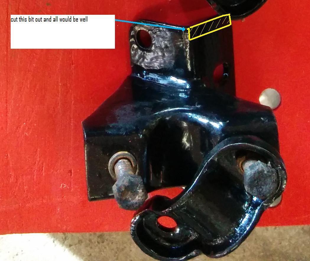

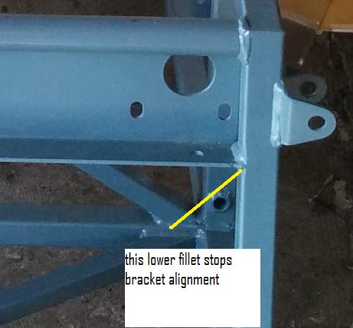

The left side steering rack bracket (the thin rack with bent steet bracket rather than the alloy bracket type) fits tight to the left hand of the chassis to align with pre-drilled mounting holes in the chassis. Or it should but the bracket fouls on the fillet of a chassis weld so the bracket either does line up or it doesn't sit flat. It is only about 1/4" out and I was planning to cut the bracket down.
It looks like this would happen on all the cars as the weld fillet looks normal so if the holes are in the correct place the bracket would never sit properly without a bit of fettling. have others had to mod the brackets?

Looking at your picture, I believe that the weld that is in the way should be beneath the steering mount plate, rather than inside.
Of course, you can grind the bracket to fit, rather than grind the chassis weld. There is plenty of meat on the bracket.

Thanks for the help. I am pretty convinced thatvthe brackets are the correct way around as the brackets are handed and the holes only get close to lining up one way around ( the pic i added actually shows the RH bracket so not the one I actually have to chop but it is the pic I have) .
The alteration to the brackets is easy enough it is just that the bracket would always have to be altered on every car as the weld looks to be in a place where it has to welded and the brackets I assume are all the same (thin rack ones anyway) so if mine is the only one that need adjustment it seems like the holes in the chassis are in an unususal place and that might create further "opportunities" for me later on in the build that might be best sorted early
