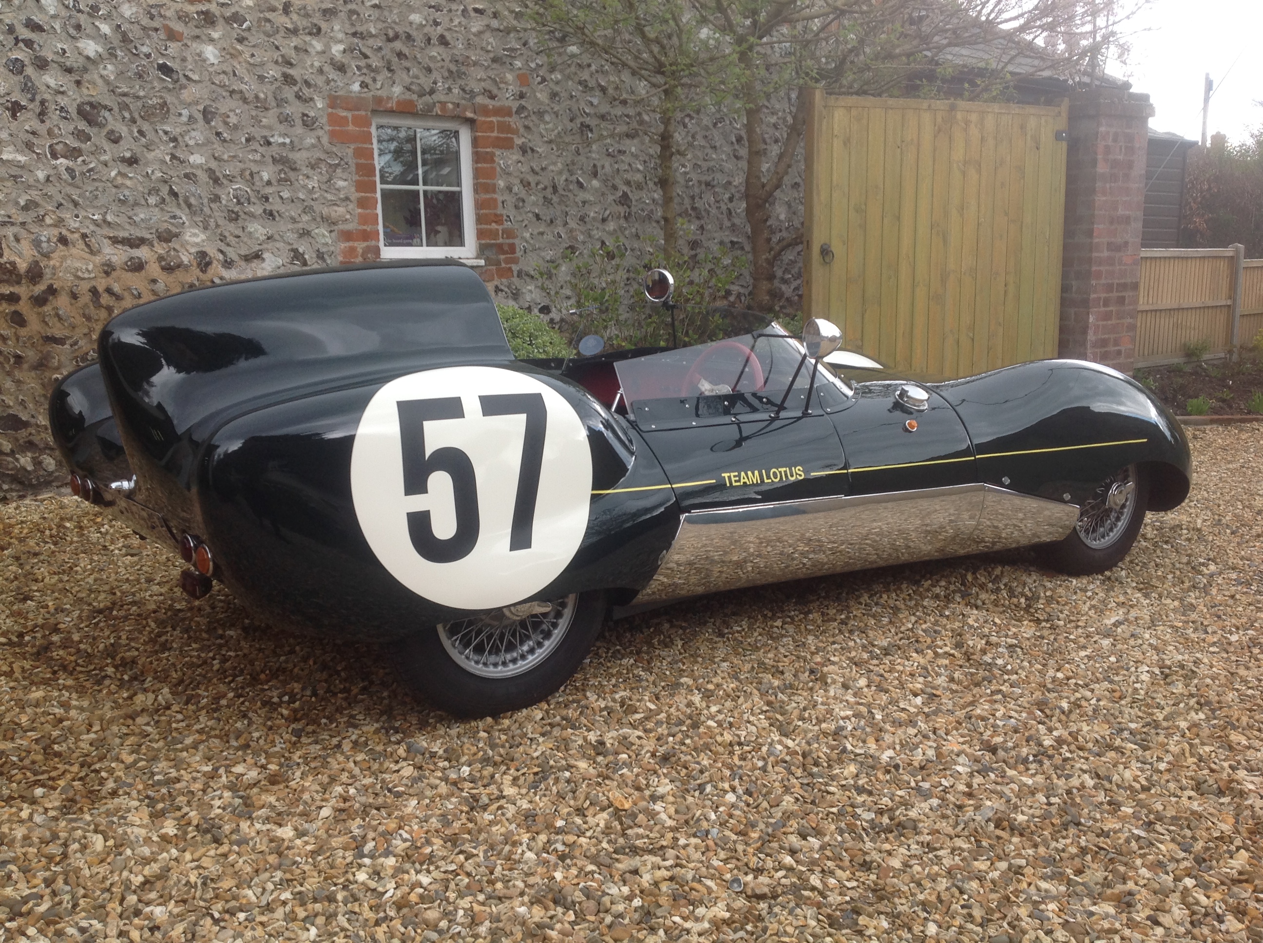

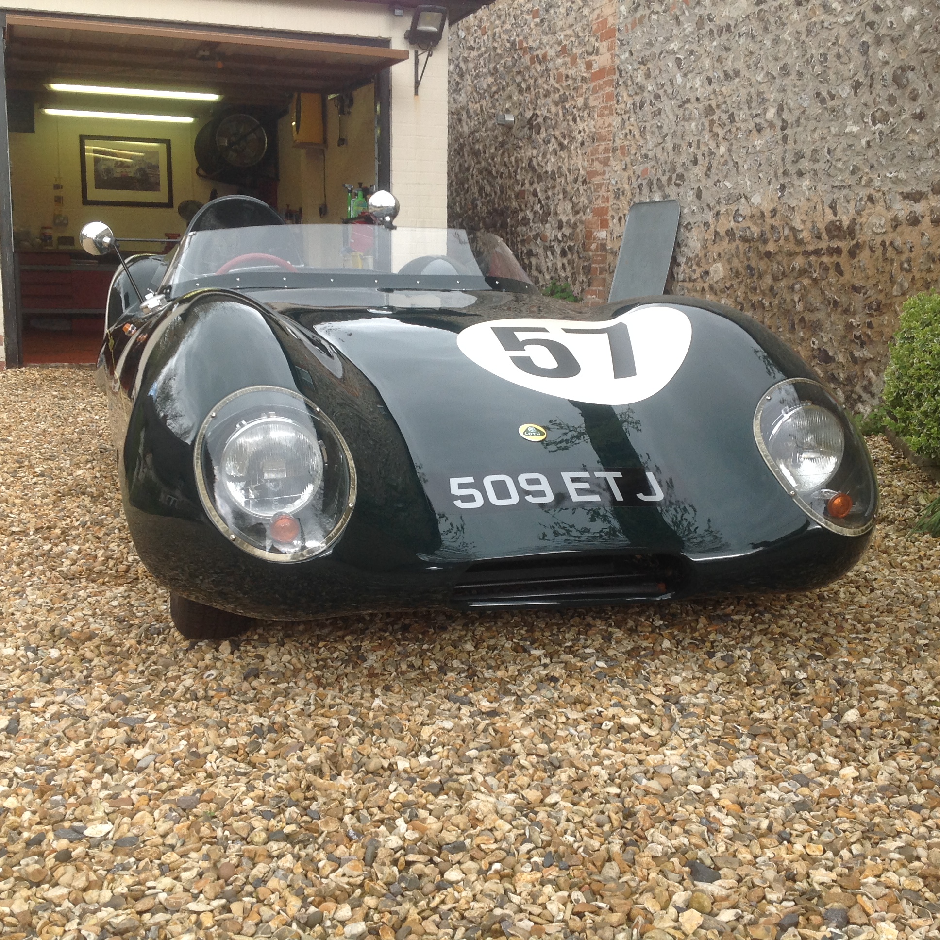

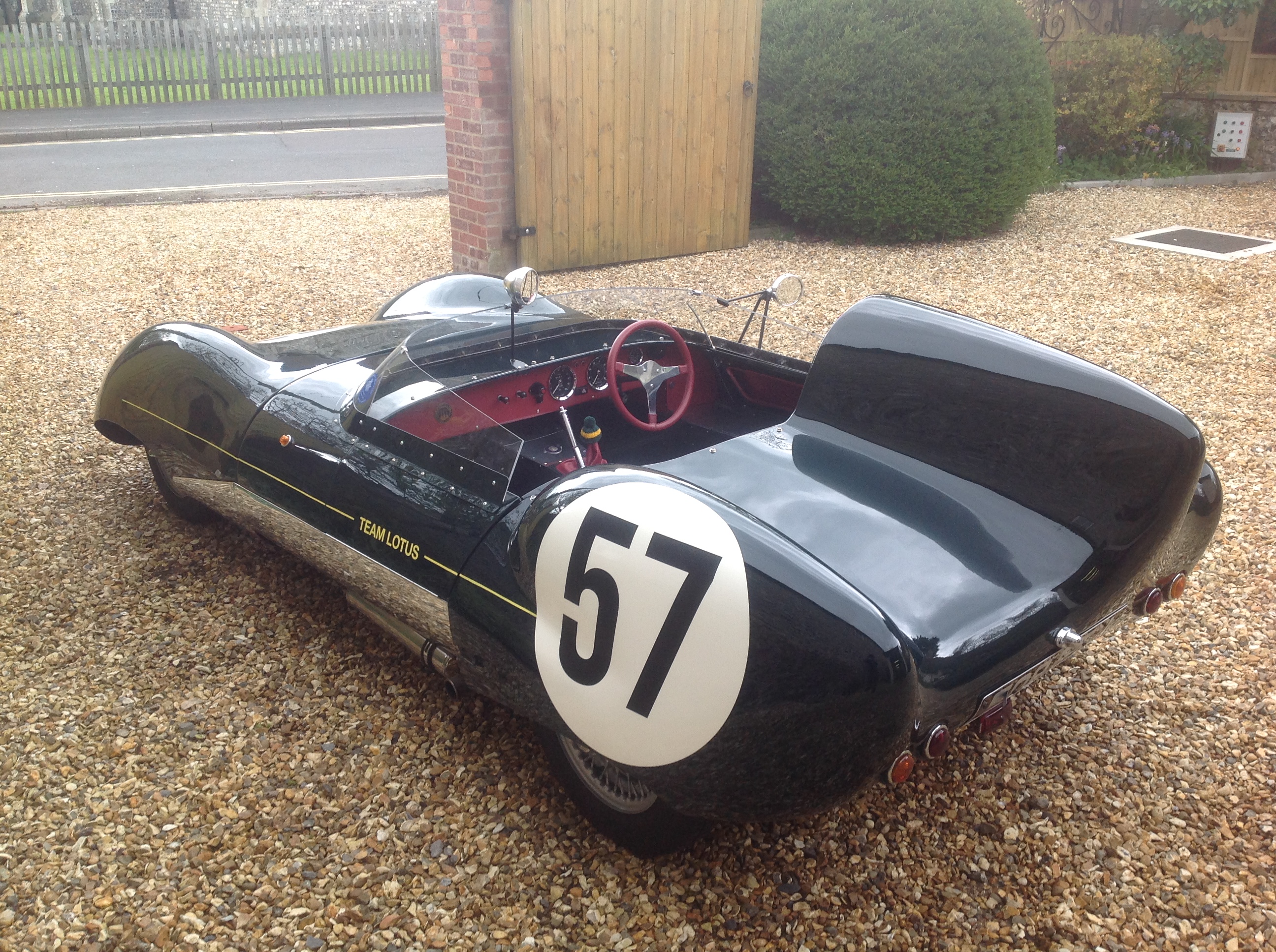

So finally, the end result:
[attachment=1]image.jpeg[/attachment]
[attachment=0]image.jpeg[/attachment]
And a question for you all. I thought that the fourth roundel, on the rear deck, might be too much. But now I'm not so sure. Should I or shouldn't I?
