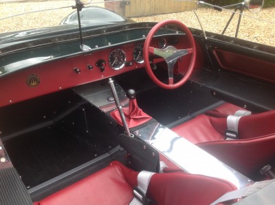

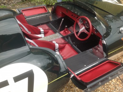

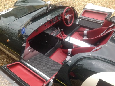

The only thing that I had to farm out was the gear lever gaiter, which was turned around in 24 hours by a local upholsterer. Hard, metal lined trim covers the carefully re-profiled lip of the bulkhead to prevent the fibreglass from chaffing through the vinyl. I hope that you like it.....
- Posts: 461
Re: Polishing my tiny............car!
(You might have also noted that I polished the outer sills whilst I was about it!)

'Looks lovely.
I have been doing the same to my car (inspired by others doing new interiors on their W11s) as the interior was very tired (being more than 30 years old) but I ran into a problem.
it is sunny here, and it gets hot. The polished alloy heats up while sitting in the sun, and it glares into the driver's eyes, usually when making left turns (into oncoming traffic here) and in the canyons. Also, the hot, exposed metal burns the elbows. 'Bad enough that the seat belt hardware gets too hot to handle. Now the rest of the car is like climbing into a hot frying pan if the car has been sitting in the sun for 10 minutes.
I am going to snap carpet back onto the side sills and the top of the tunnel. I will brush the rest of the alloy with a coarser wool to break the glare.
I found that a good quality aircraft spray-on paint stripper made short work of the carpet adhesive (mineral spirits removes any excess after light scraping with the putty knife. It took a lot less work than I expected), and fine steel wool worked perfectly on the aging alloy to bring back the shine. Too bad I have to undo most of it...
I still have to pull the carpet off the rear bulkhead, finish it in vinyl, and install the revised instrument panel (speedo on the passenger side, tach in front of the driver with the dual gauge).

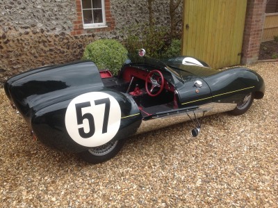

Looks utterly fab, Si!
Can't wait to see her in the metal!
