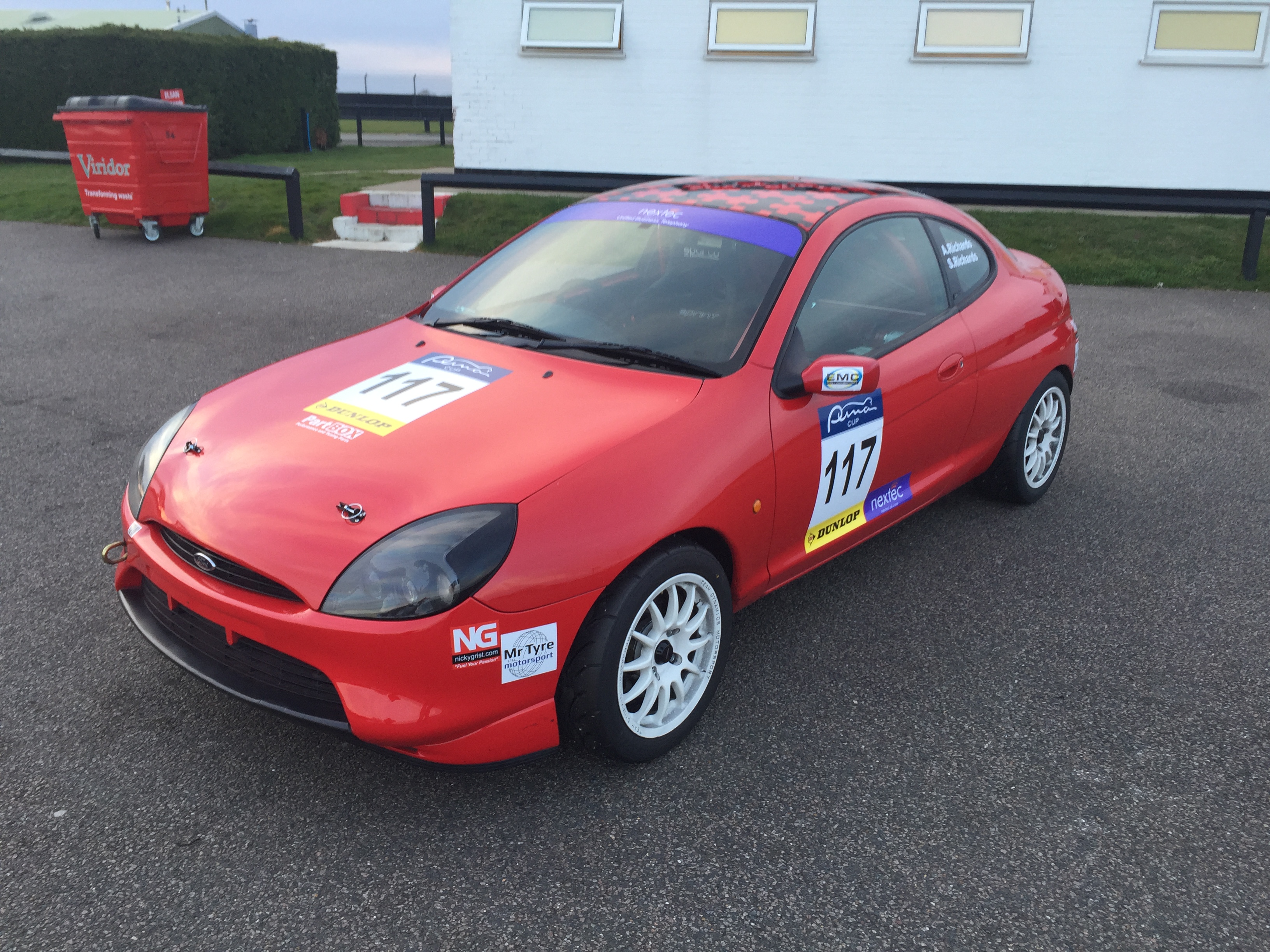

Hi Daggers, no I didnt give up just changed direction for a while and built the Puma which we are now racing in the Dunlop Puma Cup. My first time racing and what a lot of fun it is. I will take some pictures of the XI and pop them up ASAP for you. Glad to hear your nearing the end of the build I hope youve enjoyed it?
Cheers Si
In the meantime heres the Puma :D :D :D

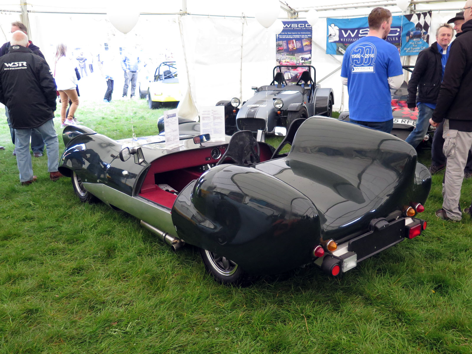

I too, was nearly there at this time last year but then I let other commitments take over until Christmas when I got my head down again and finished everything off in time for the car to be in the WSCC marquee at Stoneleigh (in all its IVA gear). My last issue was exhaust noise which, thanks to a new link pipe with a small Cherry Bomb silencer within it, has been successfully cured.

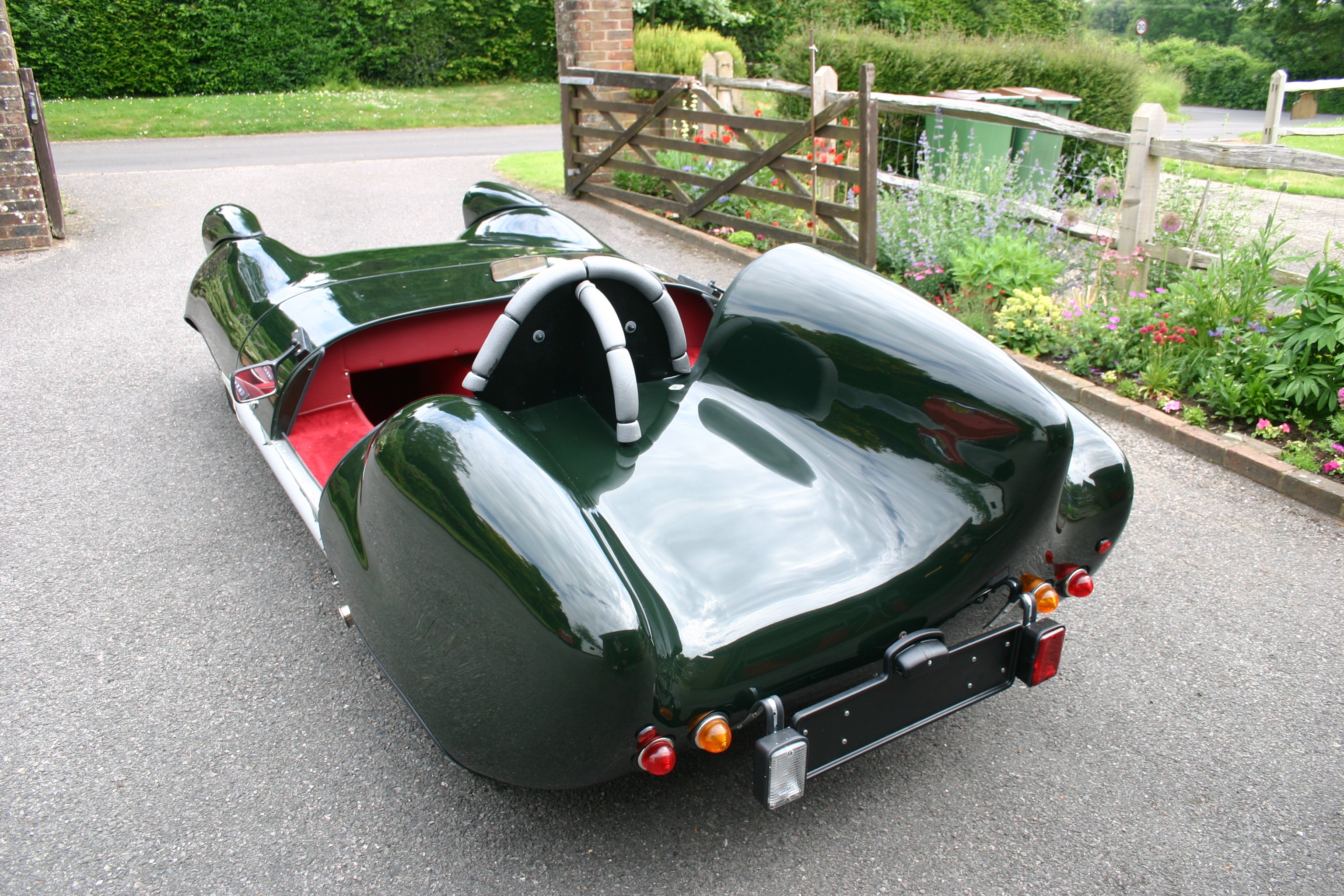

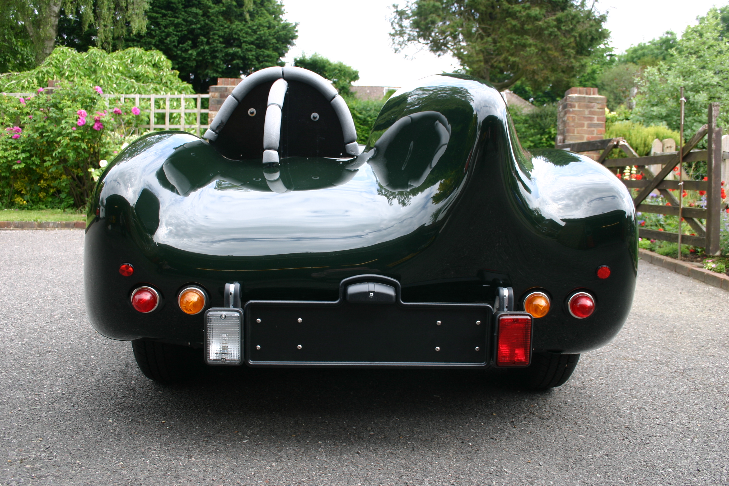

I've just heard from my wife that Photobox have delivered my build photographs of my Eleven so my IVA forms (already filled in last weekend just waiting for the prints) will be posted off tomorrow. I've asked for Kidderminster / Bristol - where are you planning to take yours?

My fog / reversing lights are 265mm to the underside of the lenses - I was able to leave tolerance with mounting them horizontally.
The basic IVA requirement is for 99dB(A). My initial noise test (using Oxford Motor Club' calibrated meter) was in excess of 104dB(A). I have now replaced the link pipe (between manifold and silencer) with a new one containing a Cherry Bomb silencer and, with new spark plugs fitted (as the old ones were rather sooted up with a lot of ticking over in the garage), it ran smoothly and 95dB(A) when tested at 4,000rpm and the meter 500mm from the exhaust outlet - Result! The silenced link pipe was built for me by Custom Chrome in Nuneaton (who make the Cherry Bombs). It is currently in mild steel but once the IVA is passed, they are going to replicate it in stainless and I'll happily use a two box system. I have also built a floor below the Weber carburettor and sound deadened this and the panelling in that area (which is, of course, open to the exhaust).
