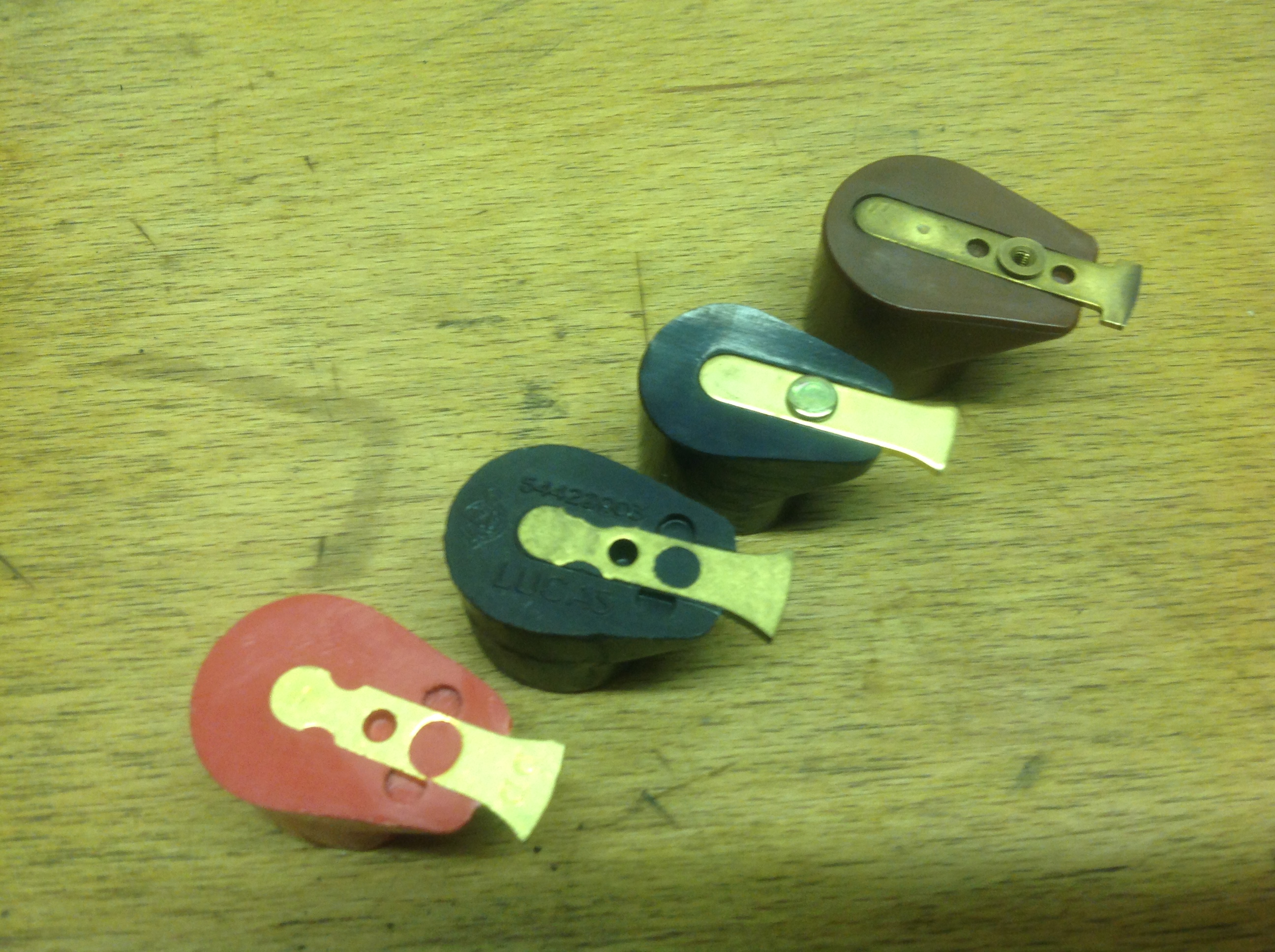

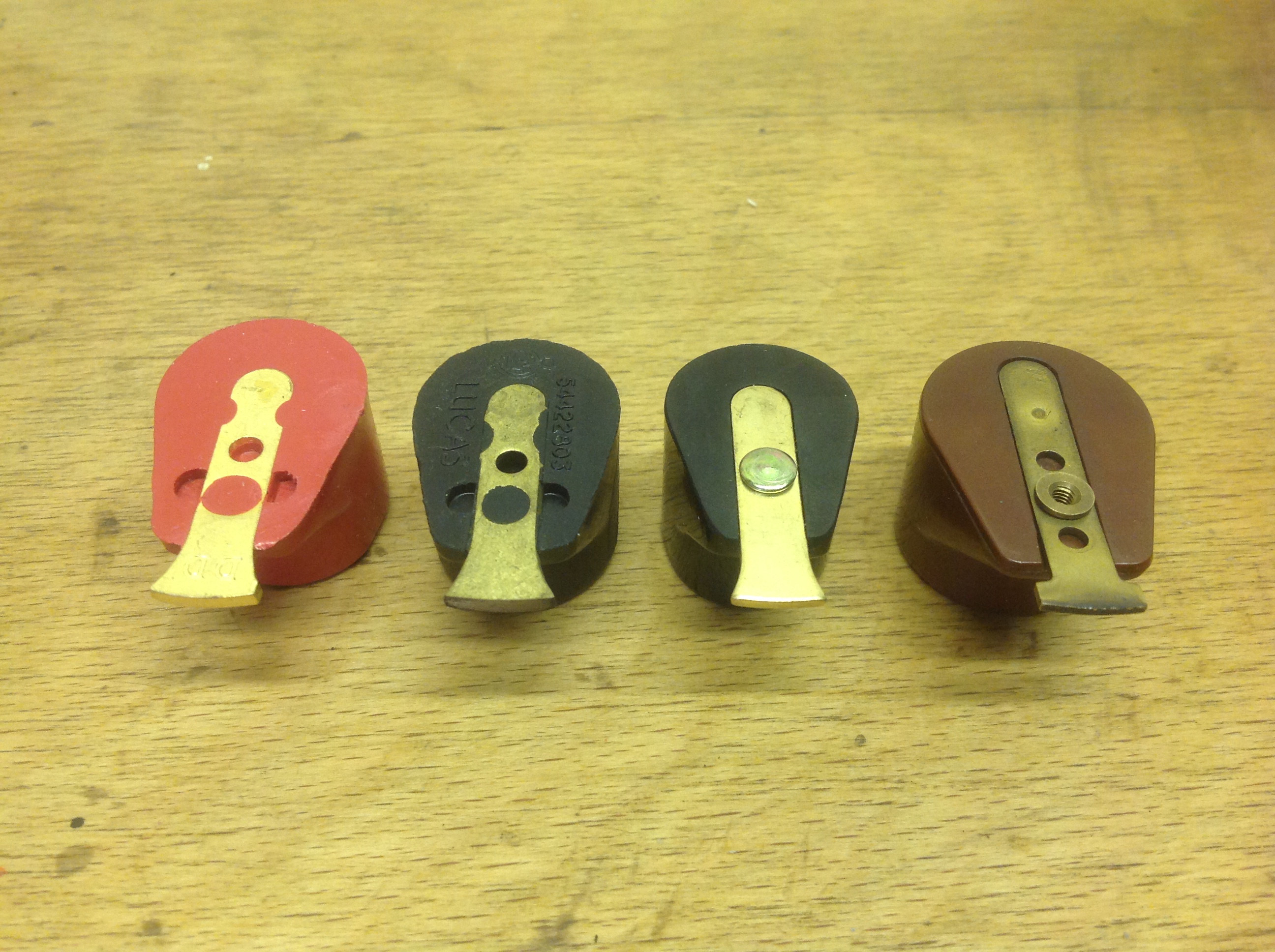

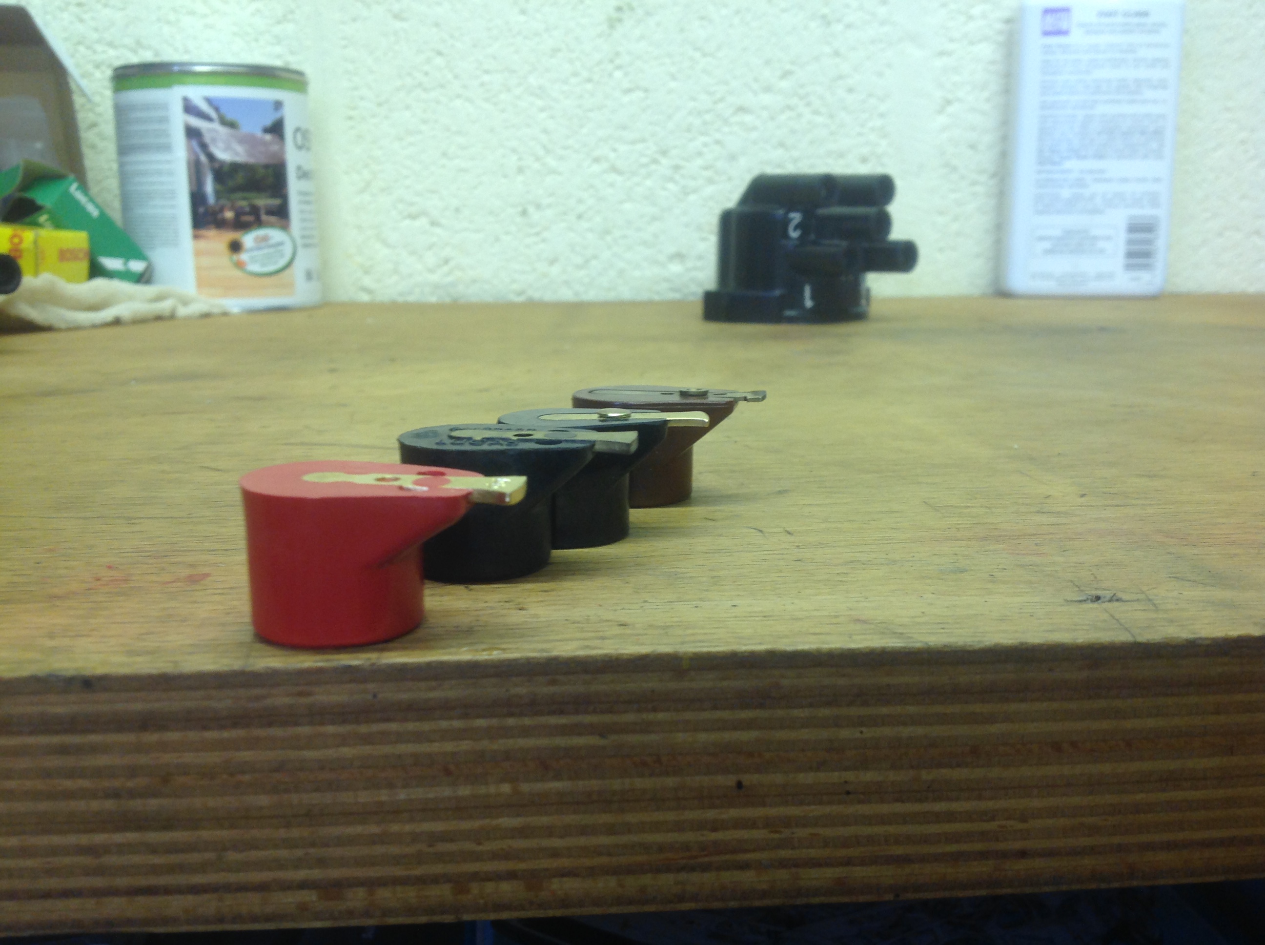

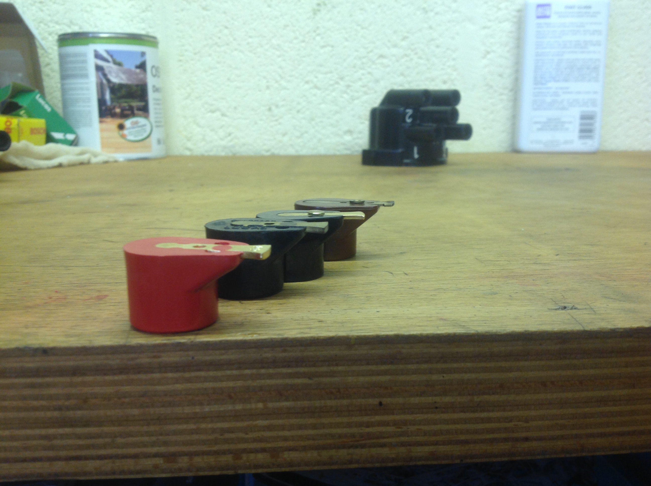

The difference in quality is quite clear to see from the following photos. Here are pattern Lucas (black thermoplastic with the offending rivet), brown Bosche (also riveted), black NOS Lucas (thermoset, no rivet, Lucas script and crest moulded on) and Distributor Doctor (red). Note the difference in both the thickness of the insulating material and of the brass contact on the latter two when compared to the modern replacements:

And a word of warning. The Far Eastern manufacturers are aware of the Distributor Doctors products and now produce rotor arms in red. They even flog them in Lucas boxes! They're all over eBay. Some of the better UK distributors seem to sell the DDs rotors, but they are actually cheaper coming direct from him. I received mine the following day, together with the little felt pad that lives underneath, something that appears in no parts catalogue and that I'd quite forgotten about before he reminded me of it (I remember it from my first car, a "Frogeye" Sprite!).

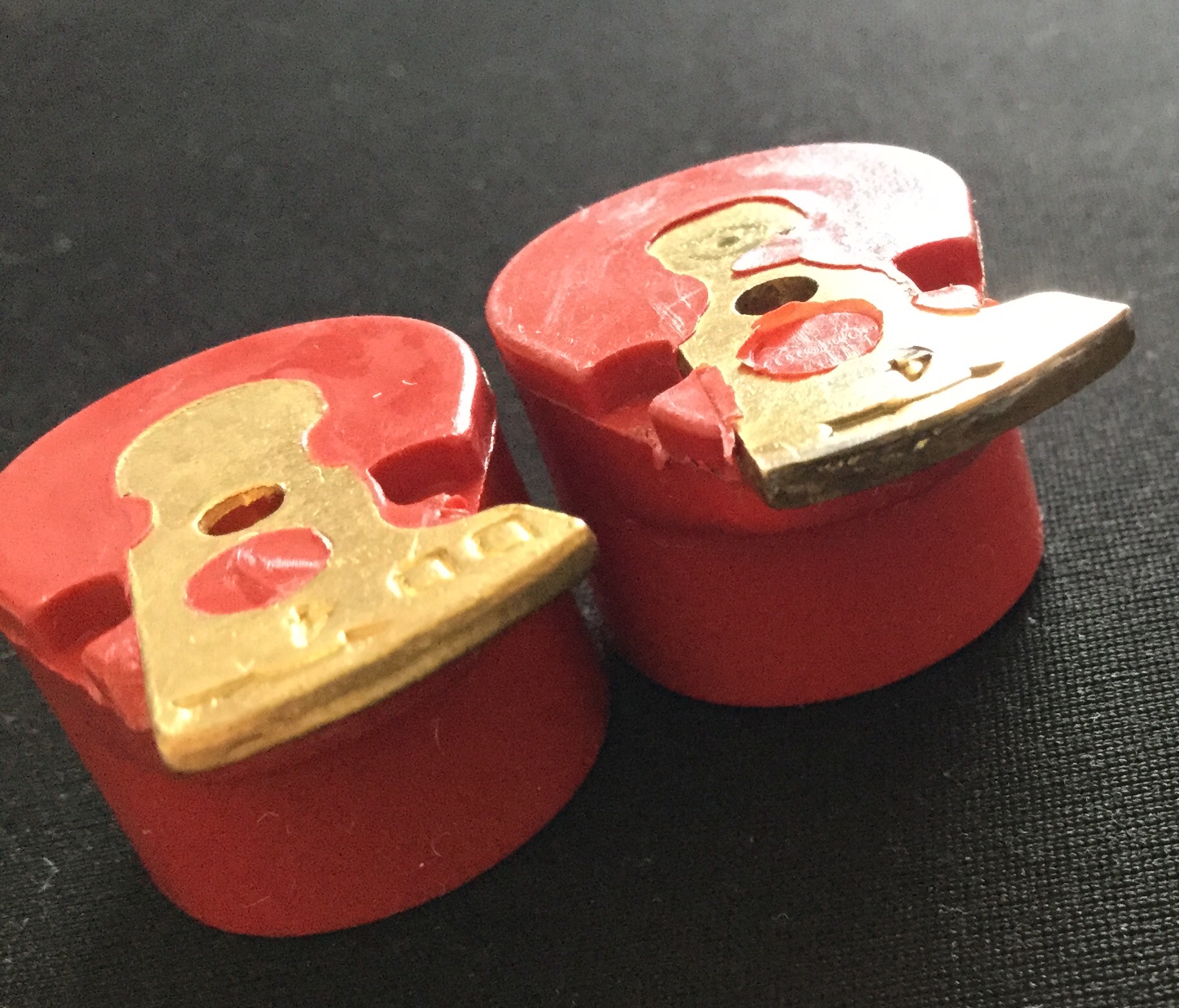

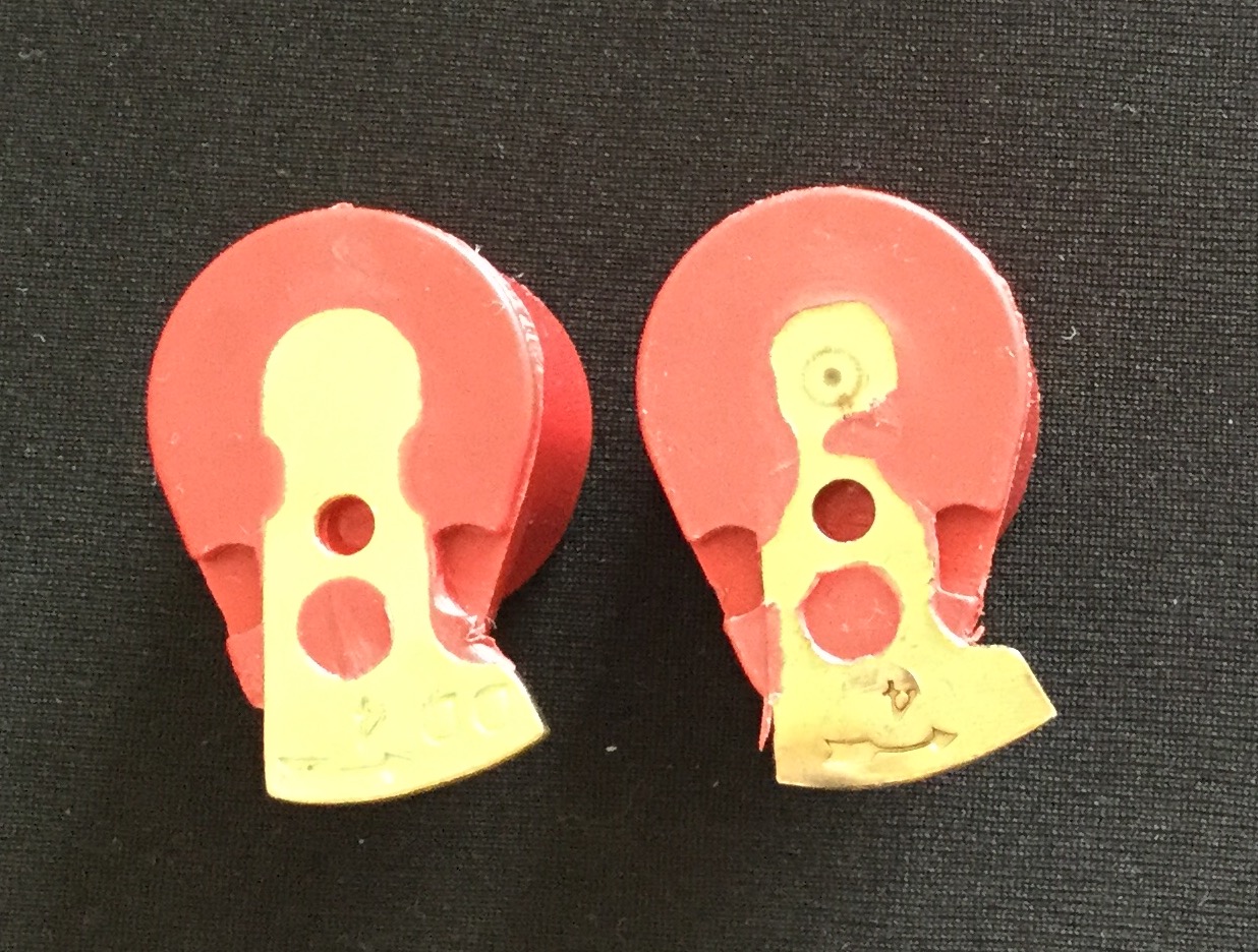

I whipped off my distributor cap last light, ready to install my shiny new DD rotor. Insert of finding some tat with a nail in it, I found what looks suspiciously like an older DD rotor arm. Martin did think my name rang a bell, but I thought it was because we had spoken on the phone a few weeks earlier. Maybe correct, and this was the original rotor TonyL fitted some 4000+ miles ago.
Funnily, the symptoms of ignition failure when hot, and recovery when cool, just pointed to the rotor. The old one looks worn anyway, so it has been swapped. Could be that the problem lies elsewhere. Need to replace a T10 sidelight holder and connectors before I can do an extended road test next week.
Here are a couple of pics...
