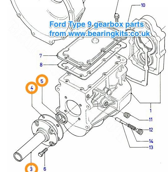

When I first removed the engine, the front of the gearbox didn't match the interweb photos that I was expecting. Seems that by build number five, "Jim" had realised that, so long as he could source the bell housing, he didn't have to buy a 5-speed kit; all the parts being readily available. Except that, as with so much of the hidden oily bits, corners were cut. So the t9 'box in my car had a front cover of the wrong length. That's the piece marked number 3 in the diagram below. It shrouds the input shaft, with the release bearing translating to-and-fro along it. Rather than source one of the correct length for the application, "Jim" had utilised a cover with a tube of minimal length, leaving the input shaft totally exposed. It was a matter of moments to obtain the correct one.
The input-shaft oil-seal (#5) is mounted within this piece, hence the cork gasket (#4). However, I can't remember if I threadlocked the retaining bolts. If I didn't then it would be very easy for the cover to become loose and leak. Or the seal may simply have failed. Either way, that explains why I have a complete seal and gasket set for the t9 save for the one seal and two gaskets that I now (probably) need.

Input shaft length for the t9 is critical, and I can't remember if it is the long or short shaft, and from what car it came from...
In any case, the input shaft shoudl be shrouded, save for the pilot end and the splines.
If what you have works, I don't see where there would be a problem. The cover doesn't stabilize the shaft, it just supports the release bearing. That job is for the pilot bushing, and the transmission's front bearing. If it works, giving the release bearing the correct travel and support, there is no reason that it can't continue to be used.
It could be that you just have a bad front seal. in any case, you should be able to source a front cover from BGH or other supplier for little expense, if you think that you need it.

The guide tube doesn't actually do very much. The release bearing should translate without coming anywhere near the input shaft. Having said that, I simply bought the front cover with the longest tube that I could find on eBay and cut it down to suit! It may not do much, but it's CORRECT.

A very short tube and a strange juddering? Well, there's a thing! I wonder if Jim actually DID use a factory T9 kit when he built my car? The original extension tube of my gearbox was about an inch long. And I've only recently discovered that the damper springs of the friction plate were impinging on the flywheel bolts! The solution was to file the flywheel bolt heads down by about 2mm. I strongly suspect that you'll find impressive witness marks on the flywheel bolts. After 15,000 miles, mine were totally remodelled!!!!
