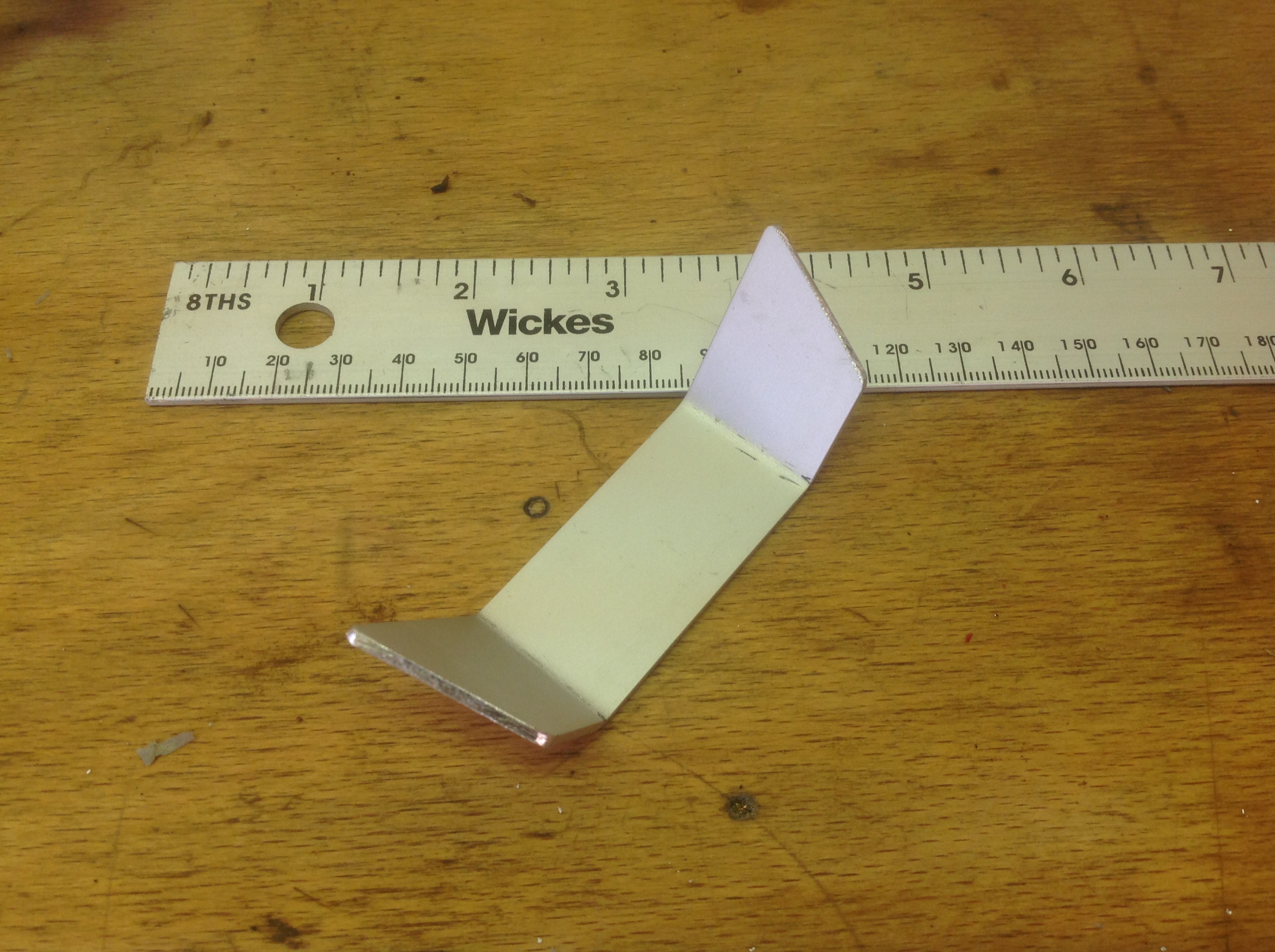

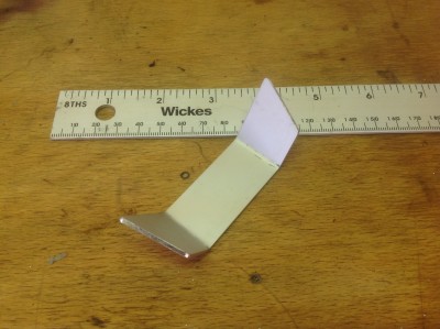

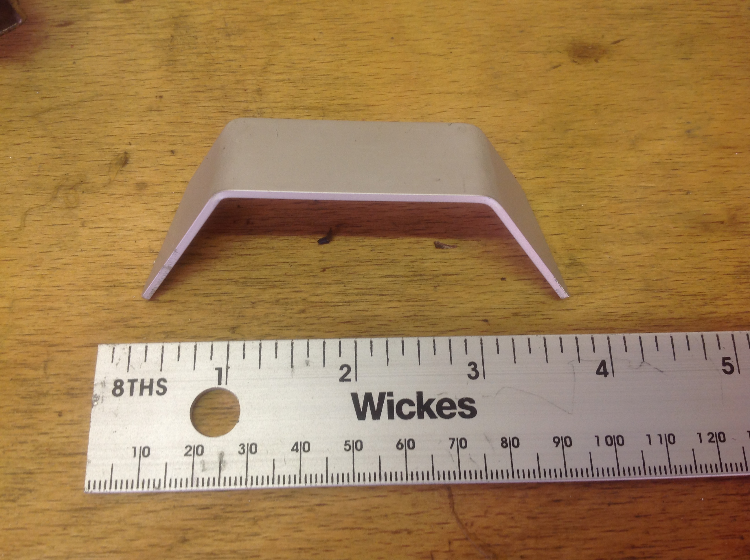

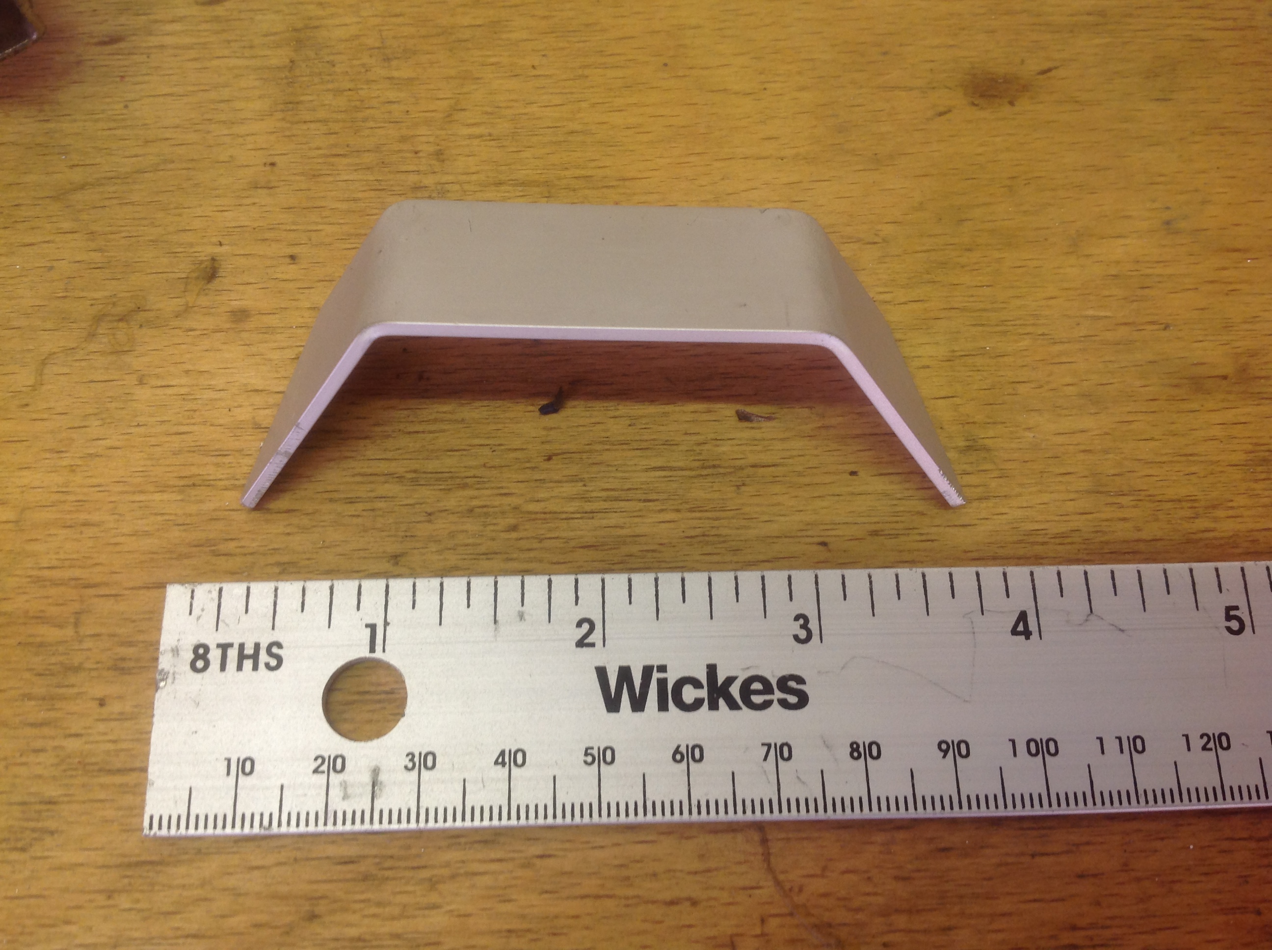

Whilst I awaited delivery (2days) I made a guesstimate of the size of the drivers and fabricated a pair of very simple brackets to mount them on.
http://www.powerfuluk.com/?gclid=CLns6a ... GwodlooJzw
£70 for the pair, including carriage from their eBay store.

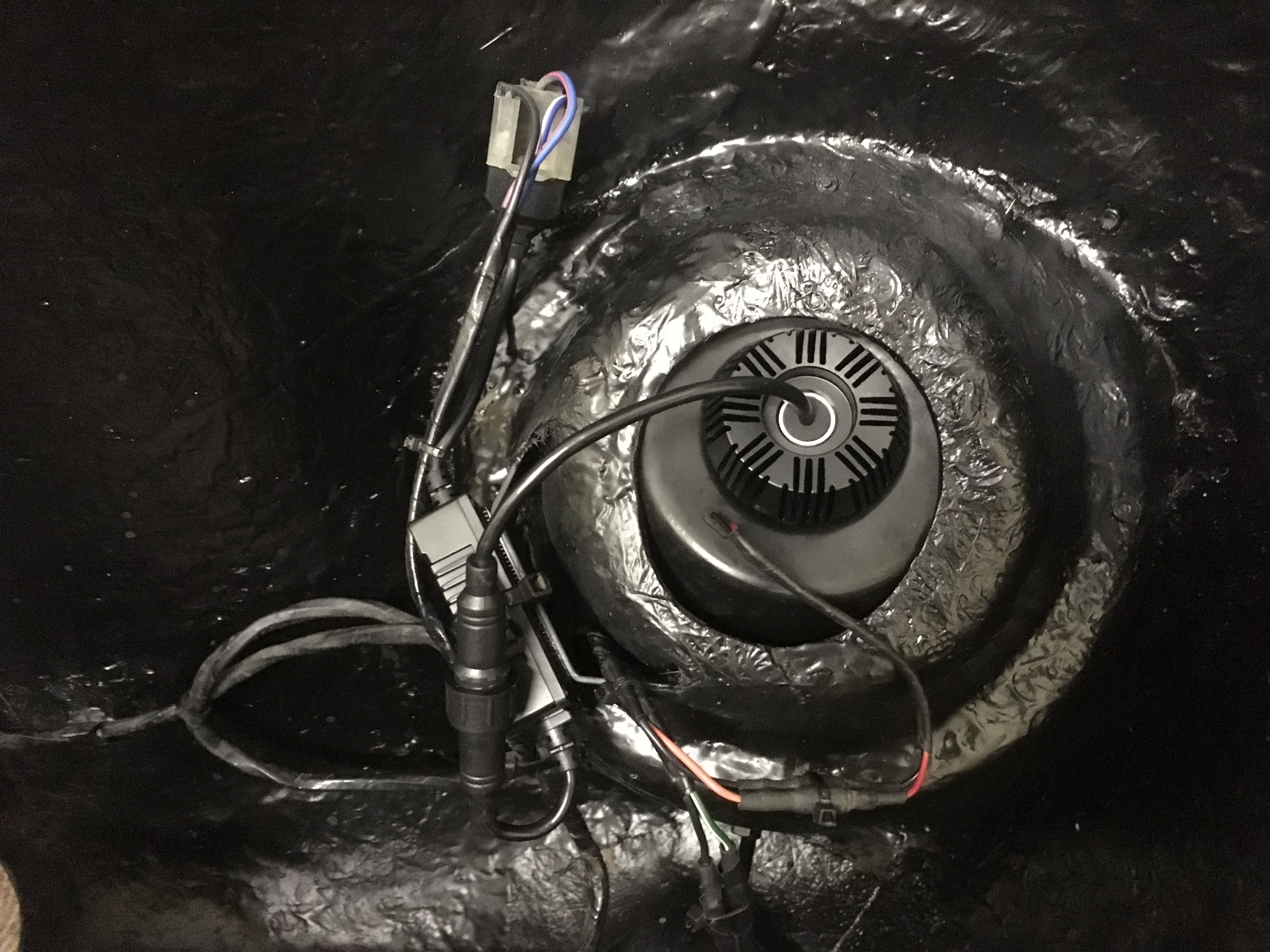

Re: LED HEADlighting.

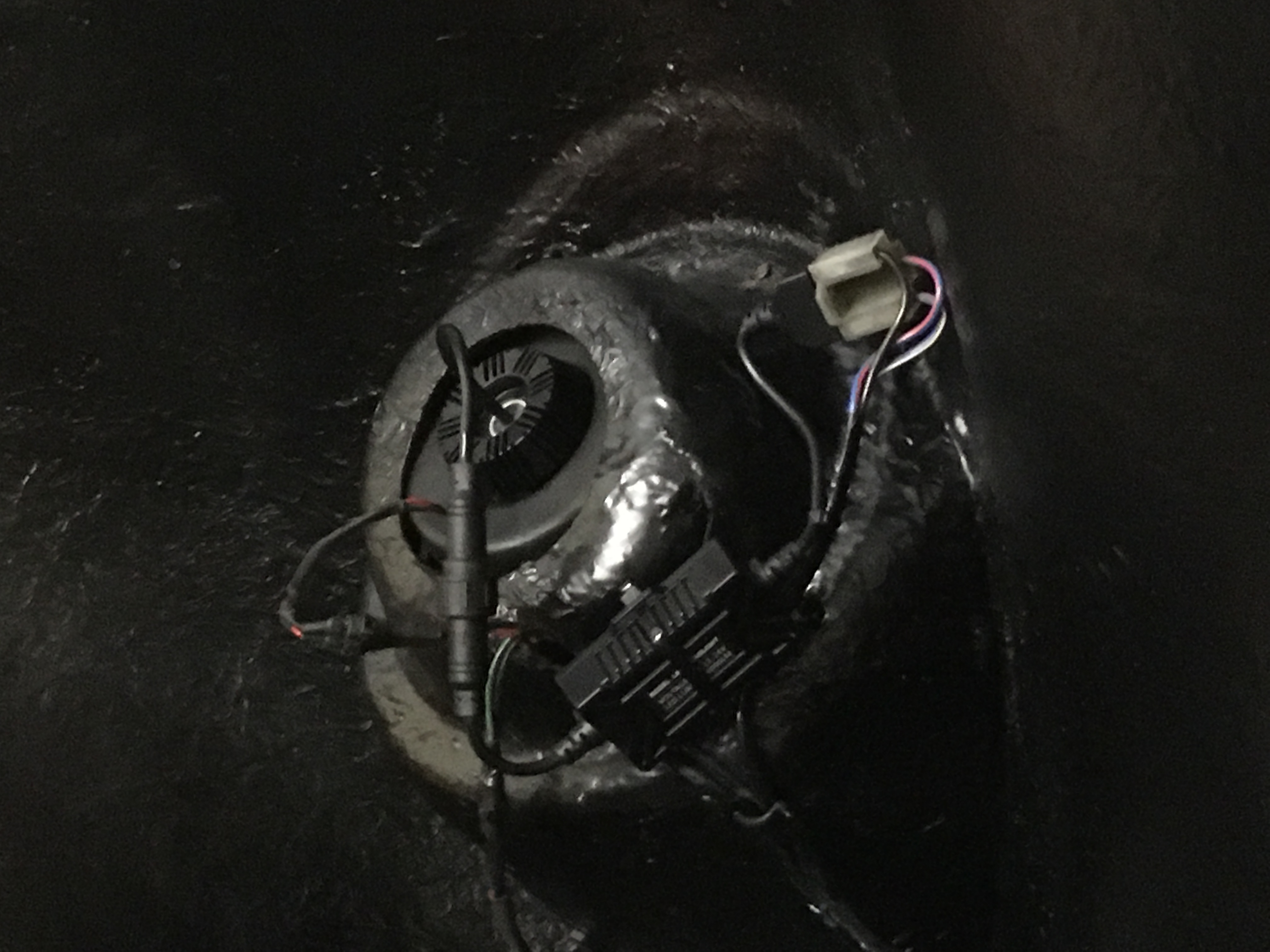

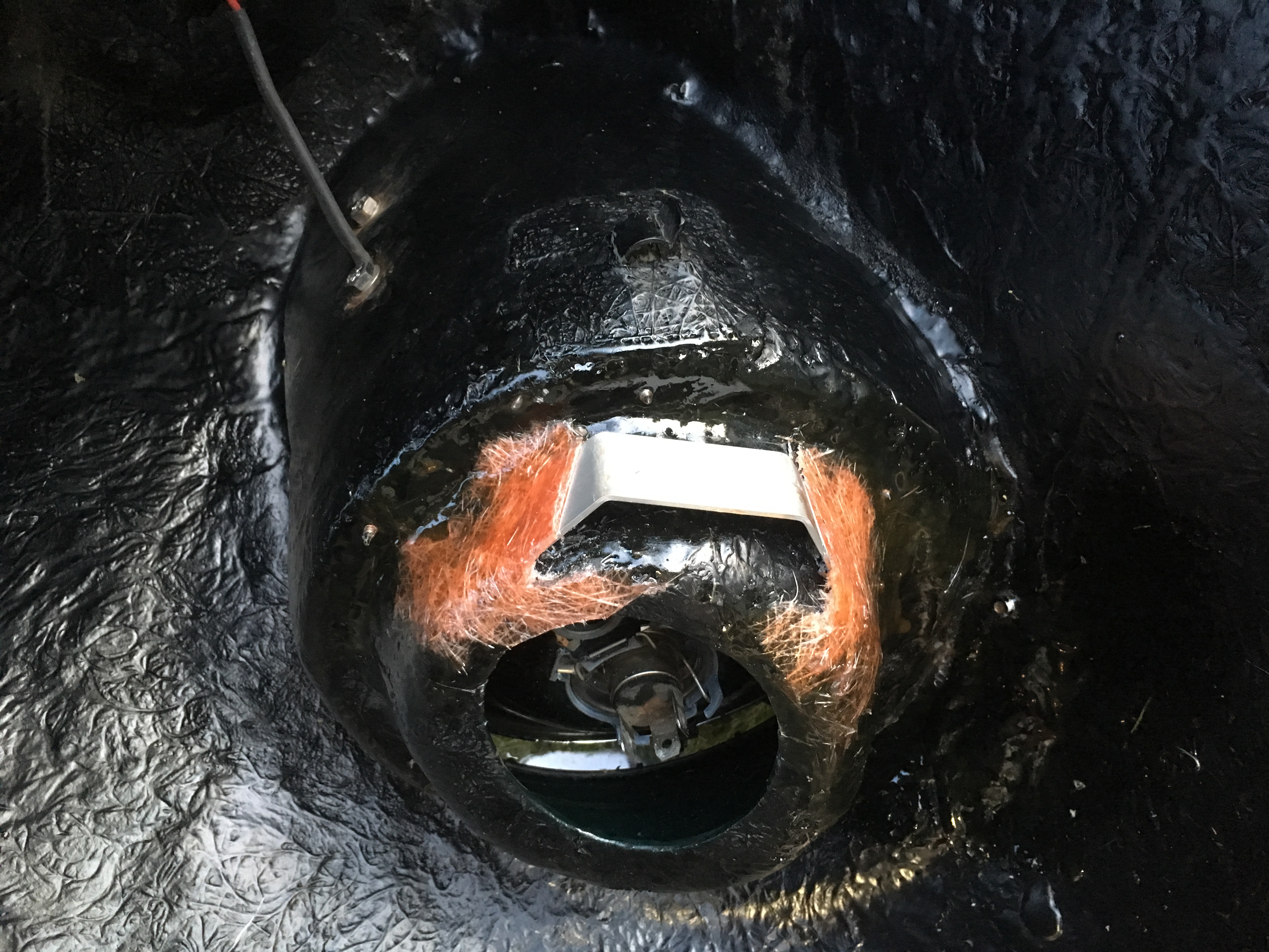

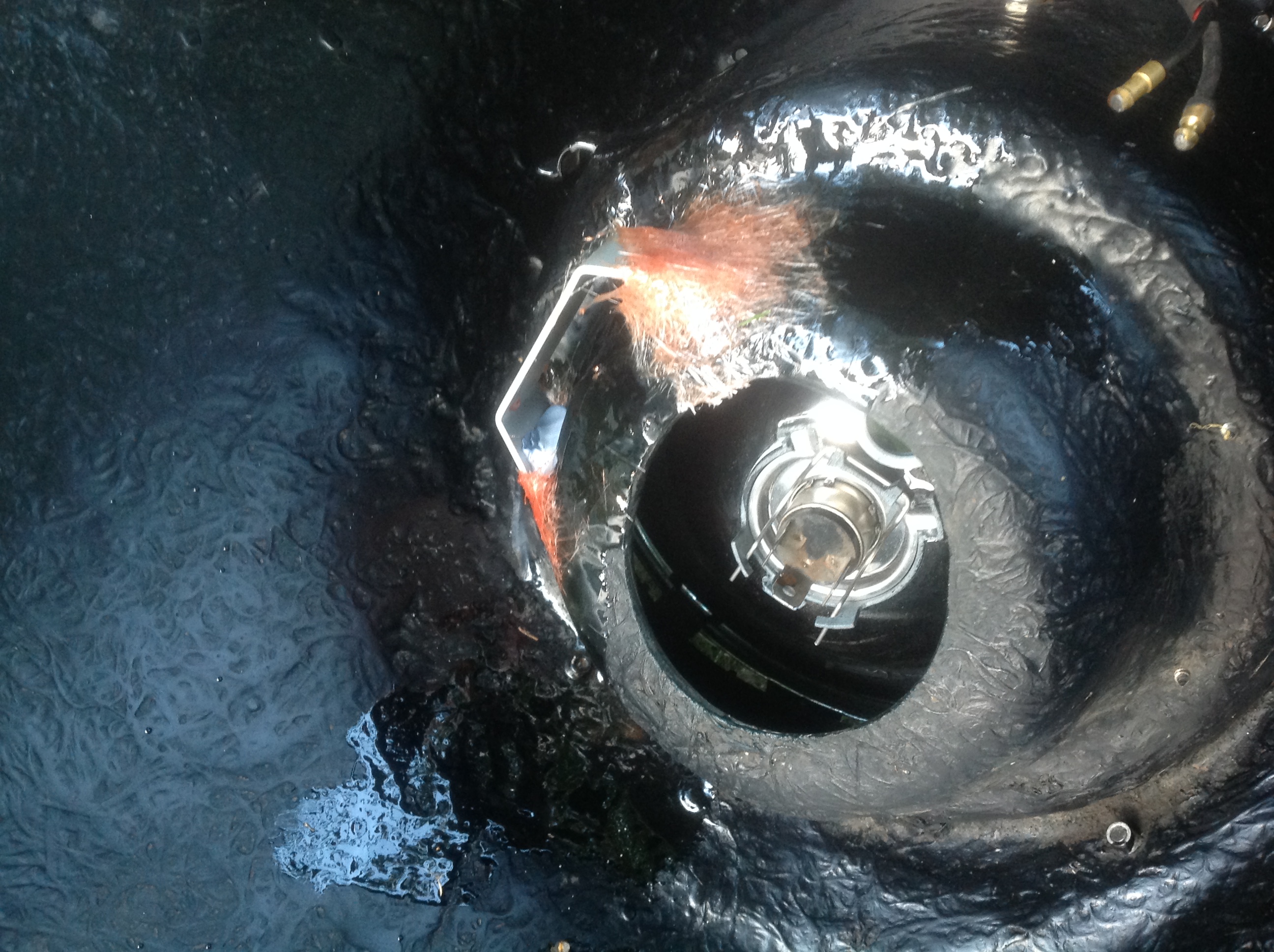

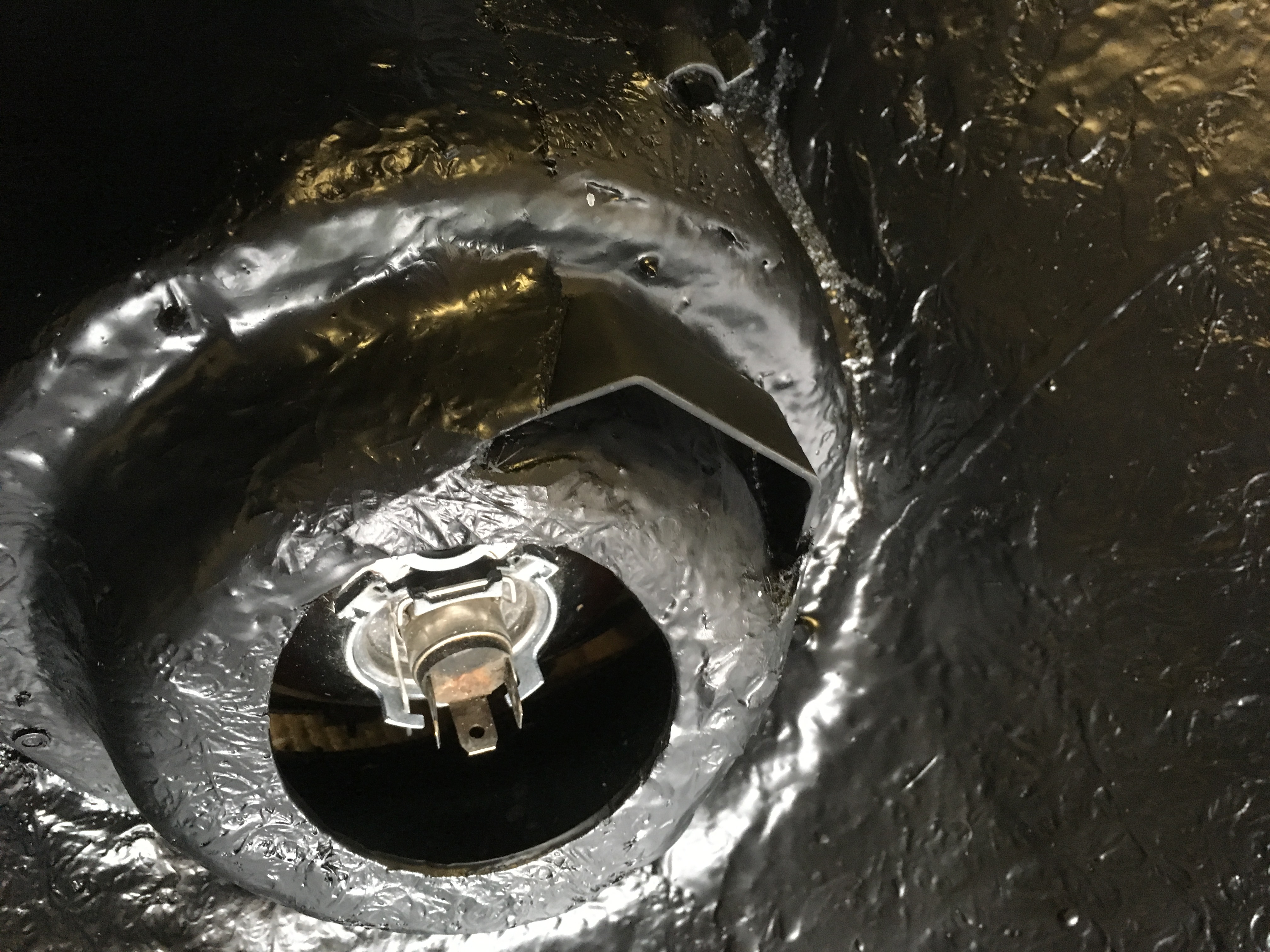

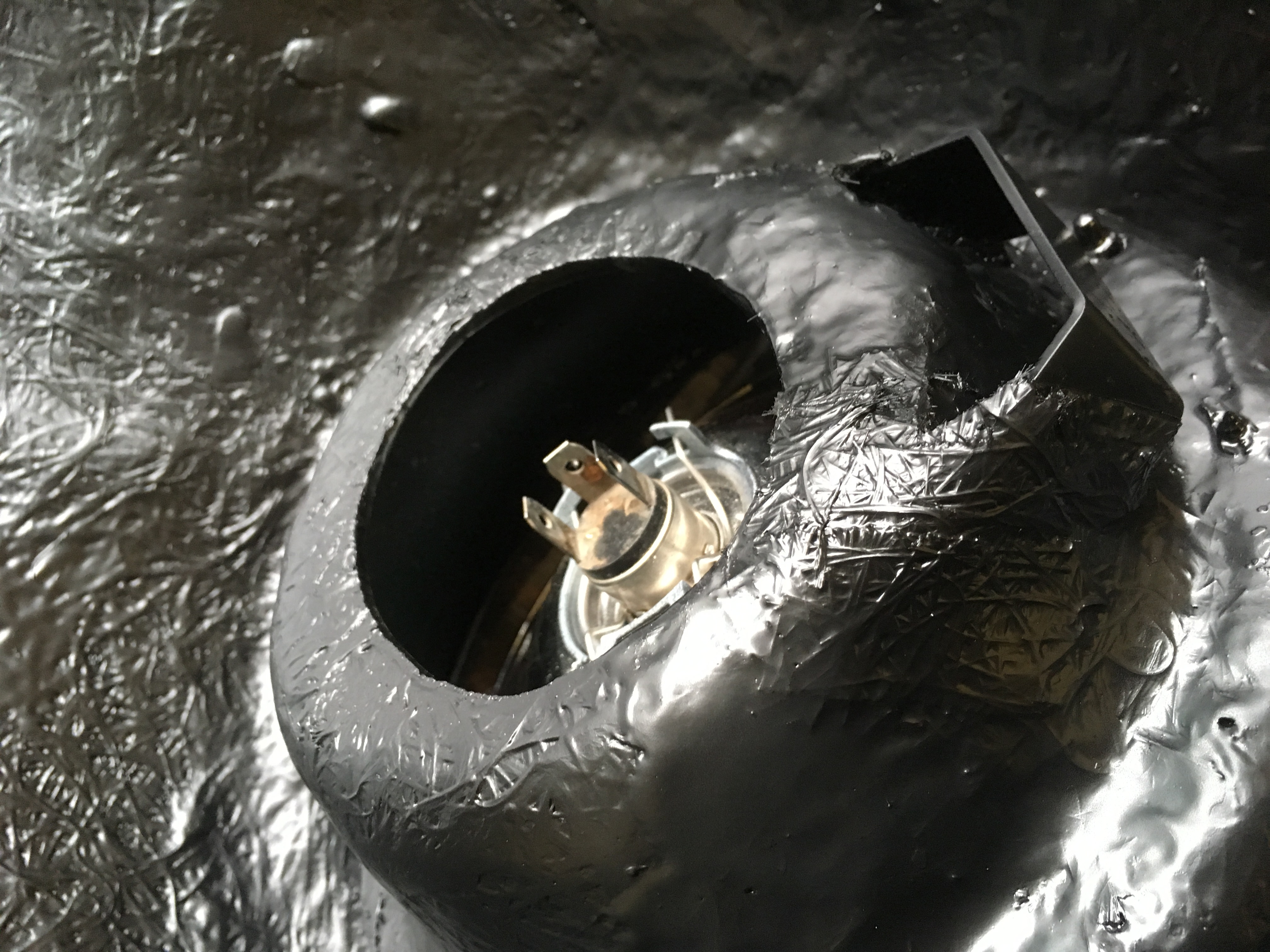

These were then loosely held in position inside the bonnet with blutac whilst I glassed them down:
I know! I know! You've seen more attractive dog's breakfasts. Well, nothing a bit of paint can't sort out:

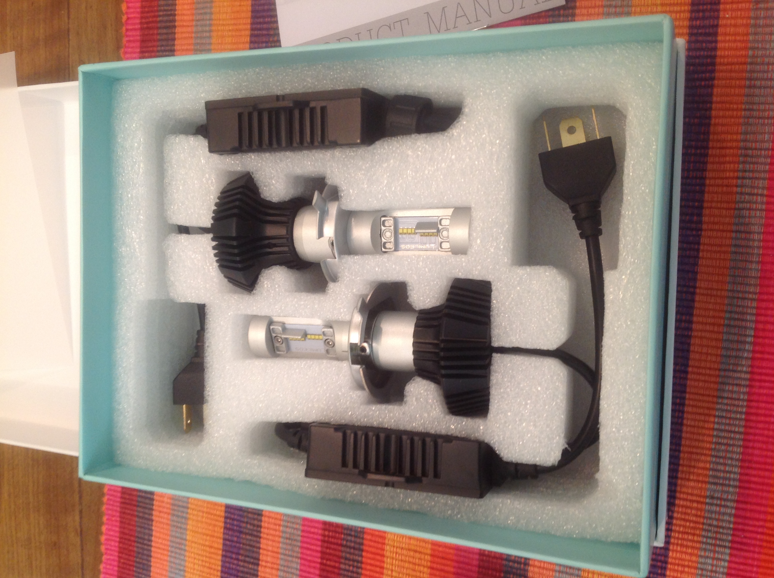

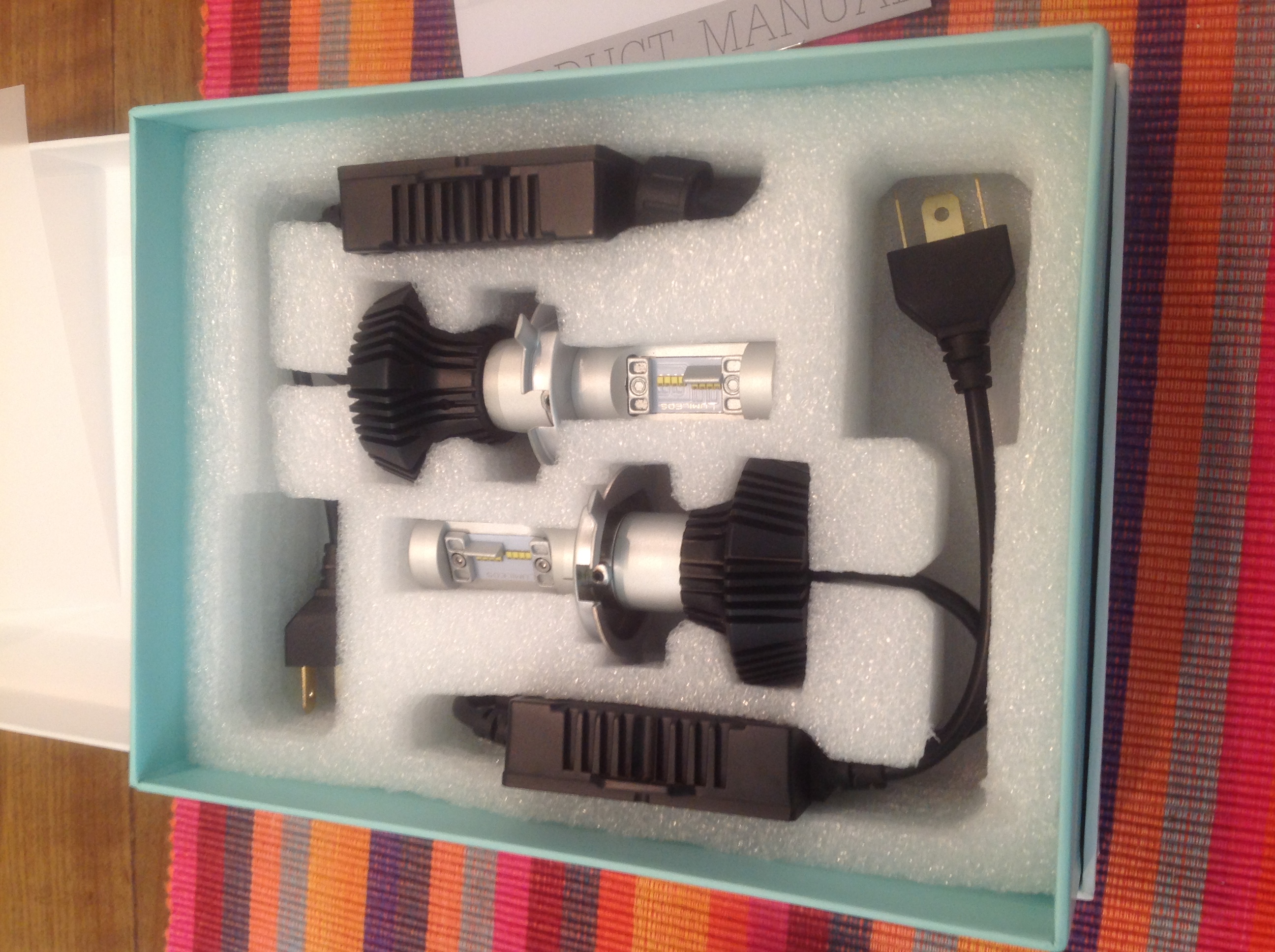

The kit arrived today. There's no manufacturer's details anywhere, nor any indication as to country of origin, which is a pity! From packaging, to literature, to unit construction it's all an absolute work of art. Without a doubt, the best-made piece of aftermarket equipment that I've ever handled.
Everything that possibly can be is hard-anodised, beautifully cast aluminium. The bulb's body, the heat sink, the driver case (both main body and base), even the little deflector blades for the dipped-beam array. All threads are coated with a wafer-thin smear of white grease, as are the waterproofing o-rings.
Honestly, it's exquisite!
