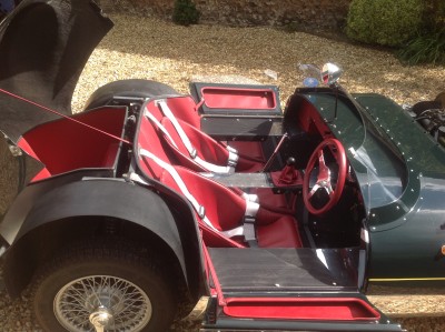

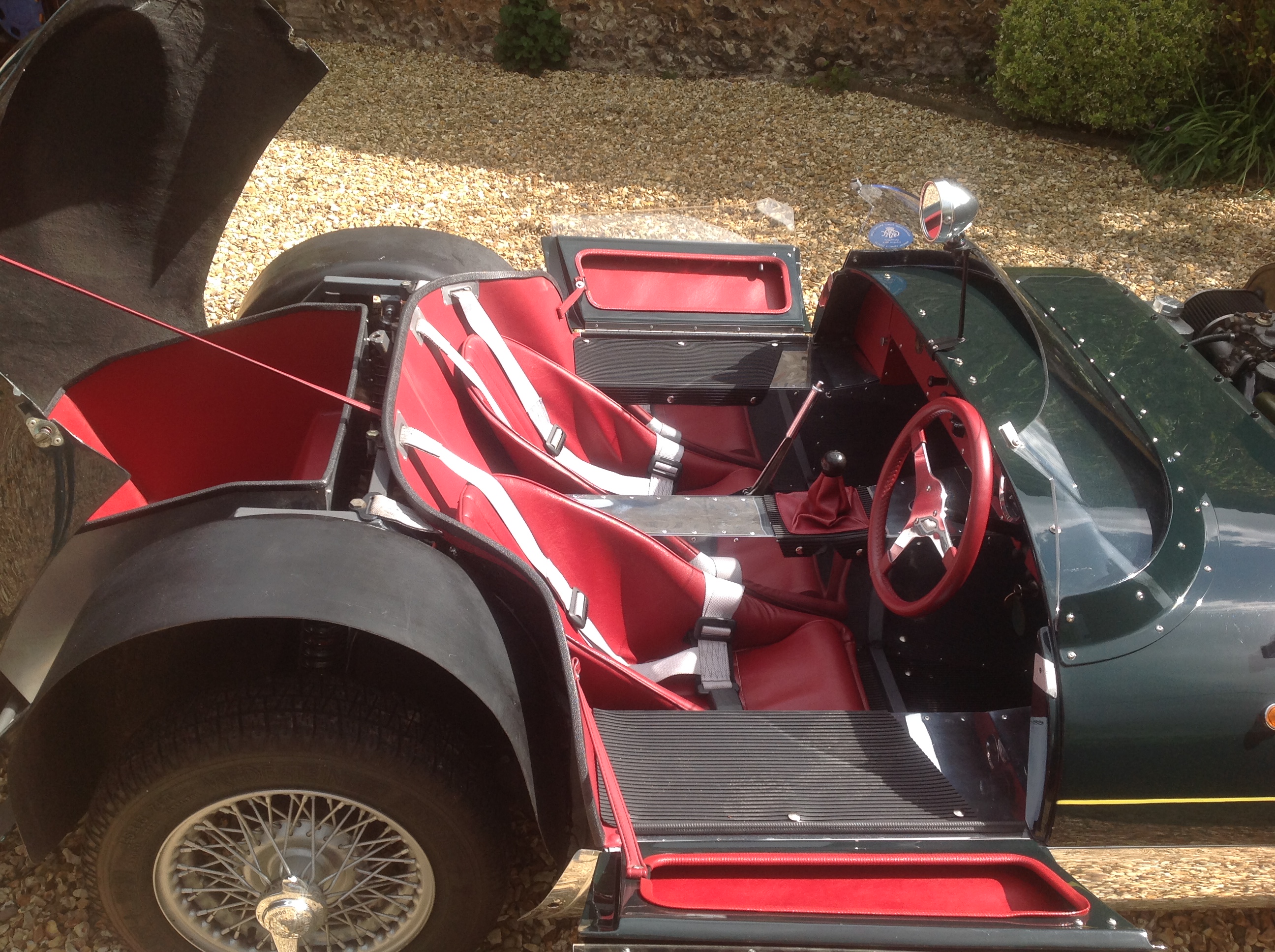

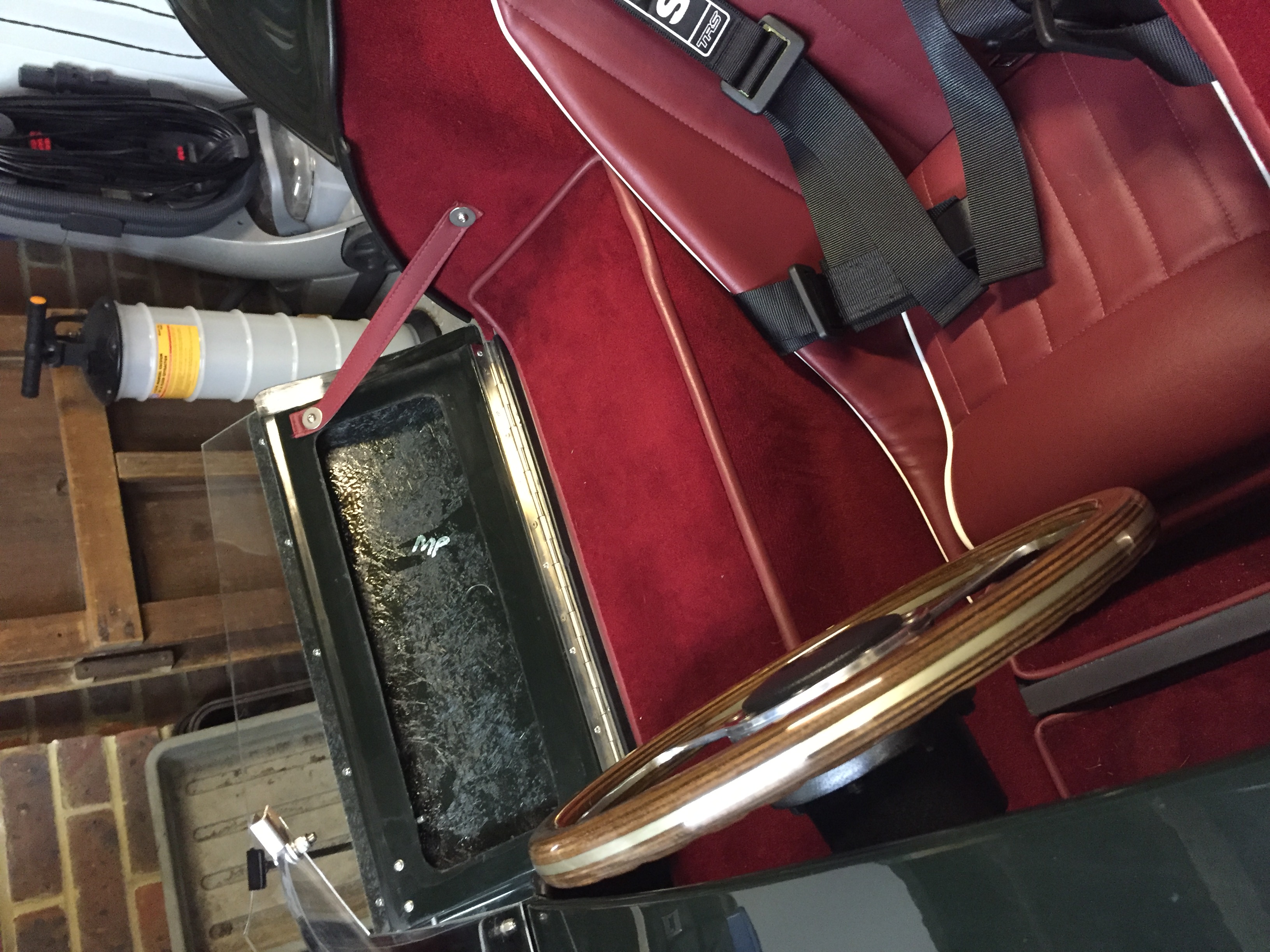

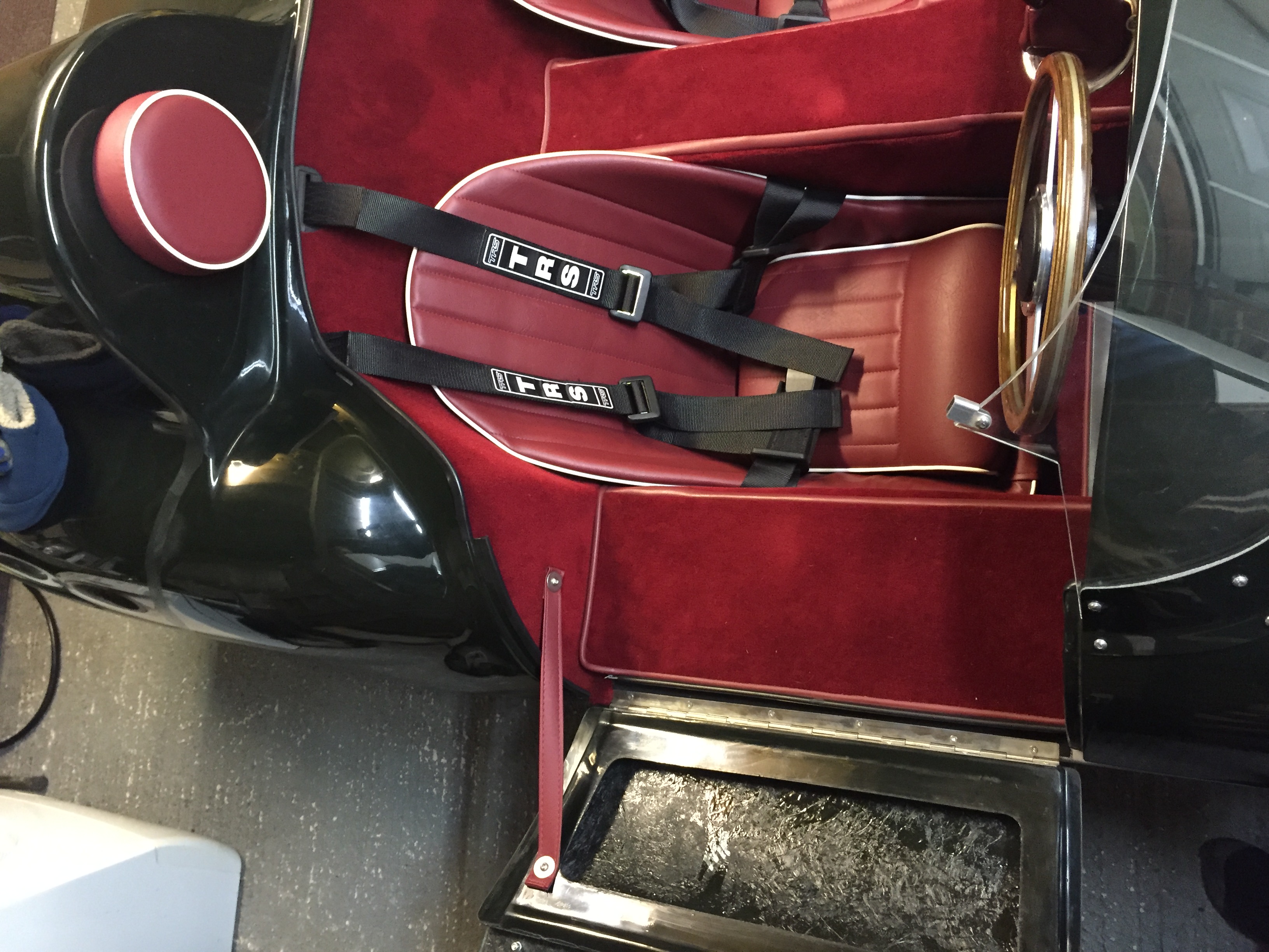

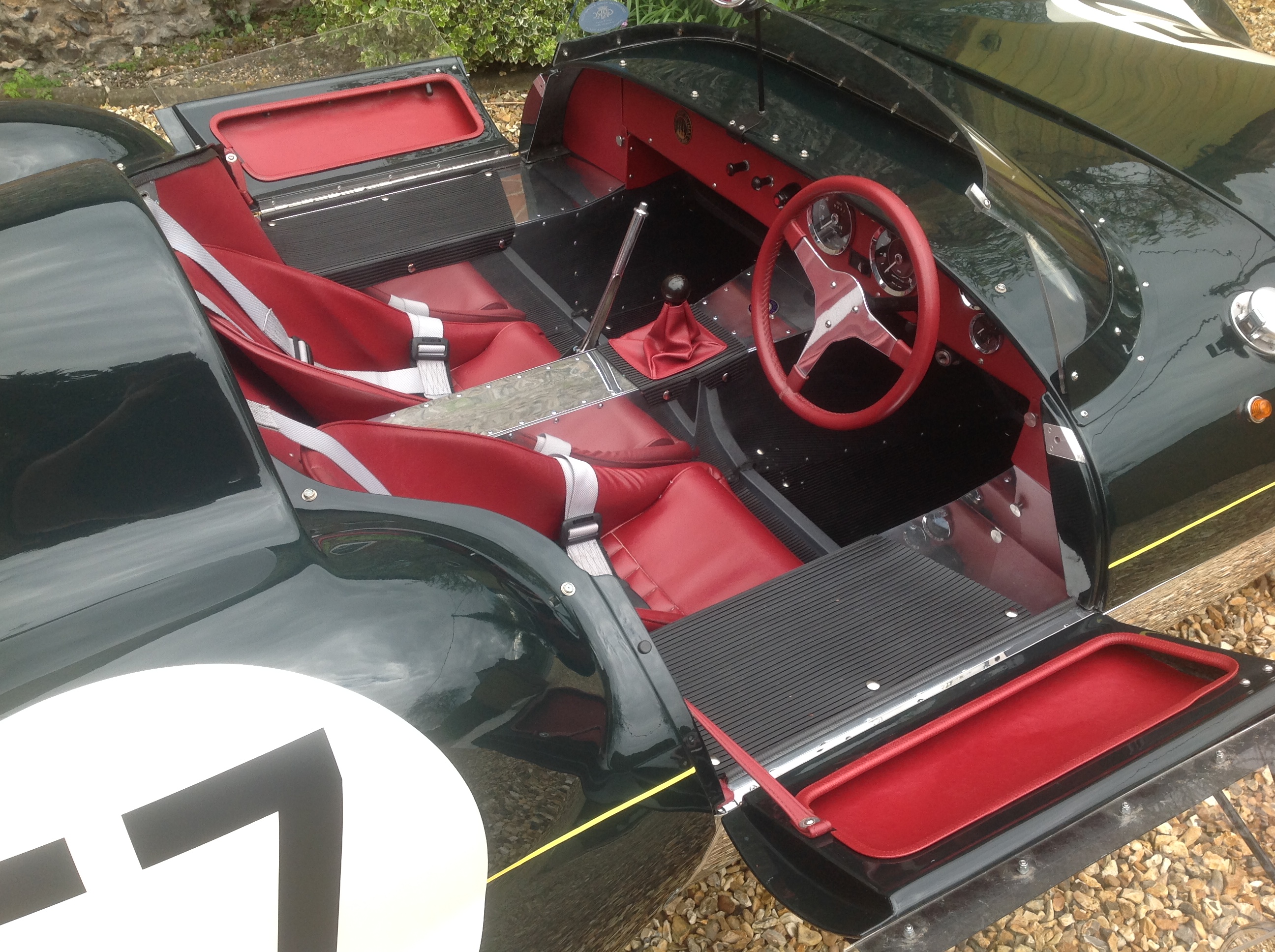

A couple of photos of mine showing the door straps. Click/tap on a photo to see it clearly.
Mine also has the T9 5-speed 'box with a short, straight lever. I wonder if yours looks similar? I'm 180cm tall and my Westfield bucket seat is mounted on Midget adjustable seat rails. It's positioned correctly for me in these photographs with all the controls being very well positioned as a result.

Splat, you Eleven is gorgeous, and looks far more "Lotus" than mine, congrats !
Bucket seats seems or cushion seems finally a good idea, if I use a different gear lever.
About your steering wheel, where can I buy one like this ? Mine is ugly !

Mine are fitted very similarly to splats, the key is to make sure you have the door at a bit of an angle otherwise you run the risk if the strap stretches of it going past the pivot point and flopping to the ground :oops: :oops: :oops:
