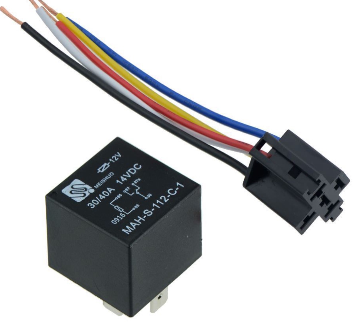

I found a suitably-rated automotive Relay for under three quid delivered.
12V Automotive Changeover Relay 40A 5-Pin SPDT with Socket
eBay link: http://r.ebay.com/LYuWzd

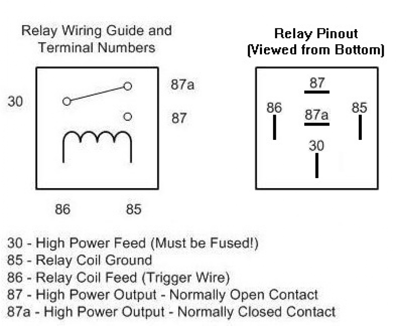

I've attached a pic of the Relay in question, and of the wiring diagram/Pinout.

Thanks to those who provided the images.
Now, how does this all work?
On the car, the brake switch connects the 12v feed to the bulbs. Simples.
On the Relay, the coil is energised by making the switch, thus pulling in the contacts and feeding 12v to the bulbs.
Spookily similar, but uses a fraction of the current to energise the coil. So your switch should last much longer (years longer, hopefully!), and you won't risk getting shunted in traffic.

I'm going to use my switch to make the ground connection.
Remove the female connectors from the switch. One will be 12v feed, the other goes off to the lights.
The feed will enter the Relay and also feed the coil. Crimp two wires on the Relay holder (30/86) into one male terminal.
Crimp a female terminal onto 85. Crimp a male terminal onto 87 (output to lights).
The coil ground (85) pushes on to one side of your switch. Make up a ground lead from the other side of the switch.
Hot feed (green) connects to the twin wires in the male terminal. Relay output (87) connects to lights (green/purple).
That's pretty much it.
