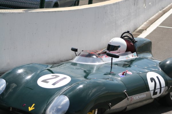

I believe only the original batch (1980's early 90's) are allowed to run with the hoop you are describing due to the certification. Ours is one of the originals and has this type of hoop, as shown in the photo. We have no forward bracing.
It has been picked up a couple of times by the scrutineers but on all occasions the chief scrutineer has allowed it due to the age of the car.
Are you running with a flat back of with the hump?
Speak to Alimaly or Eric Tharg on here as they both have fatter rollbars. Malcs roll bar is double width and allows passengers, Charles (Eric Tharg) is a single hoop requiring a forward diagonal brace for racing (bolt in jobby) but still allows passengers when removed.
