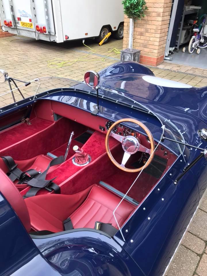

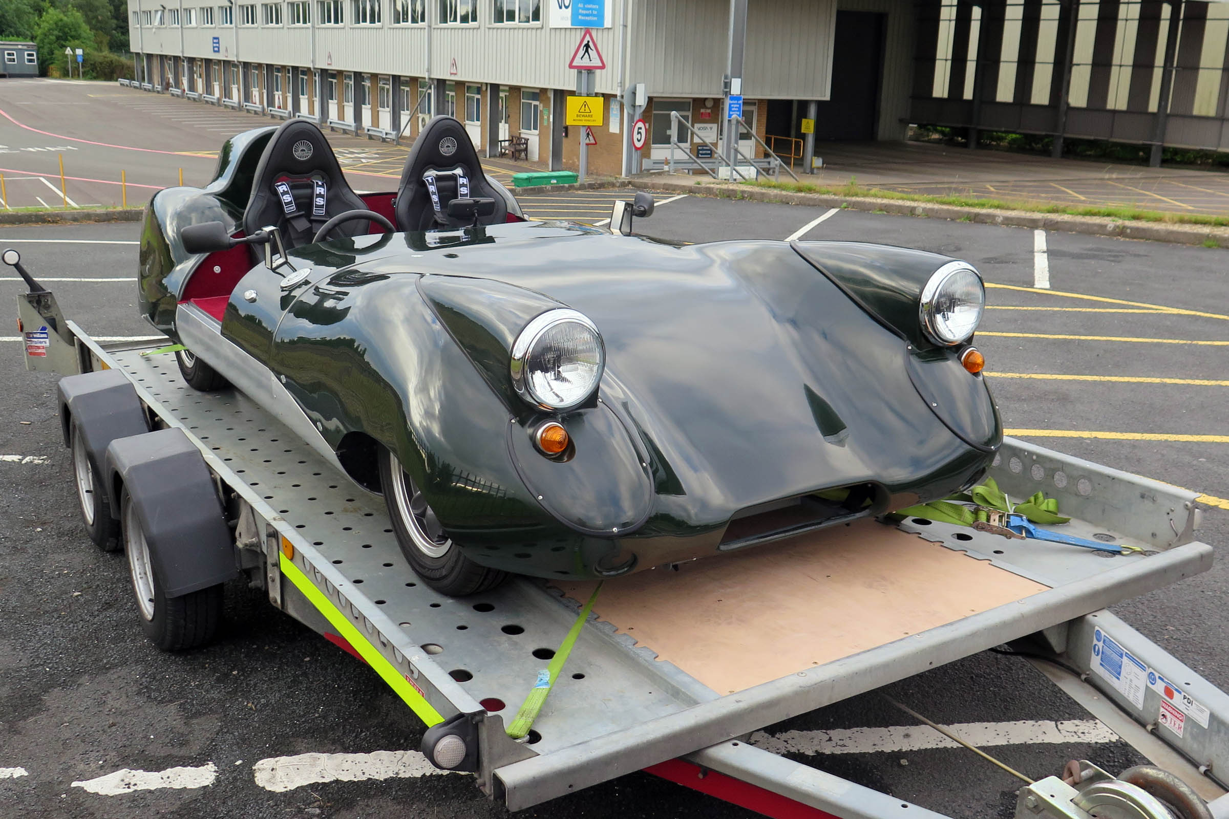

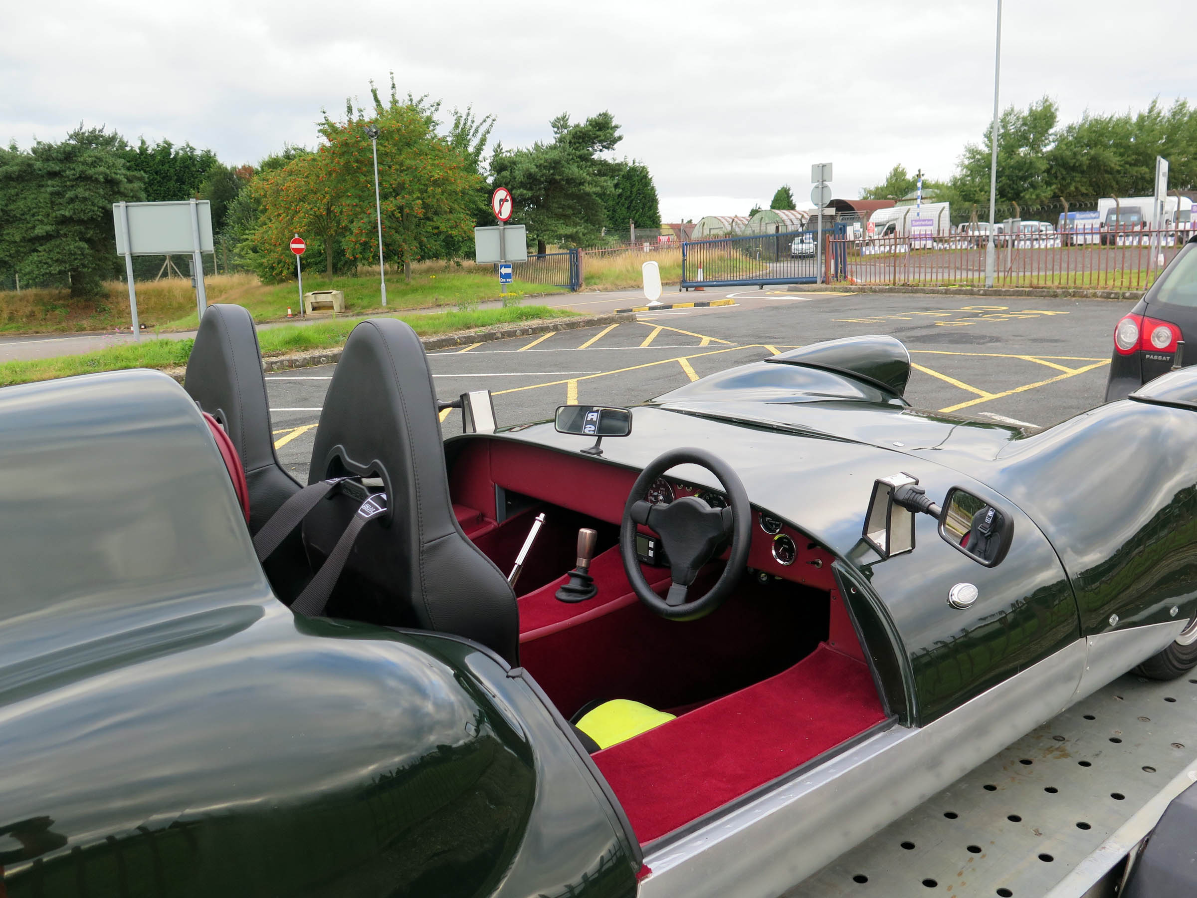

Here's some pics
[attachment=1]1.jpg[/attachment]
[attachment=0]2.jpg[/attachment]

Re: Westfield Cobra seat certification
Cracking result!
I always thought that fuel caps needed to be recessed or flush with the bodywork. Yours is sticking out so obviously no problem?
Nice garage BTW, very tidy indeed.
