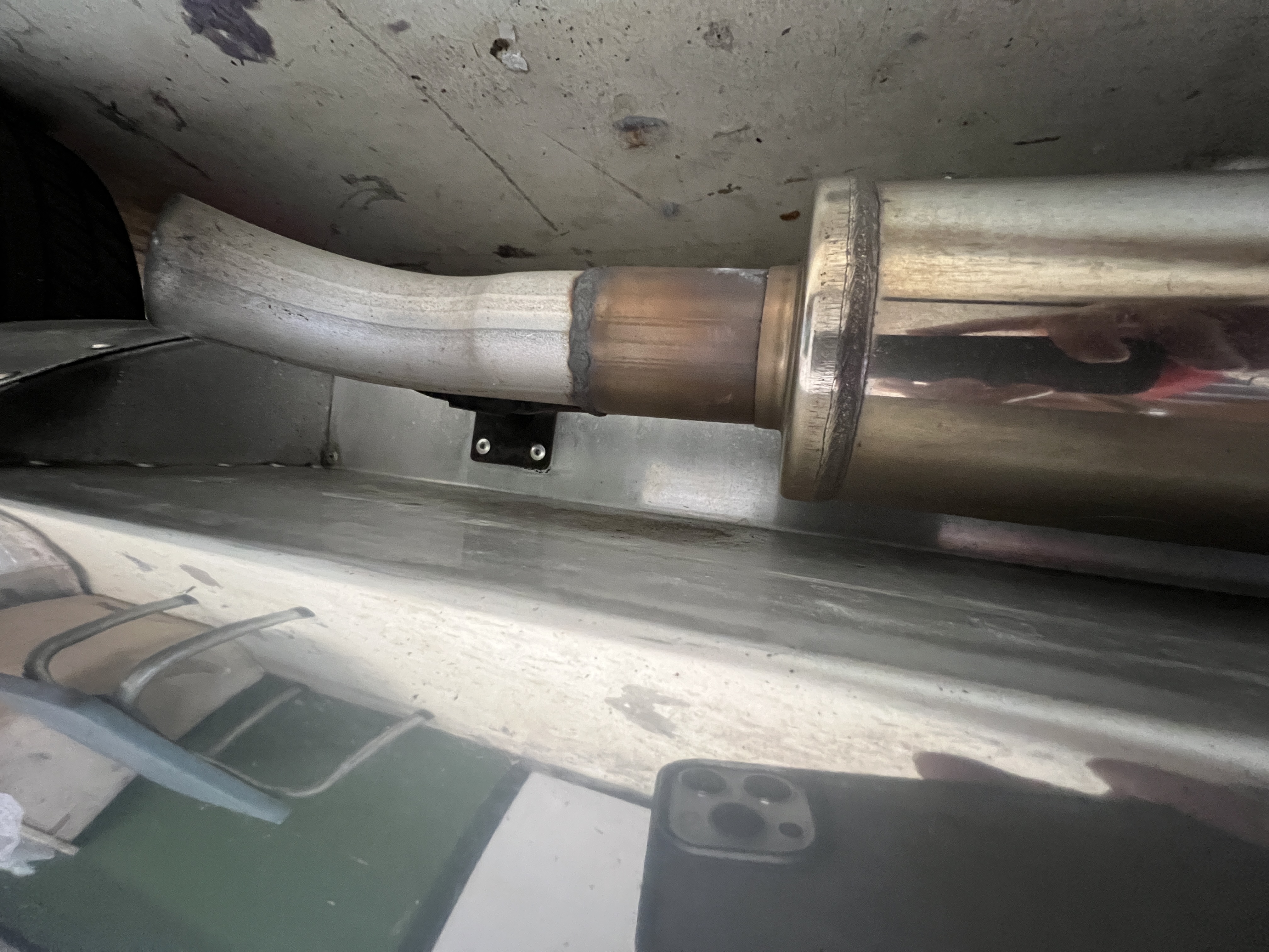

In road driving (new to me car), I noticed a clanking over bumps from the lhs. On investigation it's the silencer hitting the aluminium panel above it. It's slightly loose. At the front end the clamp is slightly loose. At the rear end it all looks a bit flimsy. Like a very big P clip round the silencer and bolted to the body.
I can nip up the clamp at the front, but I don't think it'll cure the problem. I need to make the rear "clamp" more capable somehow.
Also silencers ought to have some movement.
Any thoughts on the silencer mounting and whether it banging against the aluminium is normal/acccepted?

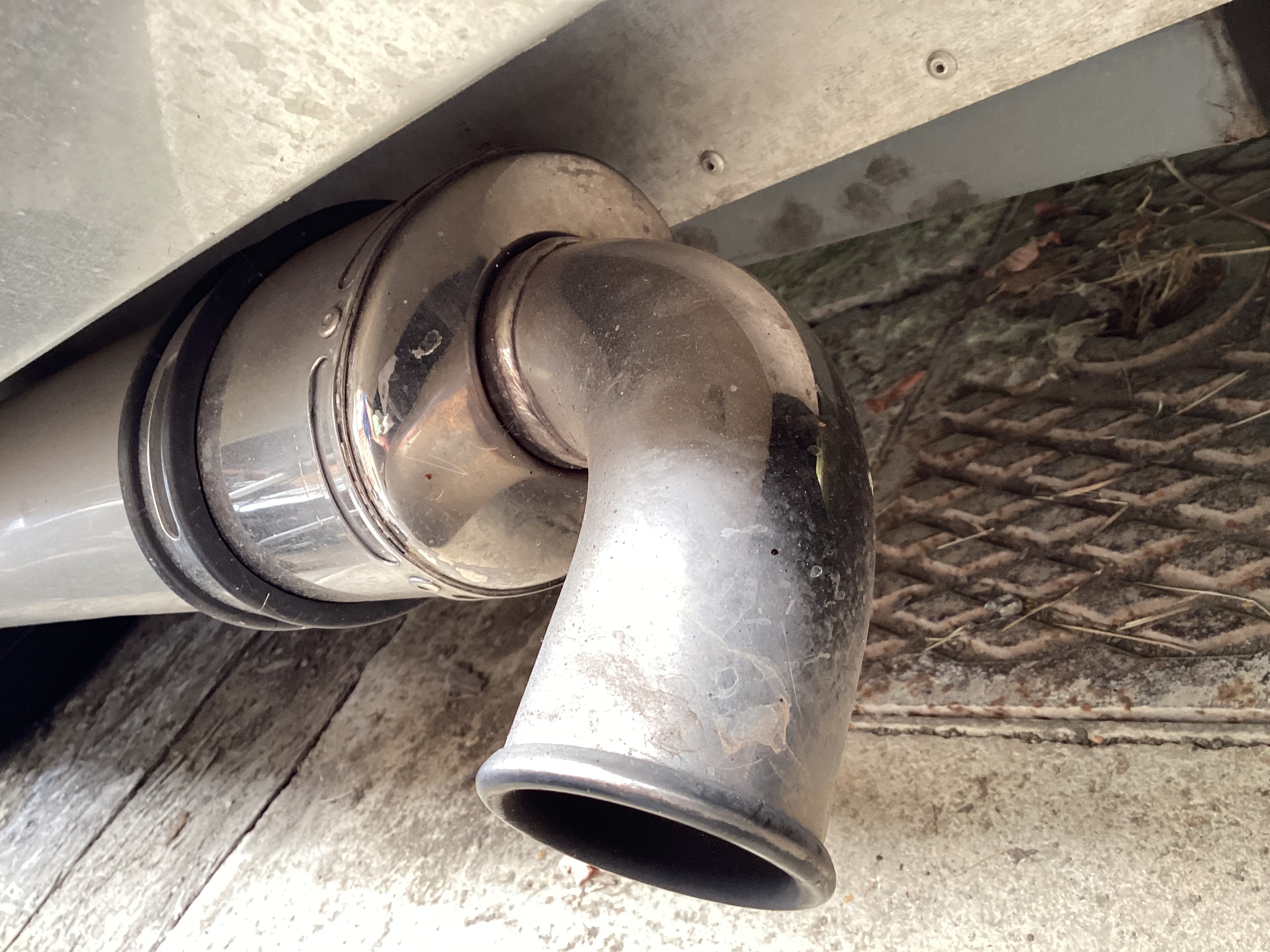

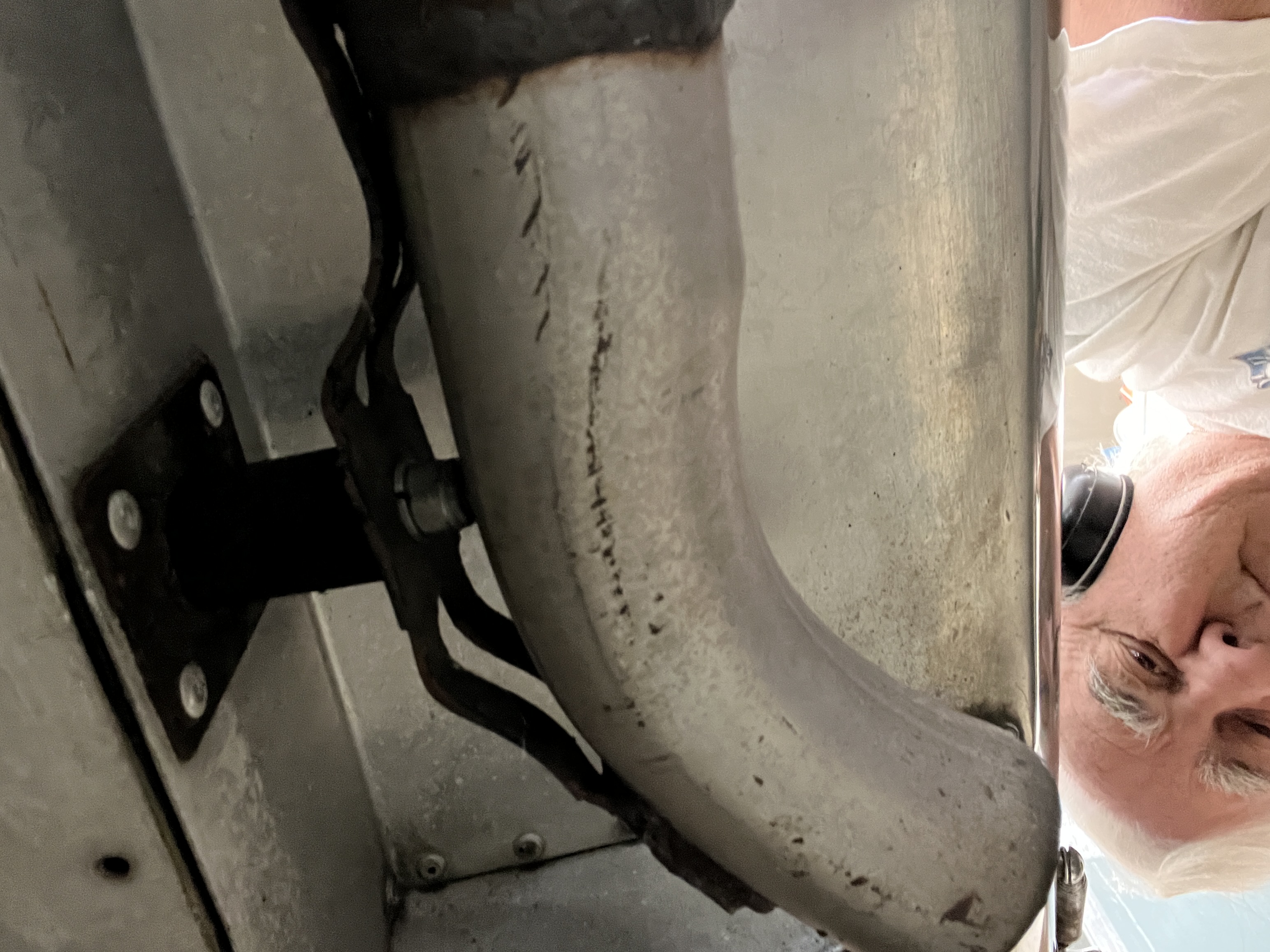

My most aft muffler mounting is attached to a rubber vibration isolator, screwed into the chassis. Properly done, this is all that is needed.
This example of Westfield 11 is a flat alloy floor model, with over 55000 miles.
Shown is the muffler, side view and view of the welded on exhaust pipe bracket and the vibration isolator and chassis fitting riveted into the chassis. The riveted plate has a nut welded to the back side so that the vibration isolator is easily replaced. This isolator os 15 years old,
and is in fine shape.

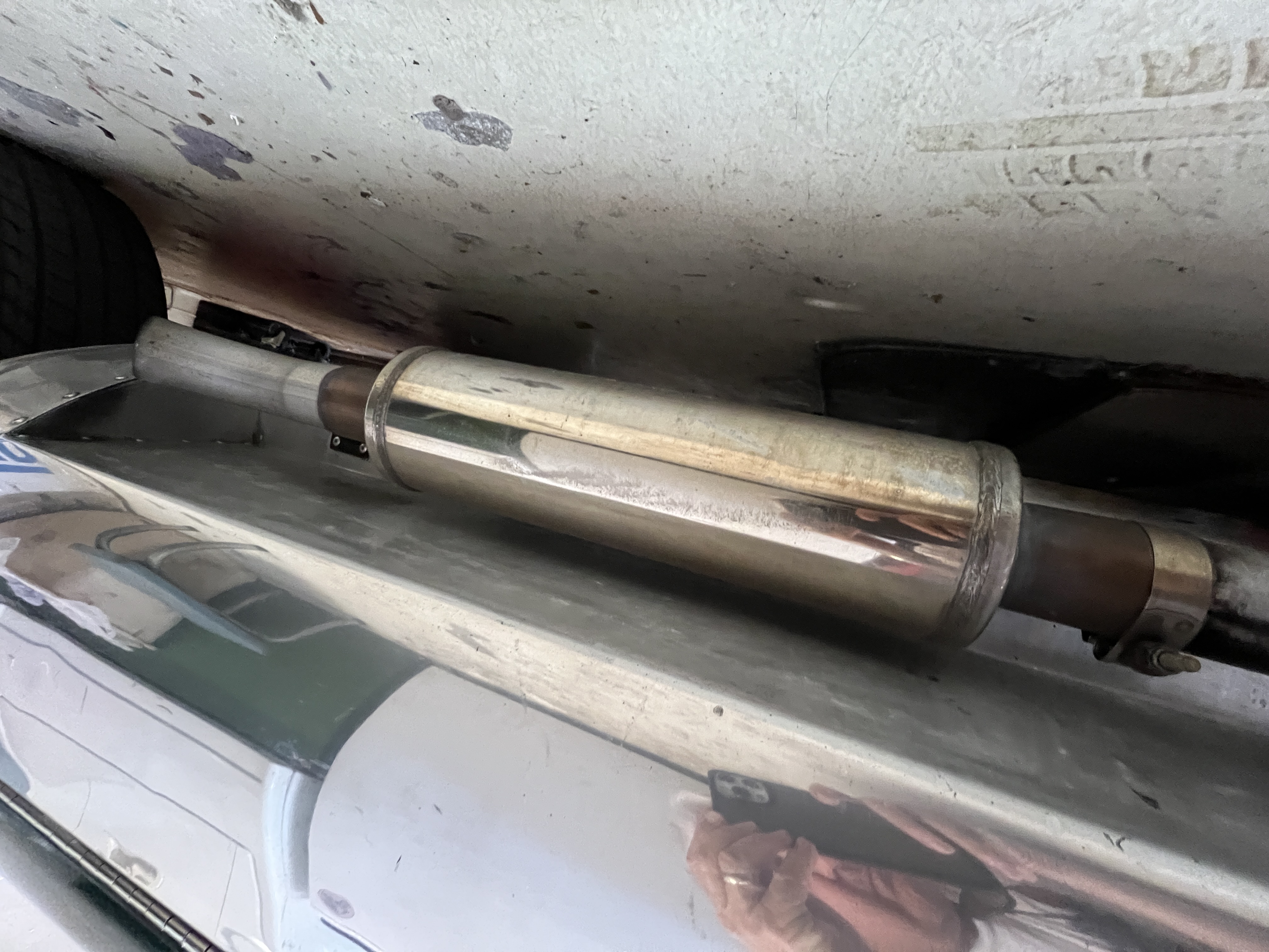

Here’s mine - standard fit. No clattering!

The tab on my car broke off. I replaced it with a flat plate and a nut welded to the backside. A hole was drilled to accommodate the nut, and the part riveted into the chassis. The stand off is a vibration isolator. I forgot what the length was but the thread is 1/4" or 5/16".
The bracket on the exhaust tip is a bit of a bother, but I do have a good muffler shop that has reasonable rates. I just took the muffler down to the shop and had them weld on the bracket from the old exhaust.

I took the silencer off this weekend and did a bit of fettling of the "p-clip" bracket. I also noted that the exhaust clamp didn't manage to stop the silencer rotating around the input pipe. So after the requisite amount of polishing, I re-assembled. I greased the thread of the pipe clamp and changed its orientation so it should clamp better which it did and stopped the rotation.
So that's all fixed - the silencer doesn't move at all now. Fabulous.
However, in my endeavours, I discovered that the innards of the silencer were loose and clanked a lot when knocked. I suspect this was actually the crashing noise I was hearing! It was far too wet to go for a test drive yesterday, so we'll have to wait and see.
Looks like I have fixed a problem, but possibly not the problem I was intending to cure!
