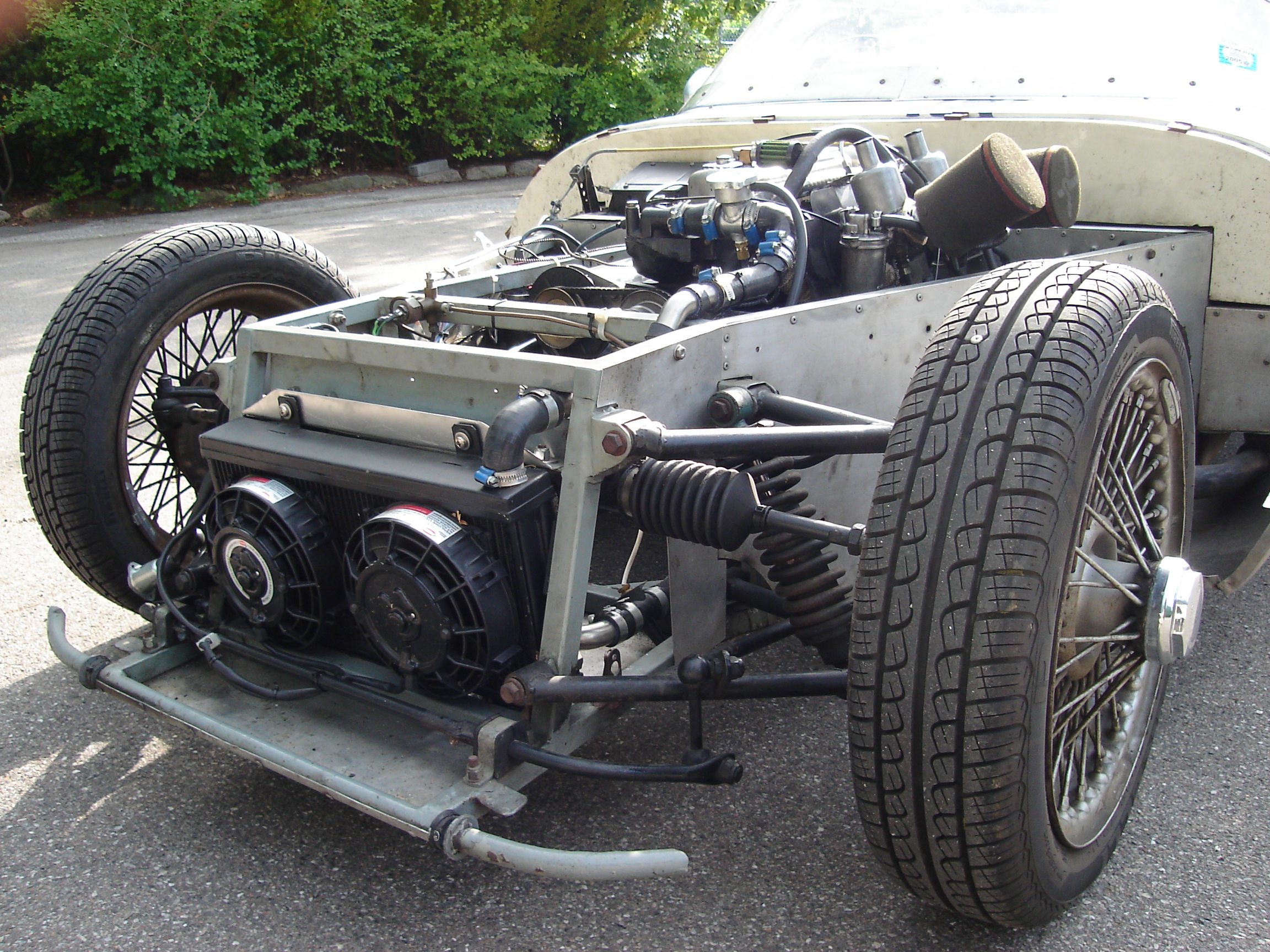

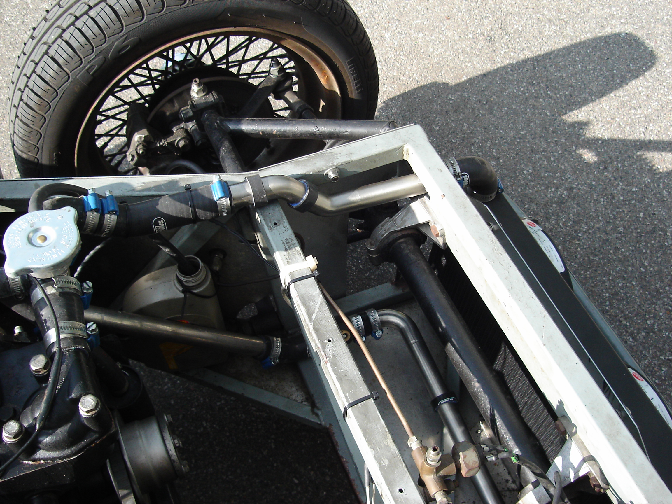

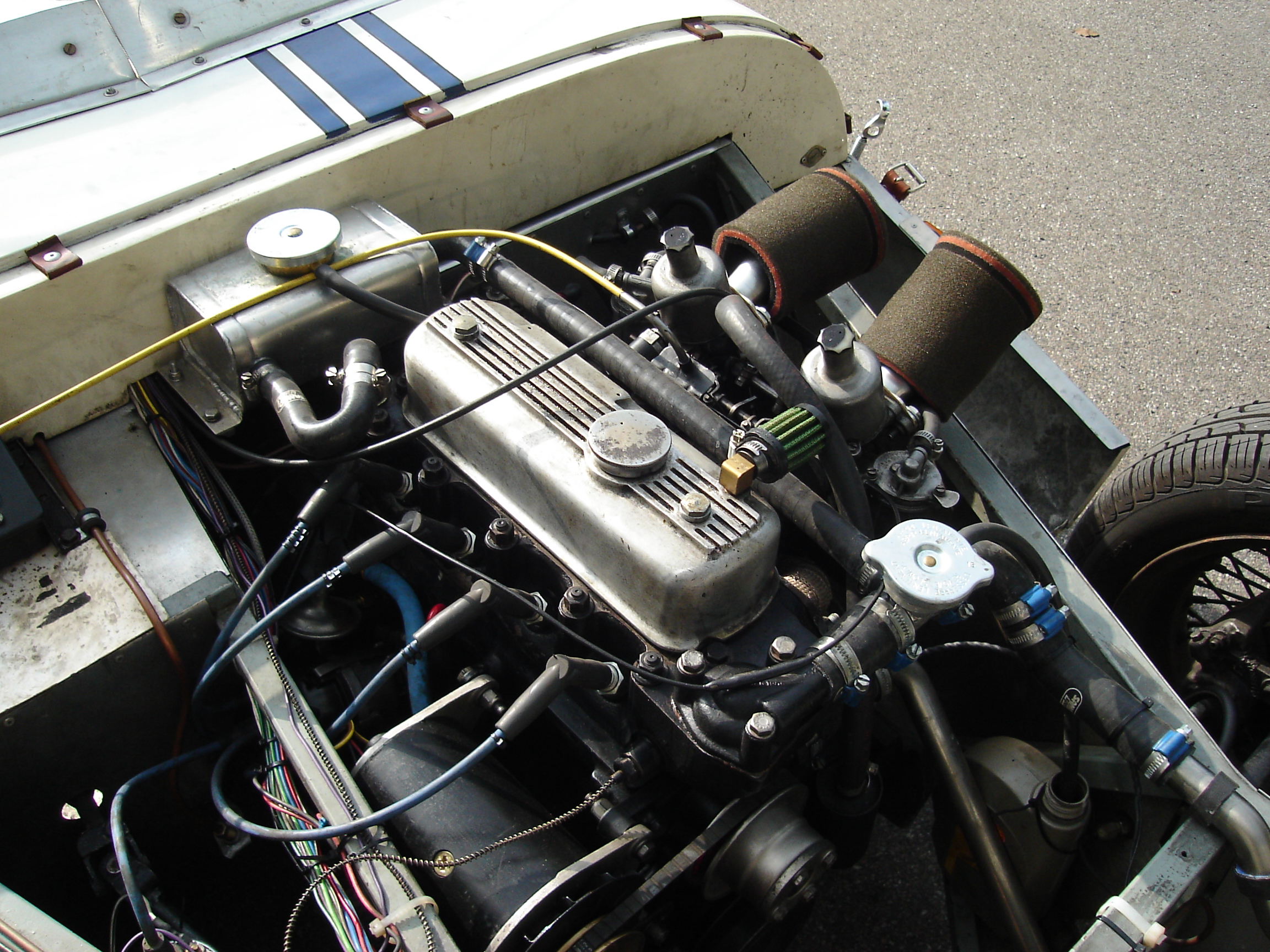

Having taken the camera out I had to take some more pics. so here is the radiator, watertank, stainles pipes and Samco hoses
[attachment=2]DSC00006.JPG[/attachment]
[attachment=1]DSC00007.JPG[/attachment]
[attachment=0]DSC00010.JPG[/attachment]
