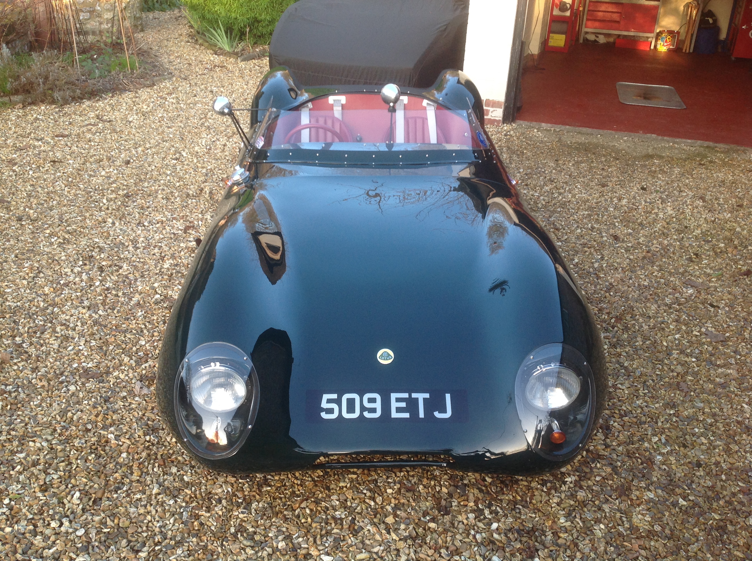

I'll start with the misformed front clip. I hope that I won't cause offence when I say that it initially looked like my car had suffered a stroke! A light mild-steel frame provides a little rigidity and has pulled the face straight. I think that these photos illustrate the point:
Droopy!!
Droopy!!
Before and.......
Before and.......
......after.
......after.

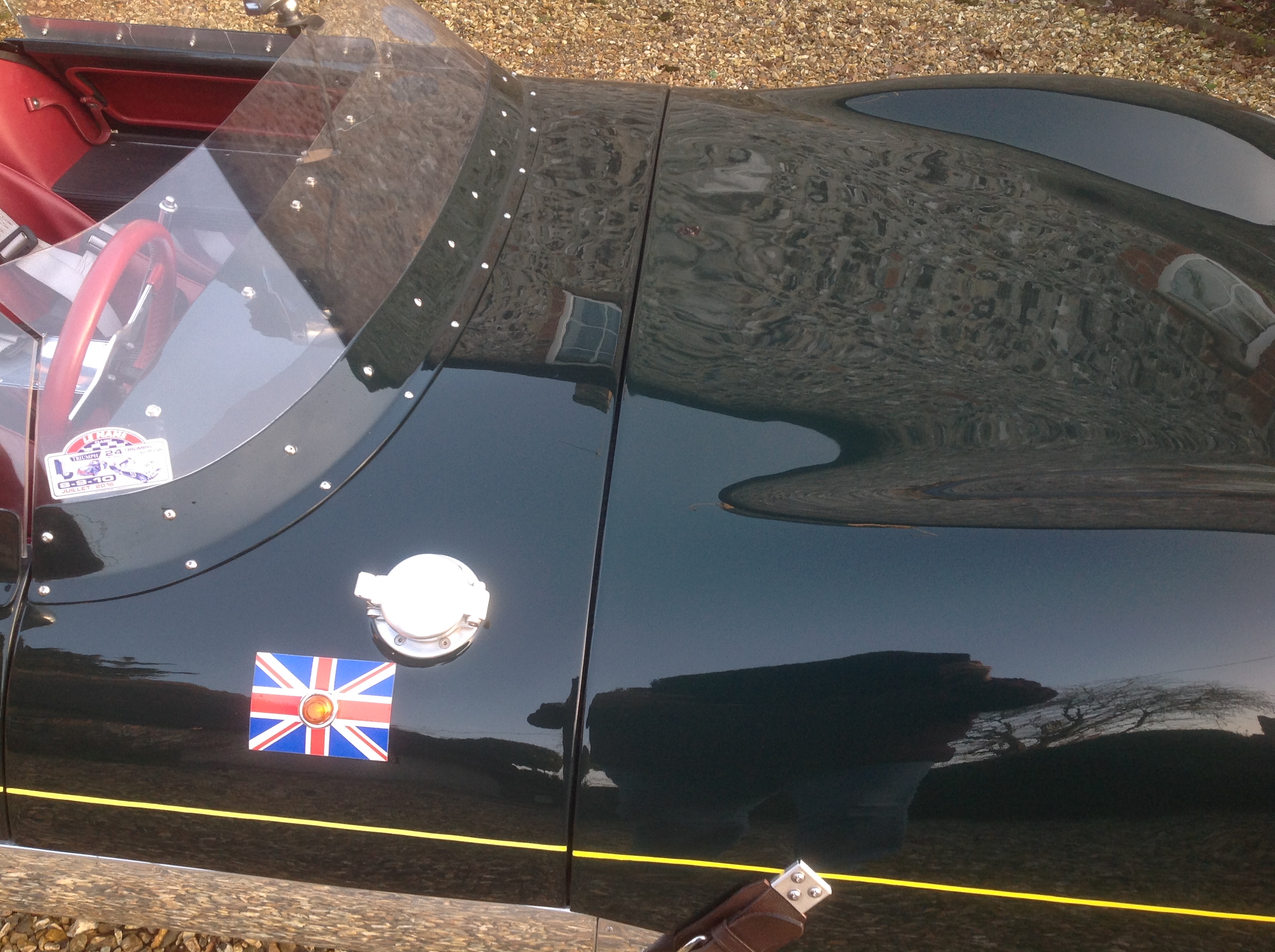

I've never deliberately taken photos of the trailing edge of the front clip; it wasn't a feature that I'd wanted to draw attention to. The shutline varied from Rizzla paper to thumb thickness. But the first couple of shots were taken just after I'd stripped the carpets out and polished the tub and give some idea of how poorly it fitted. The third one is the "now" shot. If you click/tap on any of the photos then they'll expand to full size. Only then will you see the black-anodised Dzus fastener at the centre of the trailing edge!
Mind the gap!!
Mind the gap!!
Almost good!
Almost good!
