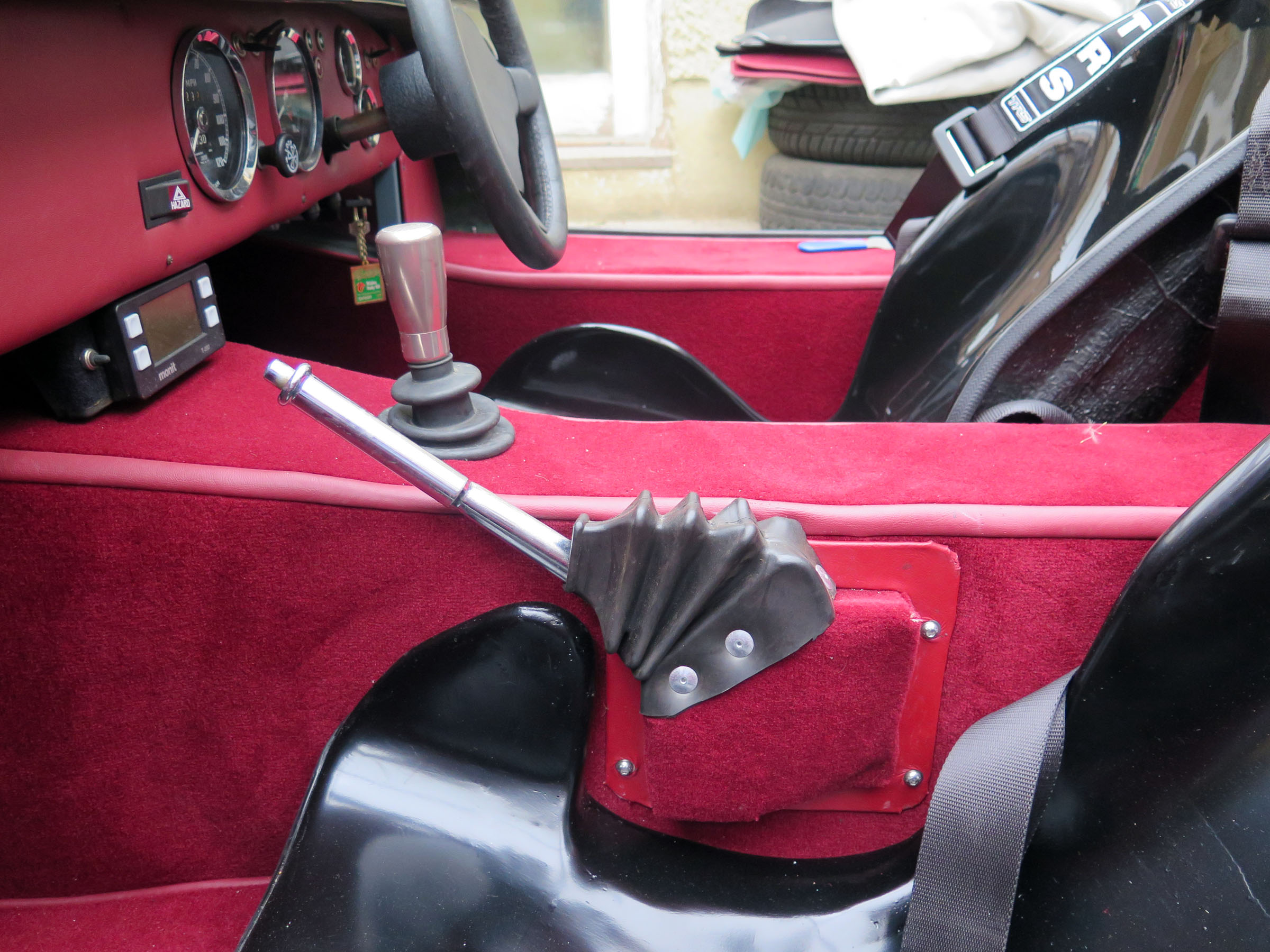

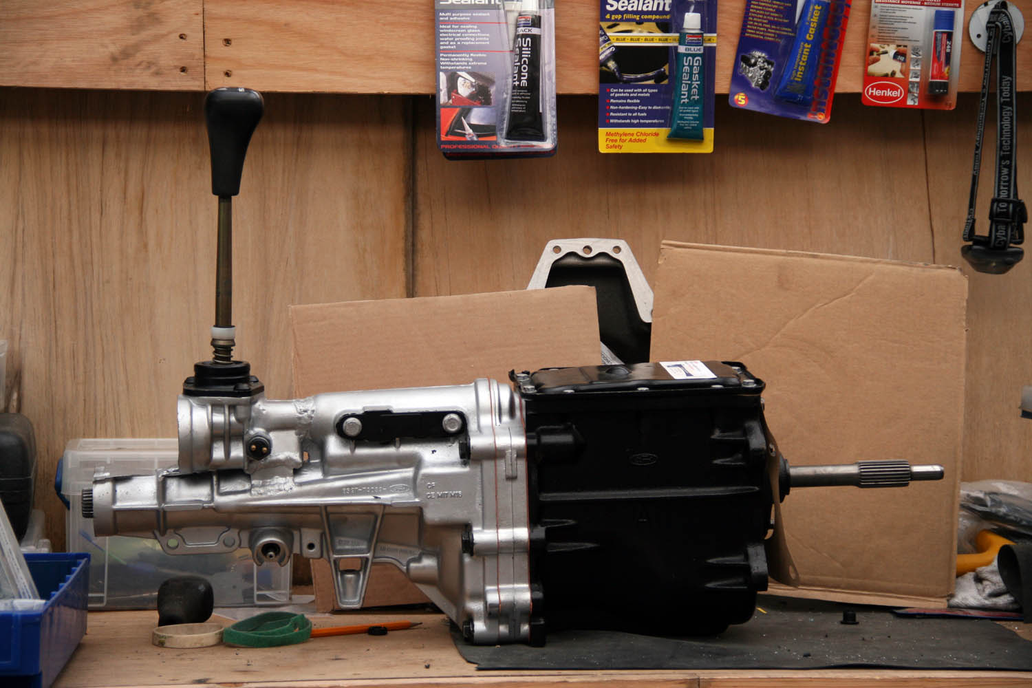

I had my gearbox modified with the raised first gear at First Motion Transmissions. An excellent engineer and really good to deal with. I also bought my rose jointed quick shift gear lever from Paul - works really well with short positive movements.
I further asked for the tail housing to be shortened. When you get your kit, you will be supplied with a transmission top that has two holes in it. The front one is to suit an MG gearbox, the rear one the Ford Type 9. I had the housing shortened as far as it would go - approx 85mm - which moves my gear lever to be in line with the steering wheel and feels absolutely right in use (see the first image). You can see the distance that it was moved froward in the second image.

I never had a problem with the gear lever position in my cars using the Type 9. However, a longer lever is useful if you are going to use the short throw shifter (Who wouldn't?) for a bit of extra leverage to change gears.
