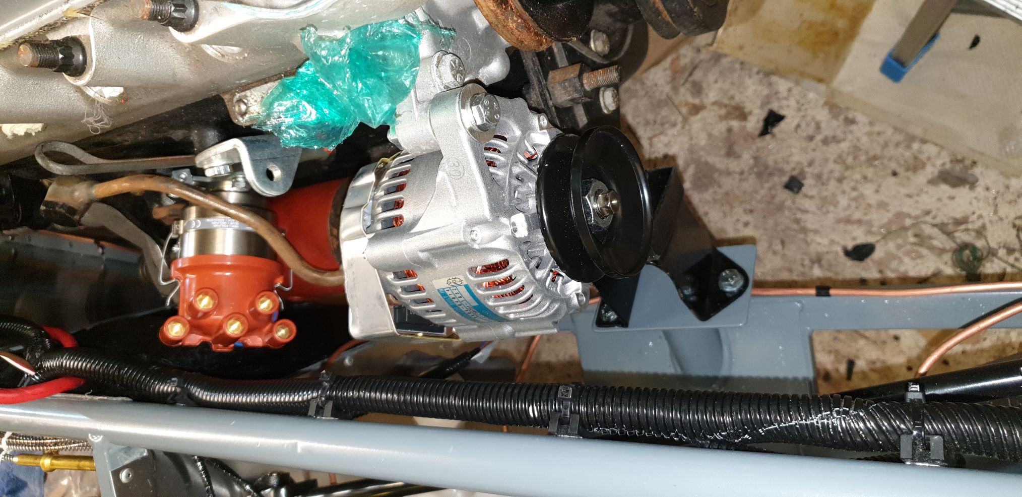

I fitted a 40A Denso, even though it's small it was a tight fit because of where the main 12V output stud is located
I didn't have any problems with battery terminal clearance with the alternator I listed. I believe that it is an ND 40 equivalent. From your picture, you don't seem to have a problem as well. 'Looks just like mine.
There is at least an inch of space for the installation, maybe more. Plenty. This was a lot easier to fit in the chassis than the old Lucas and required about 15 minutes to do the hand filing. With the turnbuckle, it is very easy to do the belt adjustment as the tension can be set with fingers (left and right hand threaded hex and rod ends) and then the jam nuts are tightened. I recall that I ordered my hex adjuster, jam nuts and the rod ends from a UK race supplier at a very reasonable cost.

Zei220 - you will probably need to shim or remove some material in order to get the belt aligned, if the later there's plenty of material in the alternator to allow for it. You can see on mine where I removed a few mm from the upper mount. I used one of these as the adjuster https://www.ebay.co.uk/itm/Vauxhall-C20 ... SwYlJW6oqR if you look at the description you just need to pick one that has the right length and end fittings for your alternator, again you might have to remove some material along it's length or from the alternator casing to get the full adjustment.

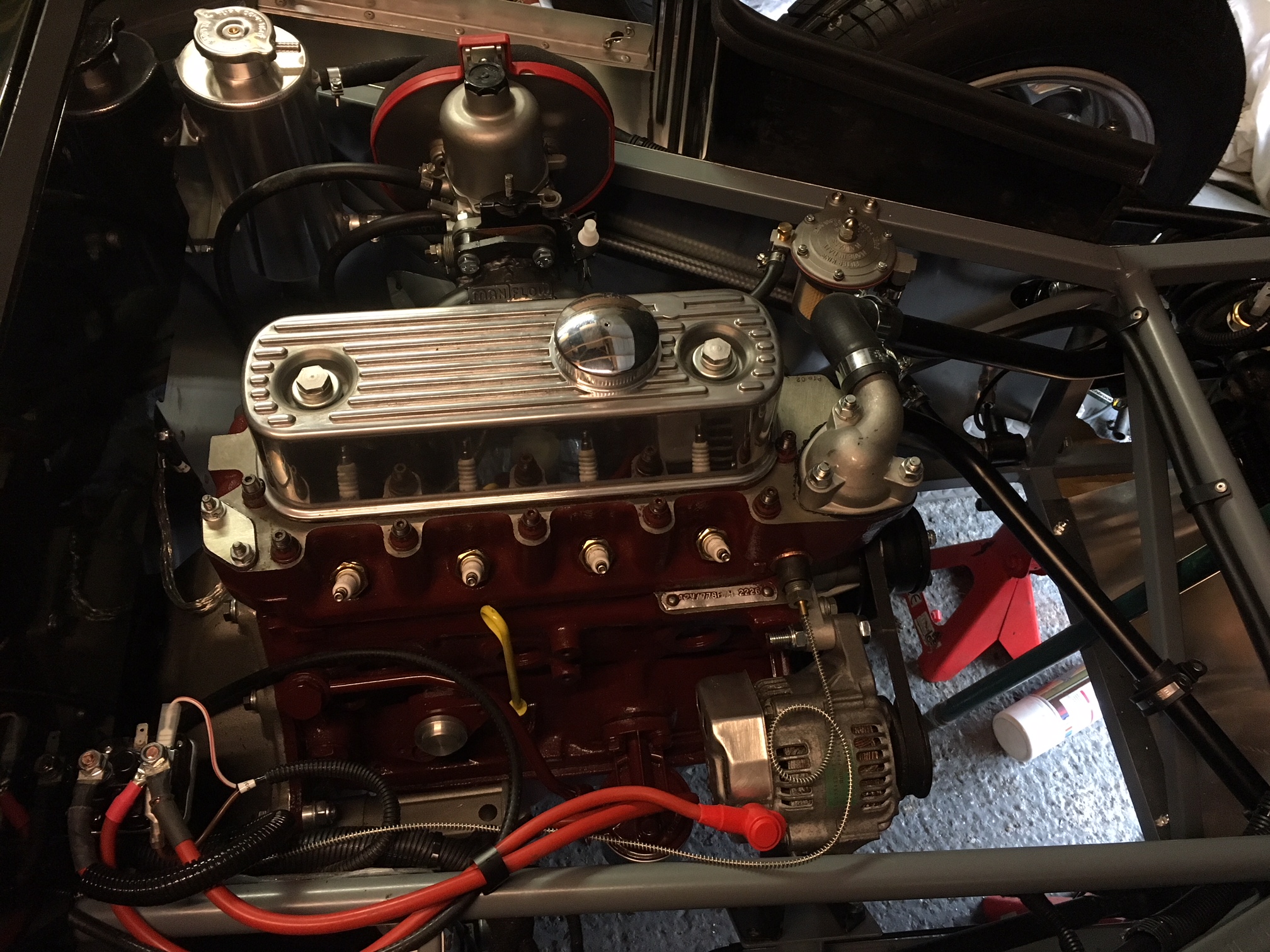

Managed to get the alternator fitted this morning. lots of room now. As usual you guys were right about having to fettle the mounts to get the pulleys to line up. Thank you.
[attachment=0]alternator.jpg[/attachment]
