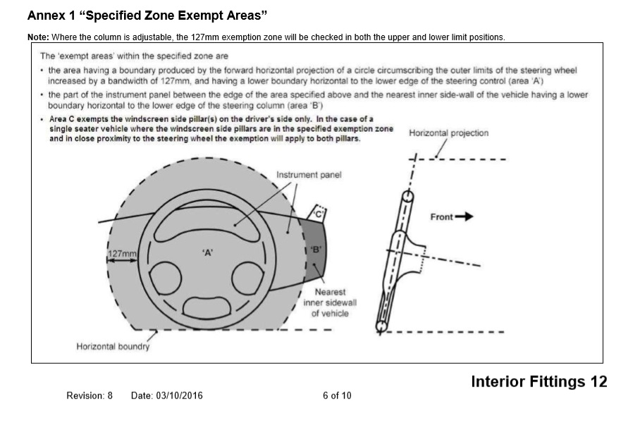

Switches are fine for the IVA as they're in the exemption area A (127mm beyond edge of steering wheel) and B RHS steering wheel
[attachment=0]IVA Steering Wheel Switches.jpg[/attachment]

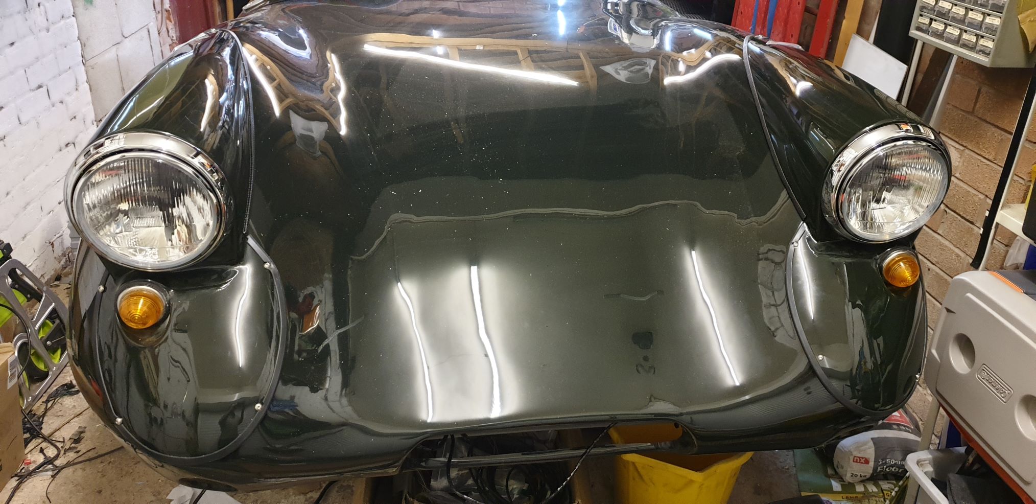

and I agree, the headlight pods are definitely ugly.

Did I say just how ugly the pods are...... I've just bolted them on knowing they will be coming off as soon as possible after the IVA test.
[attachment=1]bonnet 1.jpg[/attachment]

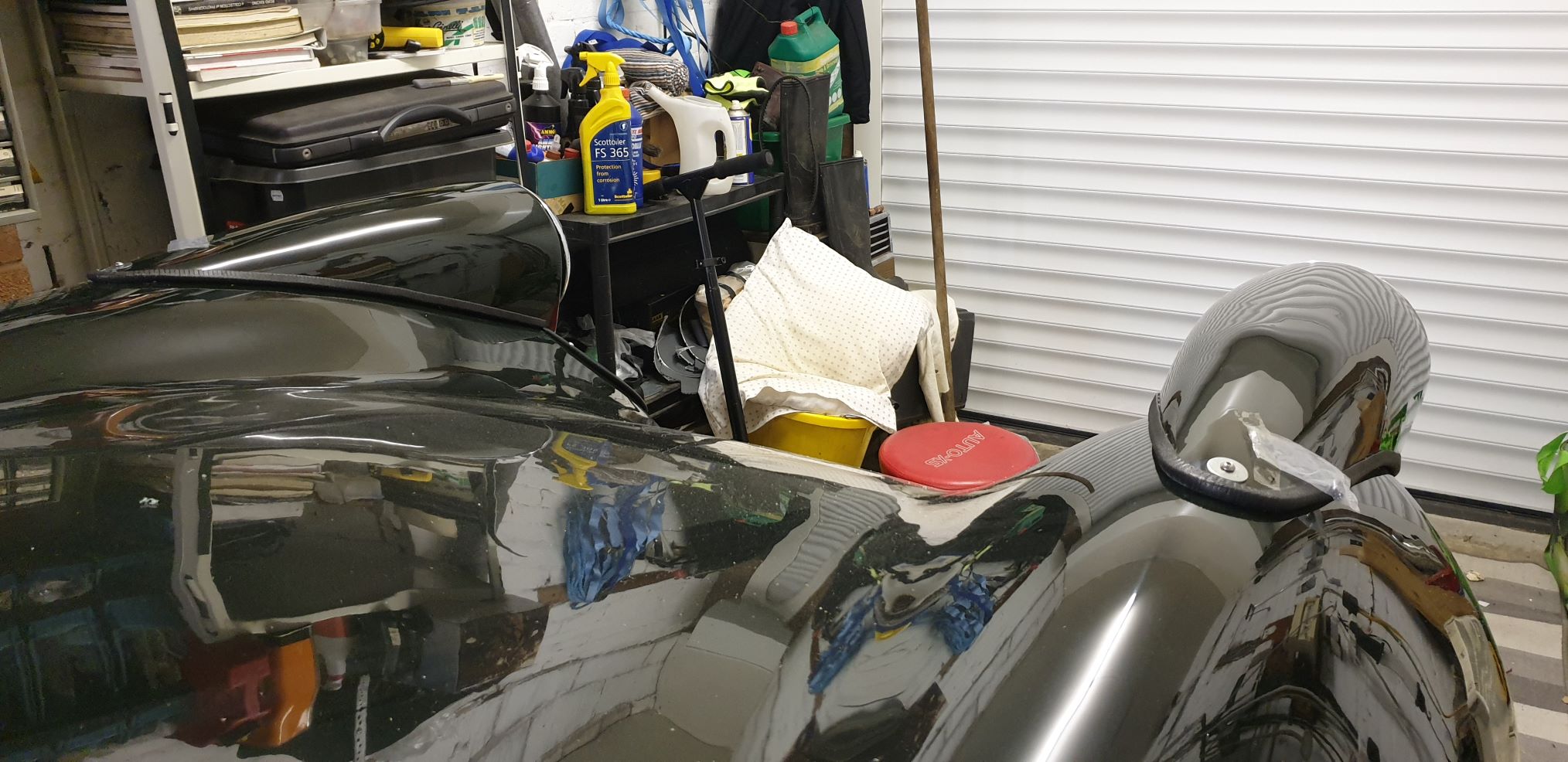

[attachment=0]bonnet 2.jpg[/attachment]

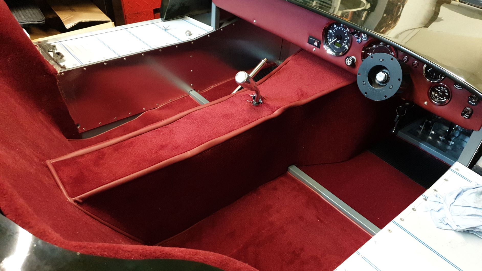

Some carpets.. looks a nice place to be.

I changed the carpets slightly in my last build.
The top of the tunnel cover carpet was separated from the tunnel carpet and attached with snaps. This made it easier to remove the top carpet and the transmission cover for service rather than having to remove the entire tunnel portion of the carpet that may have been glued in place.
I also cut a hole for the transmission filler plug so that the level could be easily checked without removing the carpet.

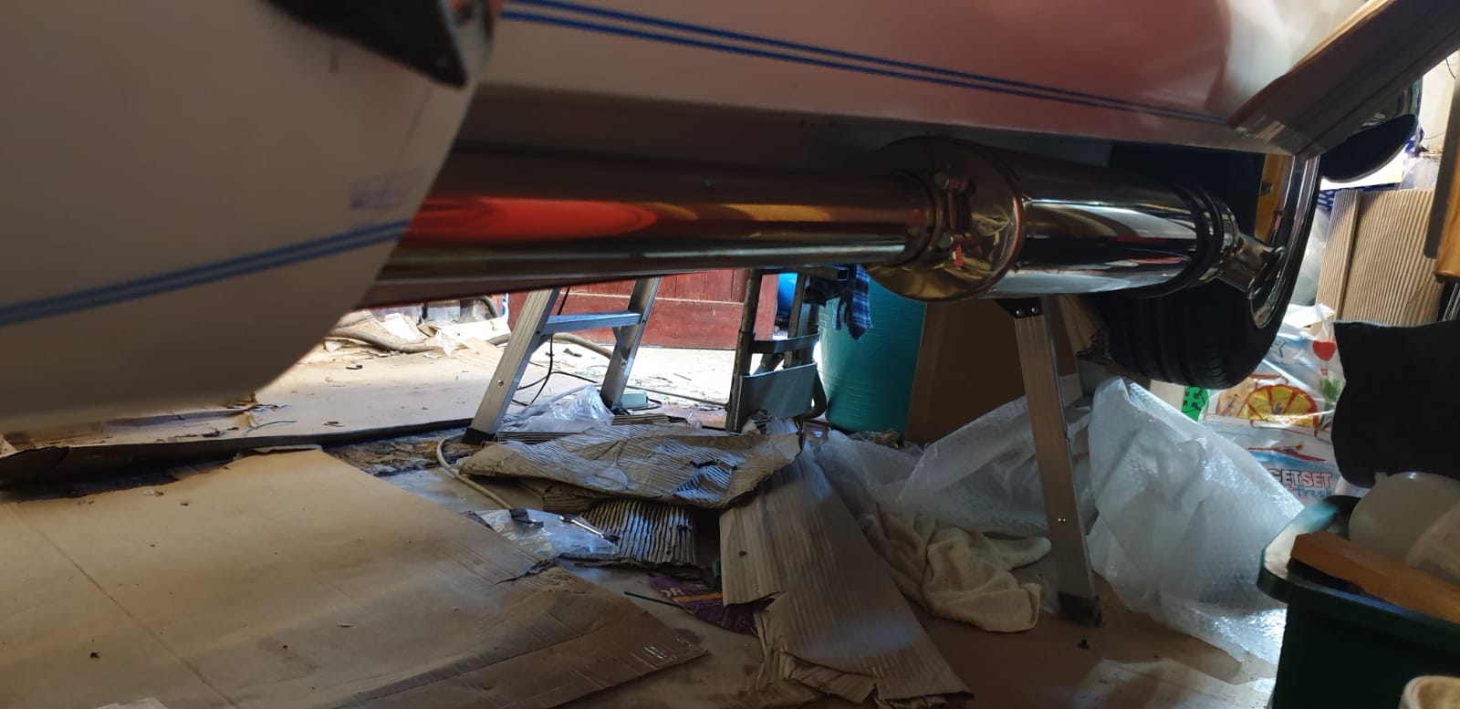

OK, its time to drop it off the stands ... exhaust on., it was surprisingly easy to fit.
[attachment=0]exhaust.jpeg[/attachment]

Are you going to align it next?
If so, you need to put your weight in the driver's seat to set the ride height, camber and toe-in. Make sure that you have settled the suspension.
