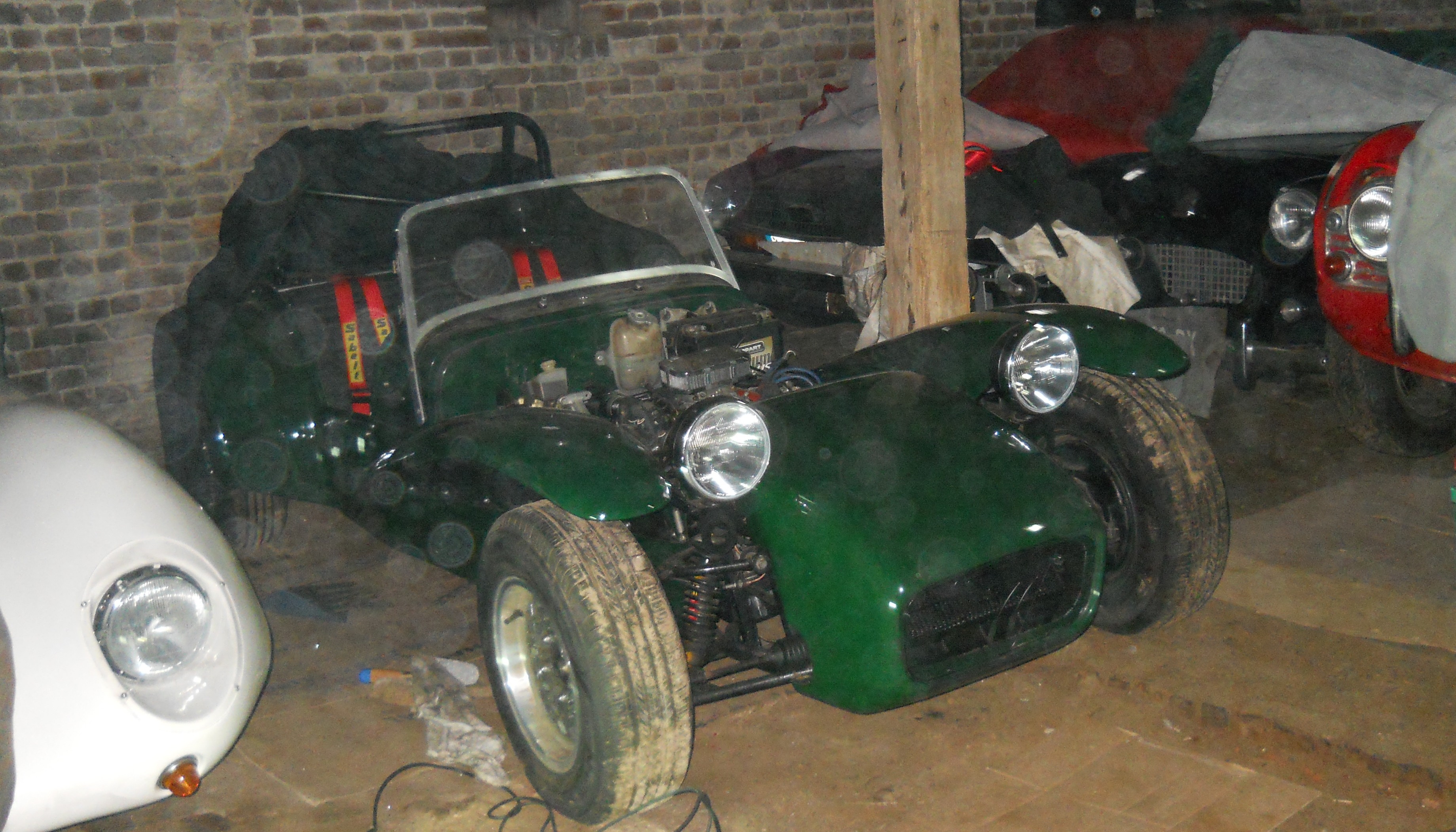

Hello guys,
Due to work commitments, I still haven't spent some time on my Eleven.
Most of my spare time is spent on my Pre-Lit Seven, who will soon be ready for our local MOT.
In the meantime, I've takenthis picture of one of my "sheds", hope you will appreciate.
Regards,
Chris.
