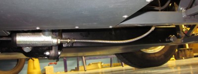

WRT the sump drain, you can have it placed anywhere you like. I wanted to keep a clean base, and hence the side mounting. The clutch slave on one side and the chassis rail on the other both preclude the drain plug being mounted there. Here's a scenario: bonnet off, oil tray in position, back jacked up, and just reach over the tyre to let the oil go - and to spin off the filter. Better still if you can jack the rear nearside on a small quick-lift or something.
The access to the sump bolts is indeed made more fiddly, as I found out while lying under the car with my nose a couple of cm away from the sump and my reading glasses not man enough!! :D Actually, it was :shock: I suggested earlier that you would be better off installing this on a ramp or over a pit. You'll want to completely degrease your engine to squeaky-clean before removing the sump. I'd suggest that 30 mins of ramp-time would be money well spent, unless you are able to raise the car up a couple of feet on your stands. We've got a couple of race-car hoists planned to lift my car high enough to allow ease of access to the bolts. You can get in there with a spanner or slim socket if you can just get your body nearby (and your eyes work well enough at close range!). Toy can see the clearances avaialbe from my earlier dimensioned pics.

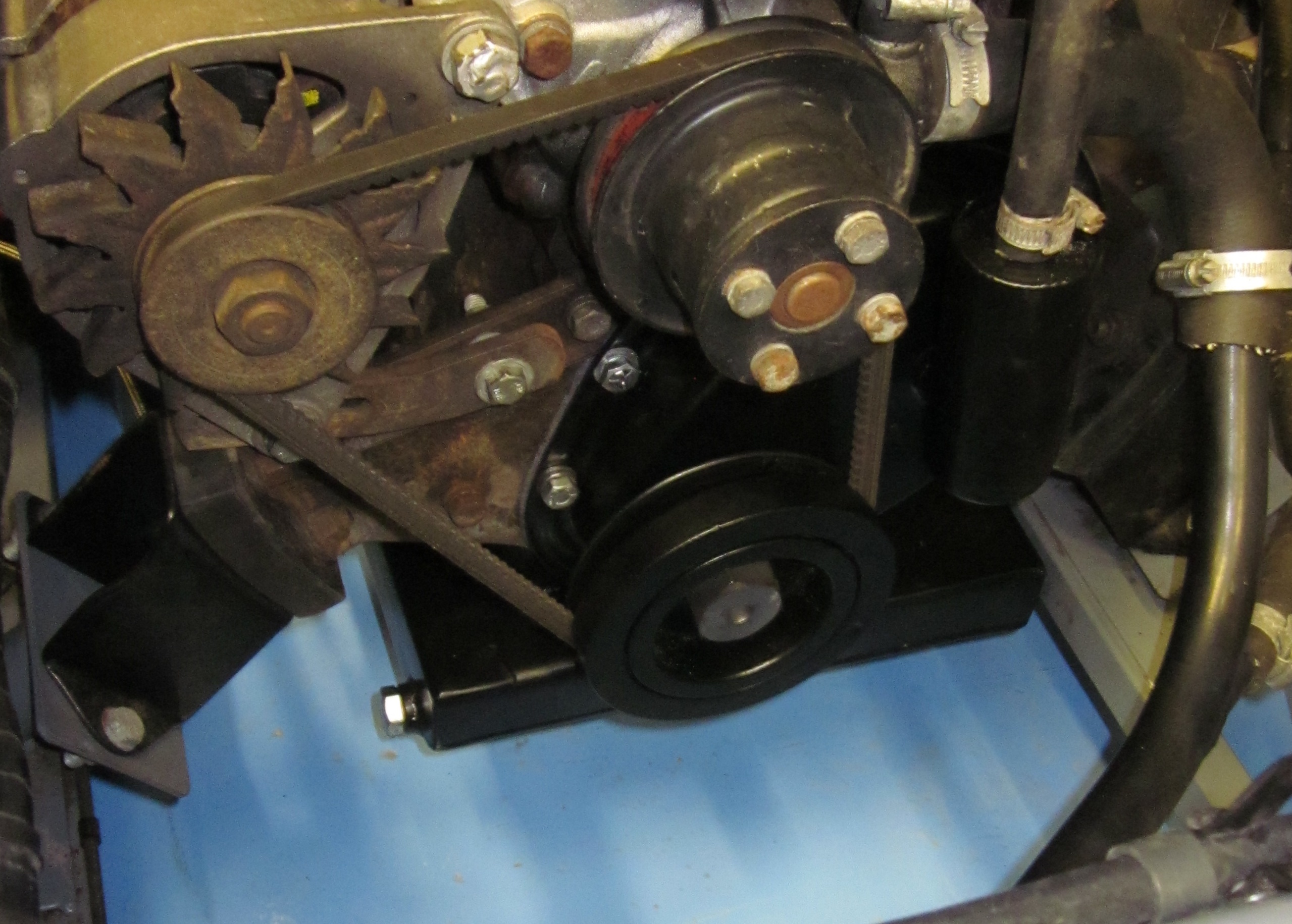

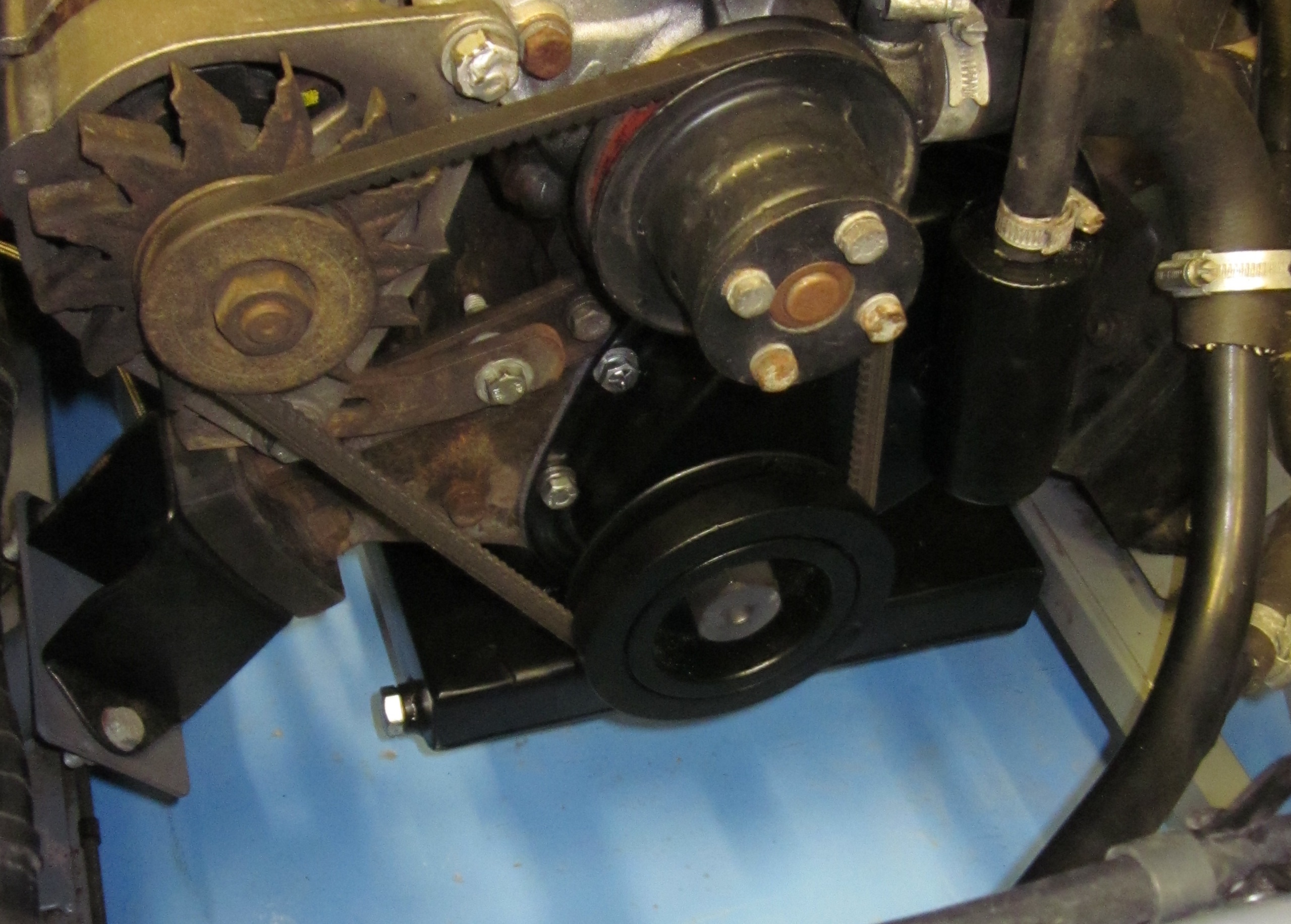

Here's along-overdue update!!!
I have the sump now fitted and the engine running. Full oil pressure while stationary.
I just need to change over the crank pulley back to the original (the nicer looking of the two I have, post-painting doesn't appear to run true) and then take it for a run around a roundabout both ways and test running, hot, oil pressure under manoeuvring.
WRT fitting, you will need to reverse some of the engine back plate nuts, bolts to ensure clearance. Otherwise, it all seemed to be fitted without drama. It is fiddly, though, so I would highly recommend a lift to gain access.
The production items will be utilise your original sump plug. Strictly ONLY SOLUBLE media will be used to basting prior to coating in satin black. You will need to check that the sump is free of debris before you fit. There should not be any, as they will be soda-blasted and rinsed prior to coating - but do check!
If there is a demand, we can develop a bolt-in windage tray as well. Gary said it should be reasonably simple to do - we have a block and crank/piston set at the workshop to set the height of the windage tray during assembly. Any thoughts?
Here are the pics taken a couple of days ago.
BTW, I'm currently having a data meltdown with a failed SSD, so apologies for the slow progress. Words to the wise: Do a back-up today!!! :shock:

Update:
I went out for a longish drive today. Oil P stays put under cornering and braking etc.
However, I found that the oil P gauge followed the revs. GIven some WOT, the oil P rose to nearly 100PSI as the revs spun up. Conversely, the hot oil P was down at around 15 PSI at idle at the end of the run. I did not have oil P fluctuations like this prior to the sump going on, but there again, I have used some sacrificial stunt-oil and the old filter.
I'm only running el-cheapo 20/50 oil as a test for leaks - there seem to be none! Will hot-change the oil now to Halfords Classic 20W50 and change the filter. I can also pick up a new pressure relief ball, uprated spring and washer for a few quid locally. The 1275 Mini items have the same part numbers and are available from Somerford Mini.
