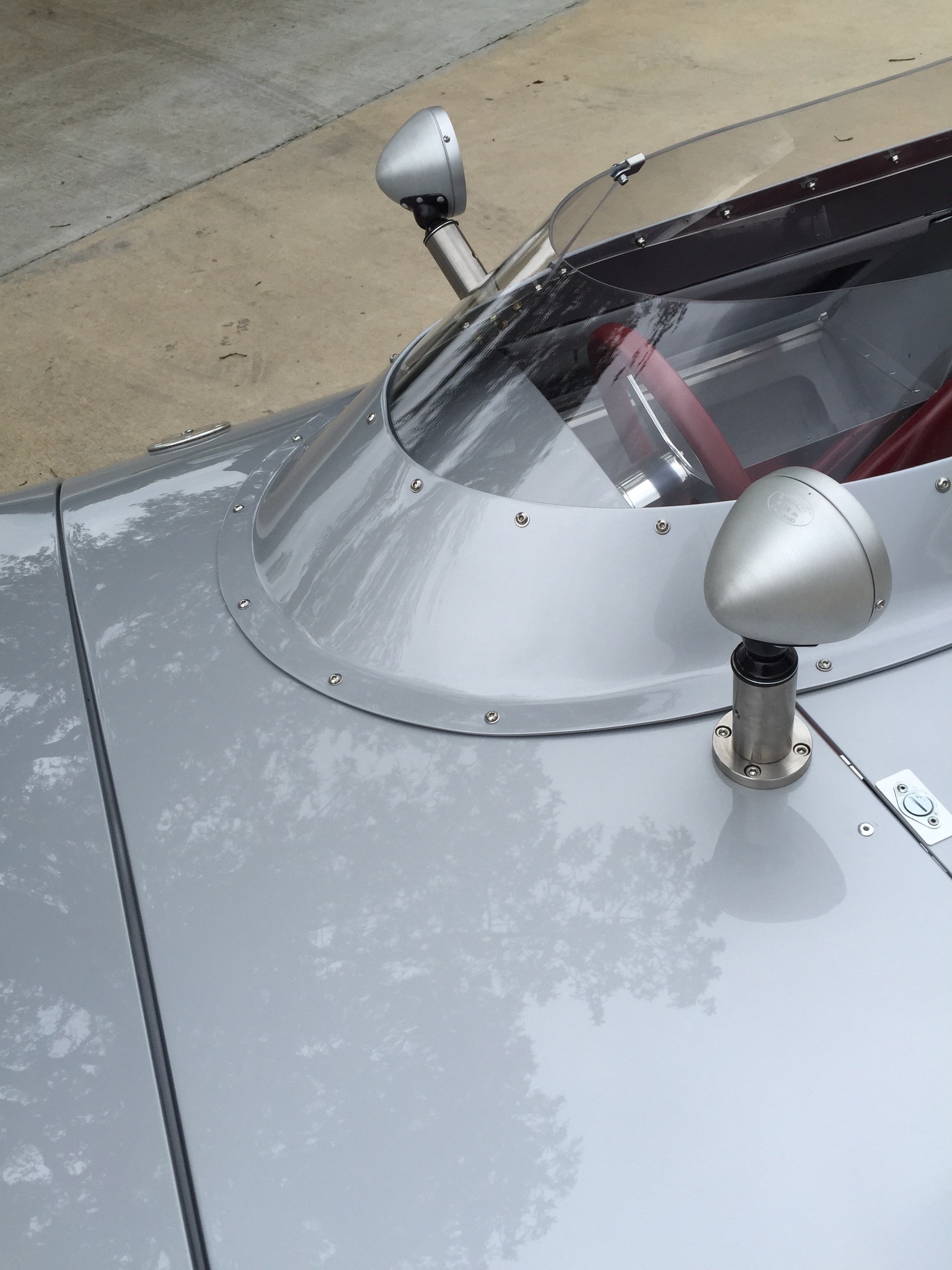

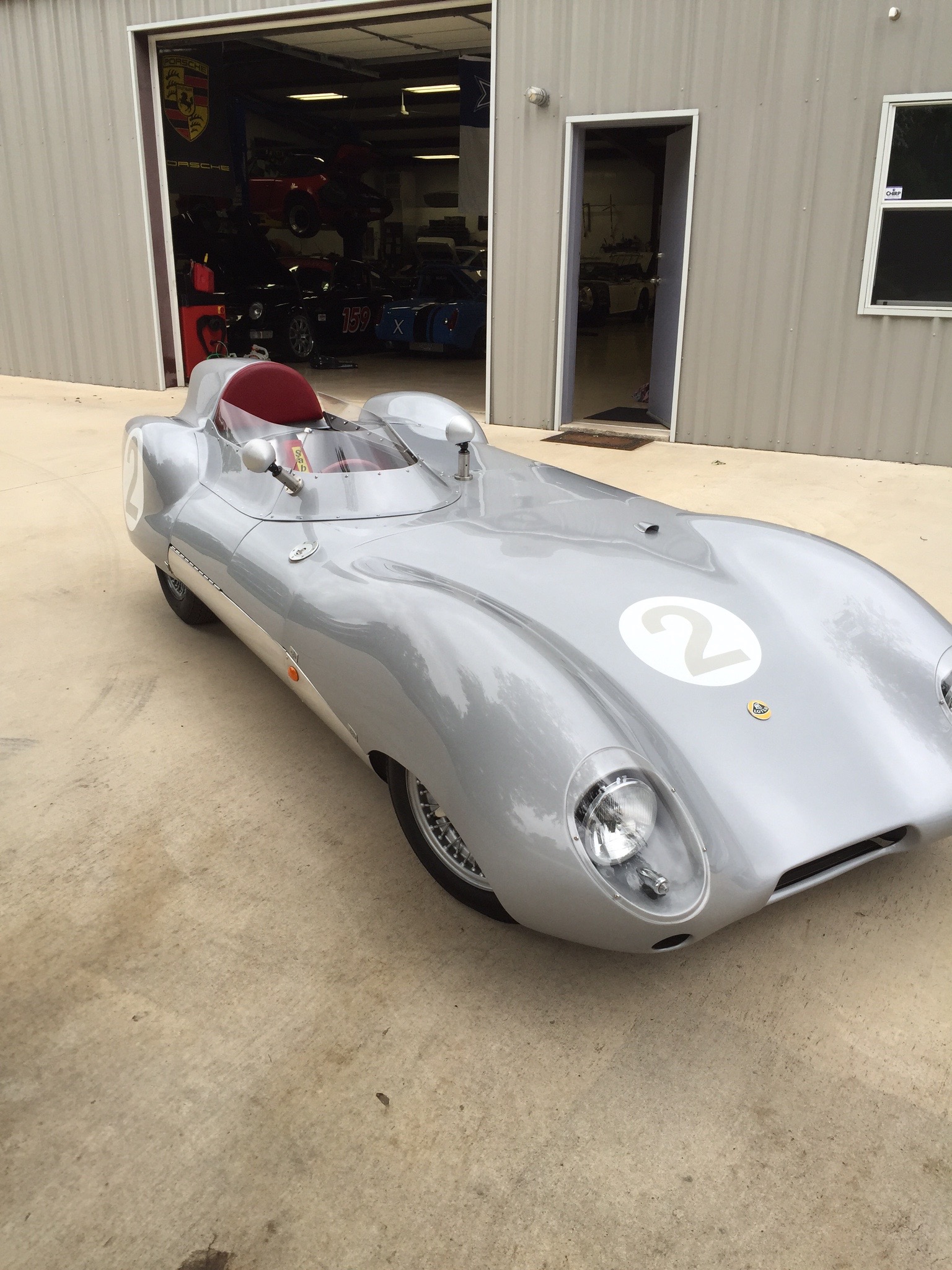

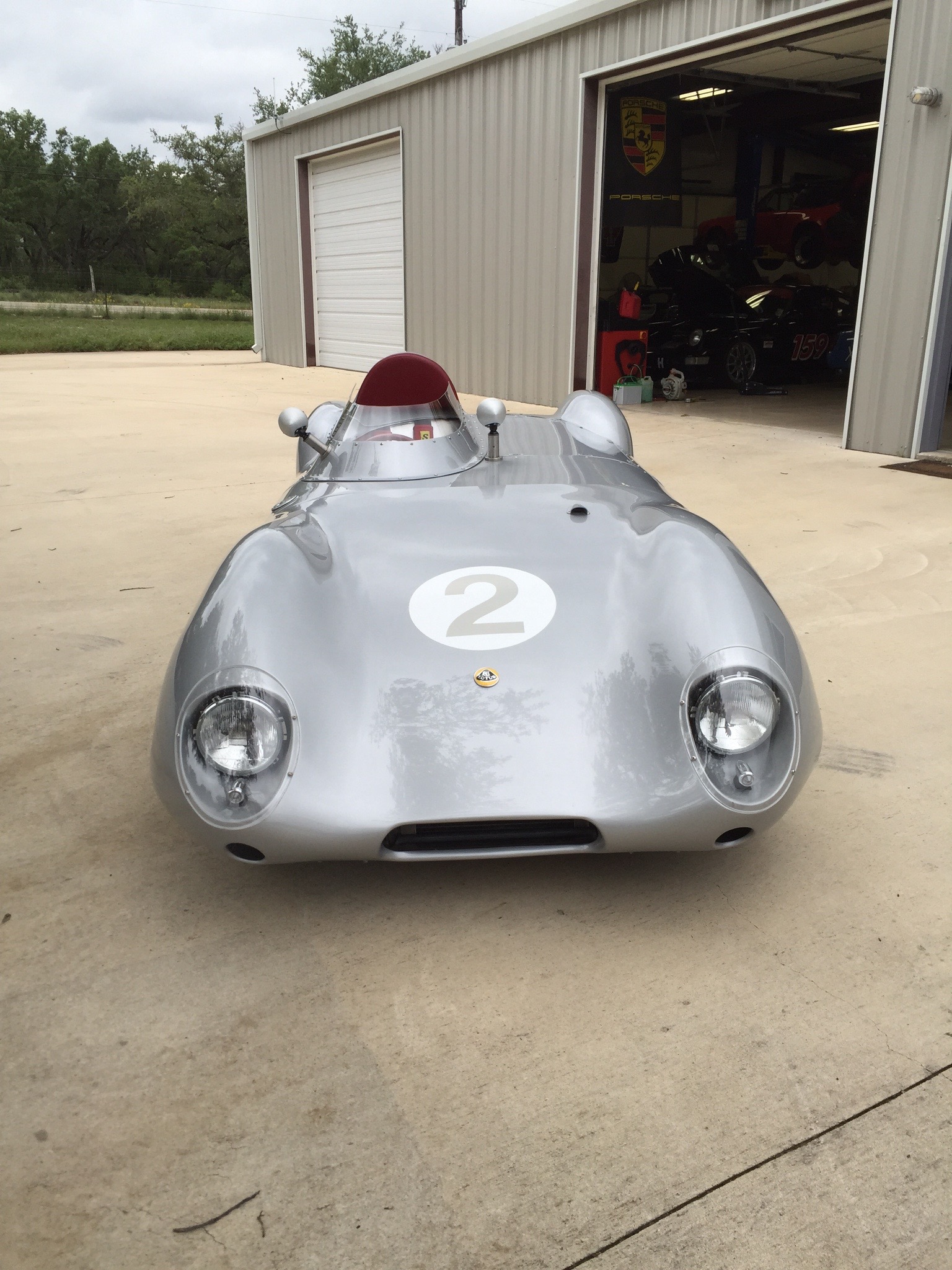

It's been a long time since I have been on the forum. I've been very busy with work and vintage racing.
I thought I would close the story on the single cockpit conversion. We actually ended up making the conversion completely reversible between the dual and single configurations. This required custom made detachable door hinges, two sets of doors, two cowl pieces, new mirrors and a phenomenal amount of labor and patience. The fiberglass and windscreen parts from the factory required a significant improvement and trimming to have an acceptable fit and finish. This project was extremely labor intensive and not recommended for the average builder/mechanic. The result was worth it...at least for me.
Attached are a few pics of the final product.
Best wishes and Happy Holidays to all.
Glenn

The finished article looks absolutely stunning and a credit to your determination , it also totaly finishes what
an Eleven should look like . However just from the photographs , as much as I would like my car in that configuration ,
I can see it would not suit my physique or level of mobility .
Again , absoluely stunning ! !
Cheers , Bob Whittaker
