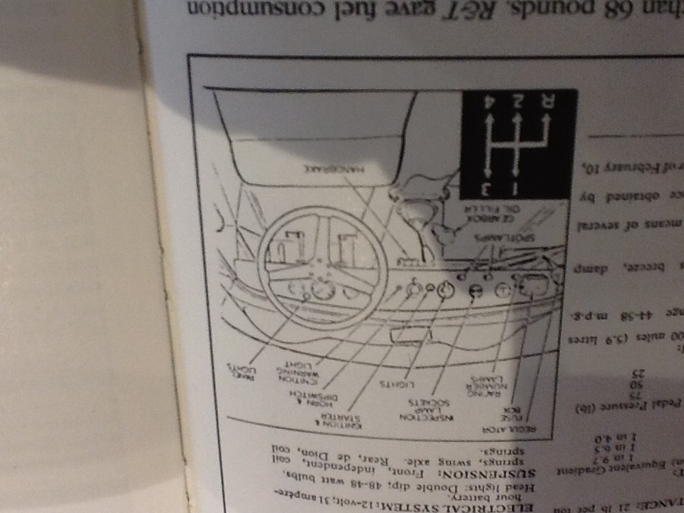

When i made my car i looked at many pictures of 'real' cars and many that were on the current race scene, whilst most show the same general lay out no two were exactly the same. With mine i kind of aproximated to get the general layout. You will find that on the westfield the column goes through the dashboard making it impossible to site the rev counter directly in the centre line of the steering column. The sf4 fusebox looks good on the dash if you can run your loom through it. Crude diagram from ortenburgers book.

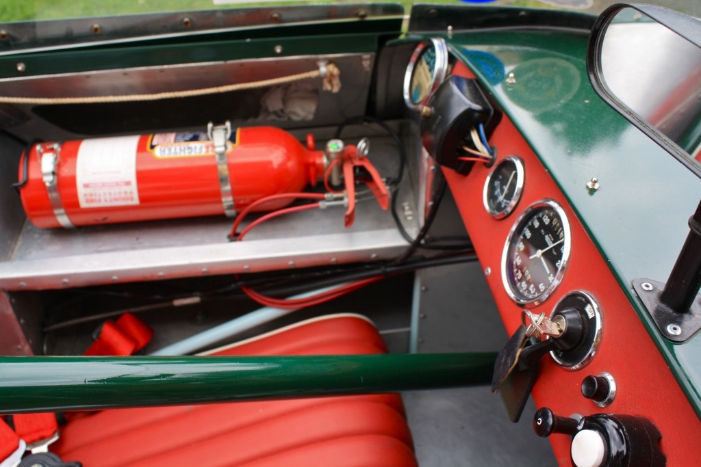

Re: Early dashboard
It's difficult to mount the tach centered behind the steering wheel as the steering shaft tube intrudes beneath it.
A smaller diameter "chronometric" replica tach may be small enough to fit.
My unrestored '56 Lotus 7 Series 1 was built alongside the 11, and had a pull, twist, pull light switch. These used to be quite expenaive, but are now readily available and reasonable in price. I have seen this switch on several Lotus 11s.
Other Lotus 11s I have seen have had rotary thumb switches, with and without integrated key switches.
My last build had a rotary thumb switch I sourced from Vintage Spares (they have everything you need as far as period lighting, switchgear) in the UK. It was a simple sidelight/taillight, dipped beam, high beam combination switch. I used a separate key switch and start button.
Making an instrument panel is easy. You can use your kit's panel for a pattern. Don't bother with curling the edges over the top tube if that presents a problem.
The panel can be attached to the tubes with screws and rivnuts, or pop rivets. Holes can be die punched, fly cut or hand cut with a nibbler if you are using thin materials. Upholstery can be cut and glued in place using spray adhesive.
With most Lotus 11s having been extensively restored, there really is no particular placement of switches, or gauges. About the only thing that is uniform is that the small diameter tach is centered, and there is a dual gauge close by. with the light switch somewhere near the center.

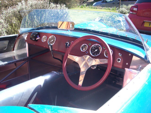

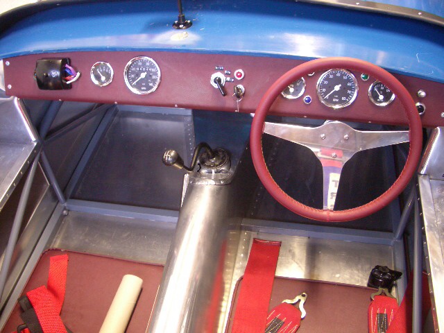

This is mine, waiting for build-in:
[attachment=1]IMG_1591.JPG[/attachment]
[attachment=0]IMG_1592.JPG[/attachment]

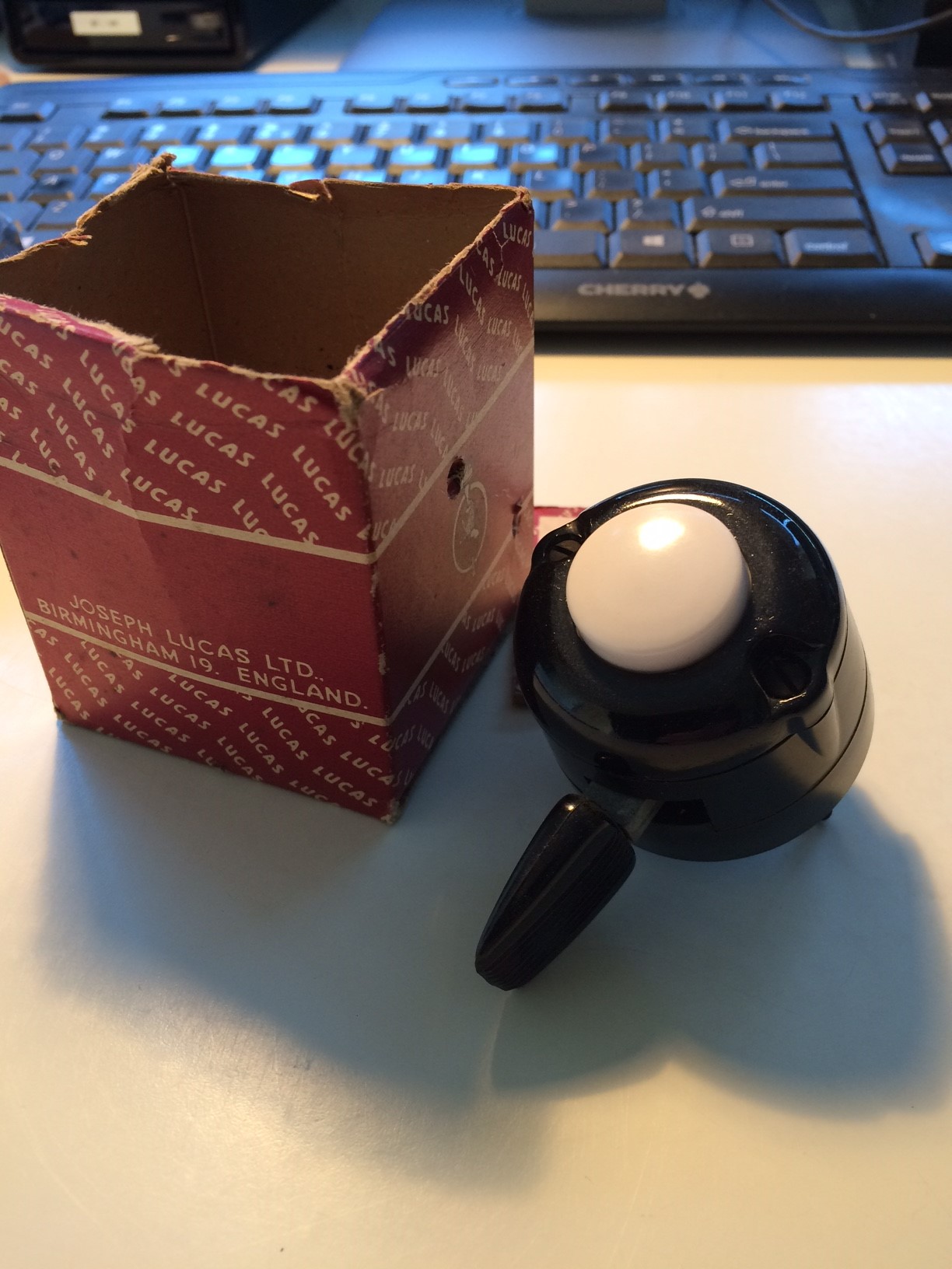

Re: Early dashboard
Is that a light switch, or a trafficator/horn switch?
I have an identical one on the shelf, for turn signals and horn. 'Came off of an old Triumph tR2 (and as I recall, my Grandfather had one just like it on his Austin A40). Three position: Left, off, right.
If you are looking for period switches and lighting, Vintage Spares in the UK has everything electrical that you are looking for. You can always use their online catalog for part numbers and descriptions.
