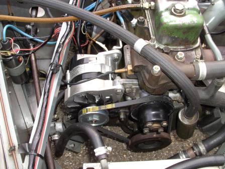

I've also got a newer alternator and not the dynamo, but this was only because I went to poly vee belt. The alternator required some changes to the wiring at the voltage regulator, but I got that from the Web. Relatively simple and I've not had any problems. (and if anyone was going to get any it would be me!)

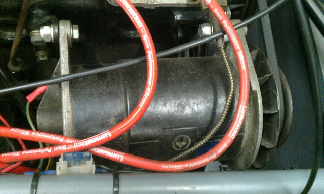

I might look into the high-torque starter, since it sounds reasonably straight forward. I assume that I already have an alternator rather than a dyno...

I use a modern alternator, being the Moss kit for the MG Midget. It works well in my W11, the kit is complete with all the parts suplied, and a good instruction manual.
Re: Uprated starter motor / alternator
I have that same alternator, but it doesn't last long, and is big and heavy. The rectifiers don't last long, at least not on my cars.
When that one fails, get one of the small Nippon Denso alternators. Half the weight, twice the power. You can find them at the breakers for a very low price, and they last forever. Rebuild kits are readily available, and inexpensive. One from a Suzuki Samurai will work perfectly with little modification.

- Posts: 333
Ok, well, looking at that I'm clearly still on the original dynamo.
Time for an upgrade to an alternator methinks.....
