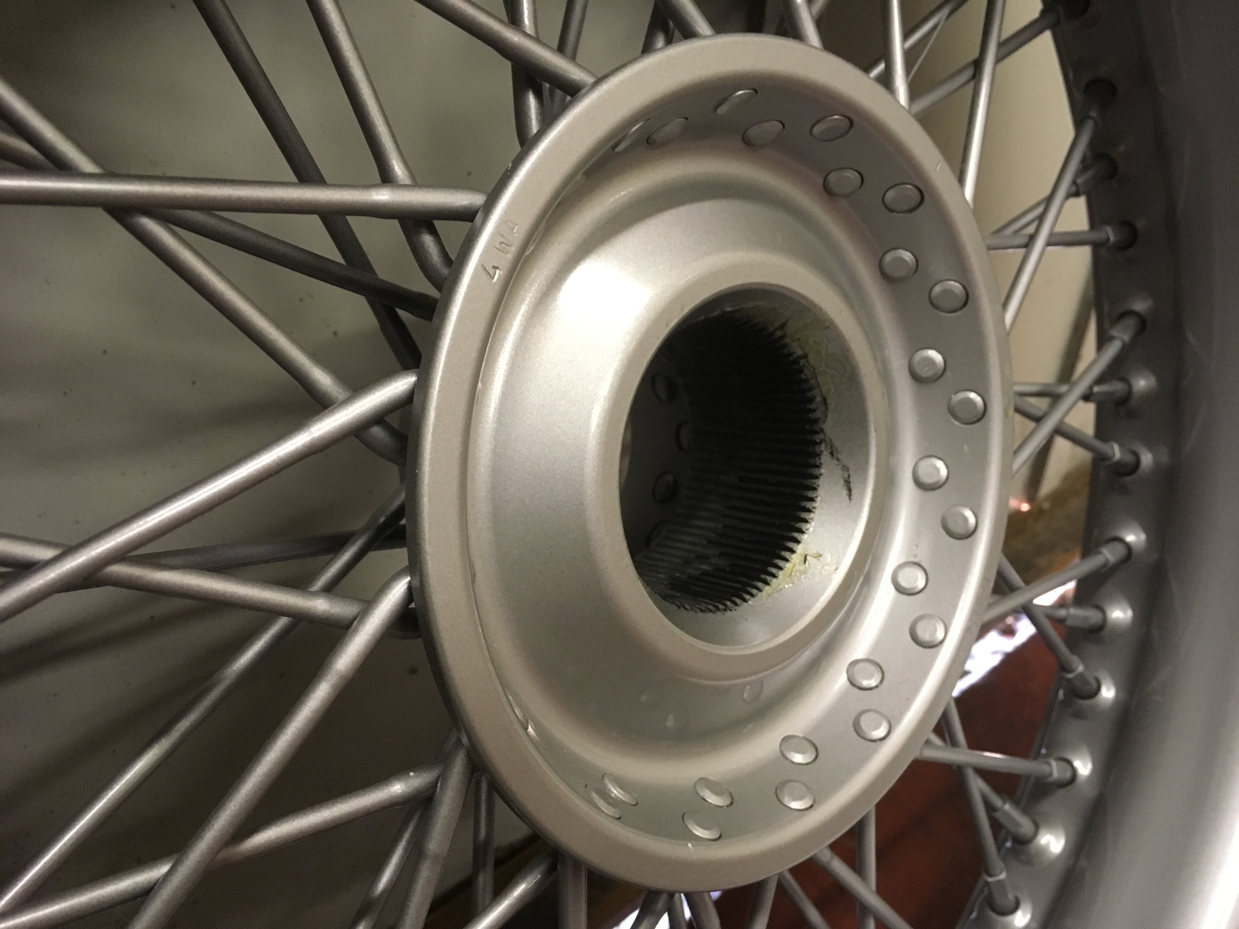

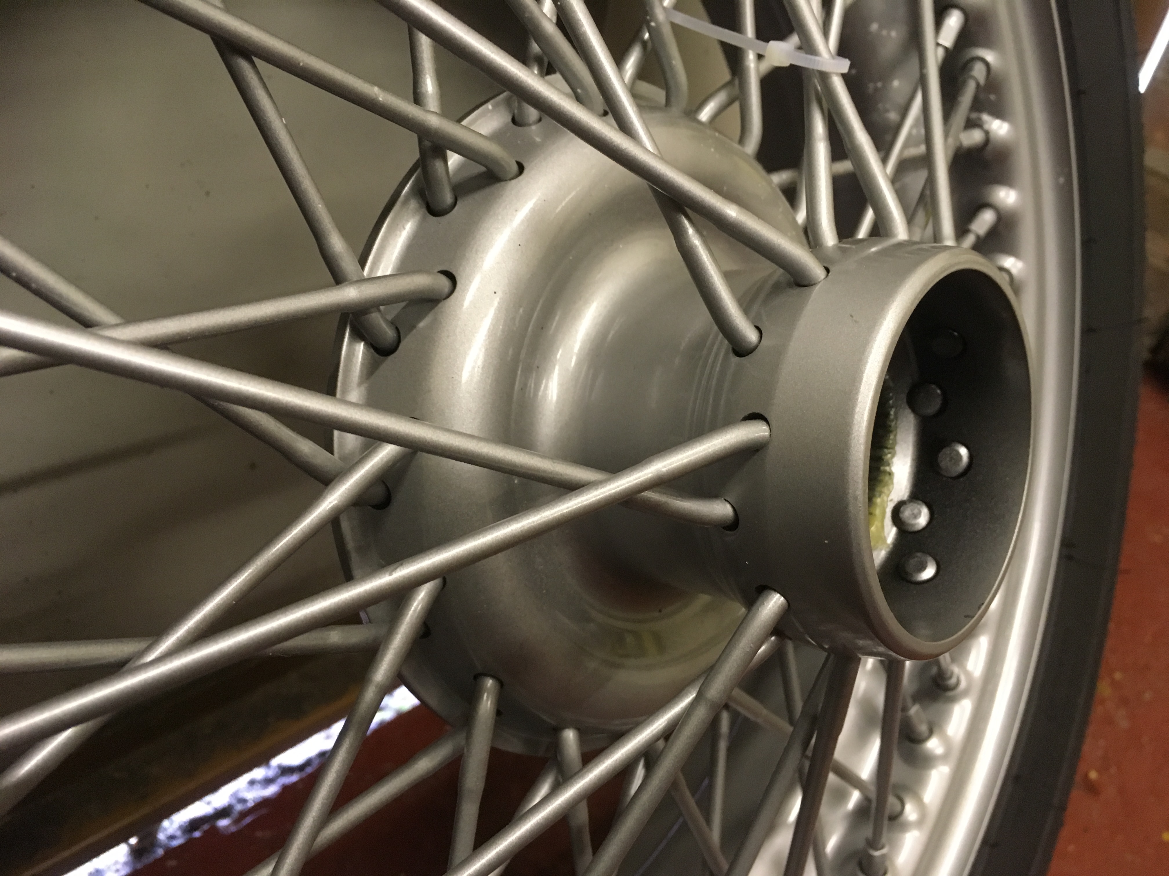

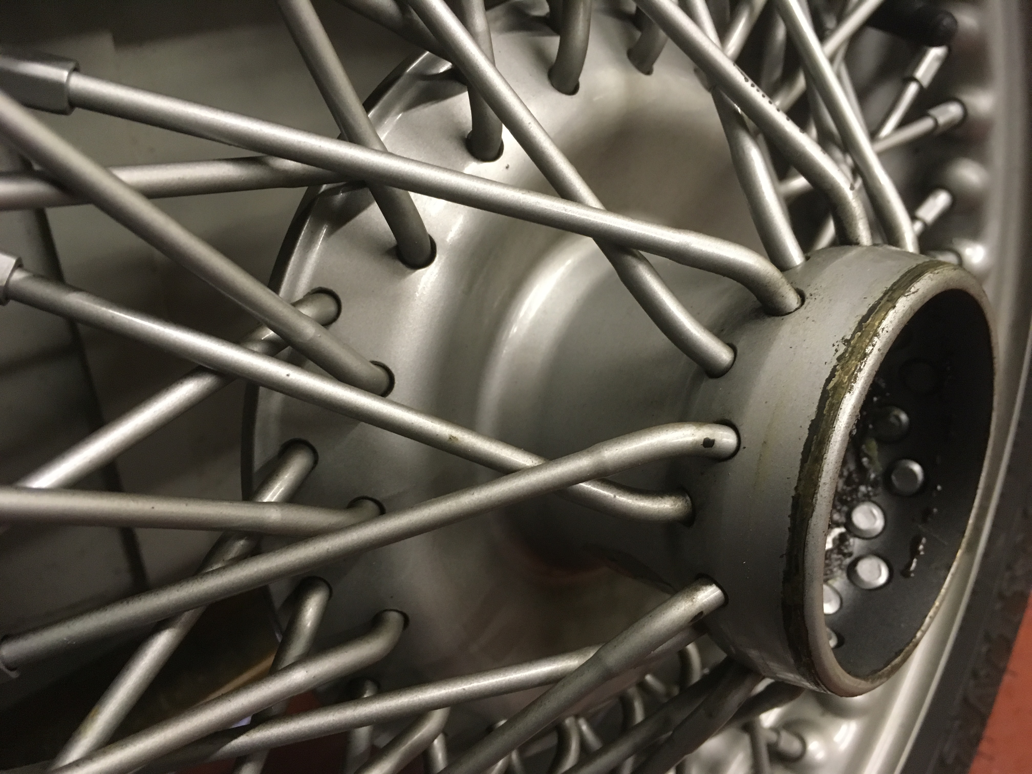

For reference here are some picture "pairs" showing the Whubs of the Spridget 60-spoke, 13x4 wheel (XW458) and the 48-spoke, 15x4 wheel (XW450). The 13" wheels is the first in each pair.
Note how the back of the 13" Whub is much flatter:

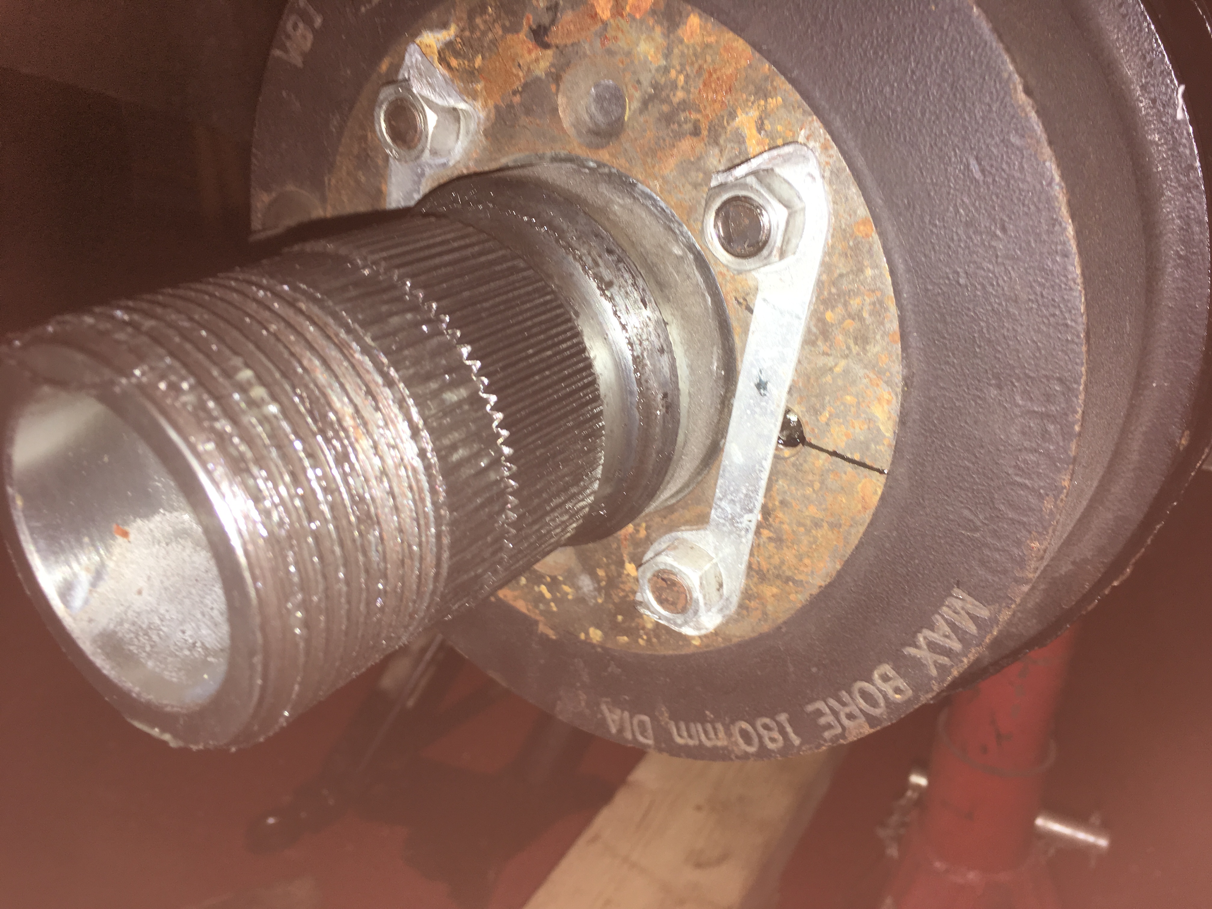

More mystifyingly, I don't know why the 15" Whubs don't fit the Midget rear Shubs. Ignore the disc-wheel axle casting and the hybrid half-shaft red herring; the mechanical make-up of the Shub/brake drum assembly is standard, wire-wheel Spridget. (See the photo below!) The 13" Spridget Whub fits perfectly, sitting snug-up against the brake drum, with plenty of thread protruding for the spinners.The 15" Whub sits ON the drum-retaining nuts, standing-off from the drum and with no thread protruding. Ive just been out to the garage to try it again. Both sides. Same result........ Puzzling!

Just a brief addendum; I was slightly mistaken about the rear fitment. Just like at the front, the Whub should sit on the concave land of the Shub. This leaves a gap between the rear of the Whub and the brake drum; not a snug fit against the drum as I'd previously stated! All three wheels fit so, it's just that the Whubs of the 15" wheels are too long for the threads to protrude......

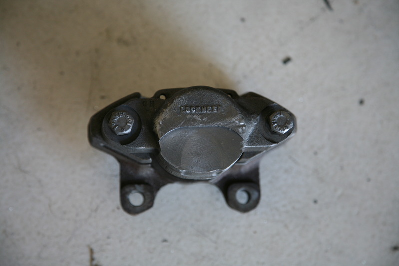

Yes, that's the last caliper I modified. Sent it to the machinist and had it milled. Quick and easy. I have also done this with a rotary file or hand grinder.

With the larger center hubs on 15" wheels, you will have to elongate the already cast-in relief that exists in the standard Spridget calipers. Hardly butchery. You can do this with a rotary file, angle grinder, hand file or mill.
