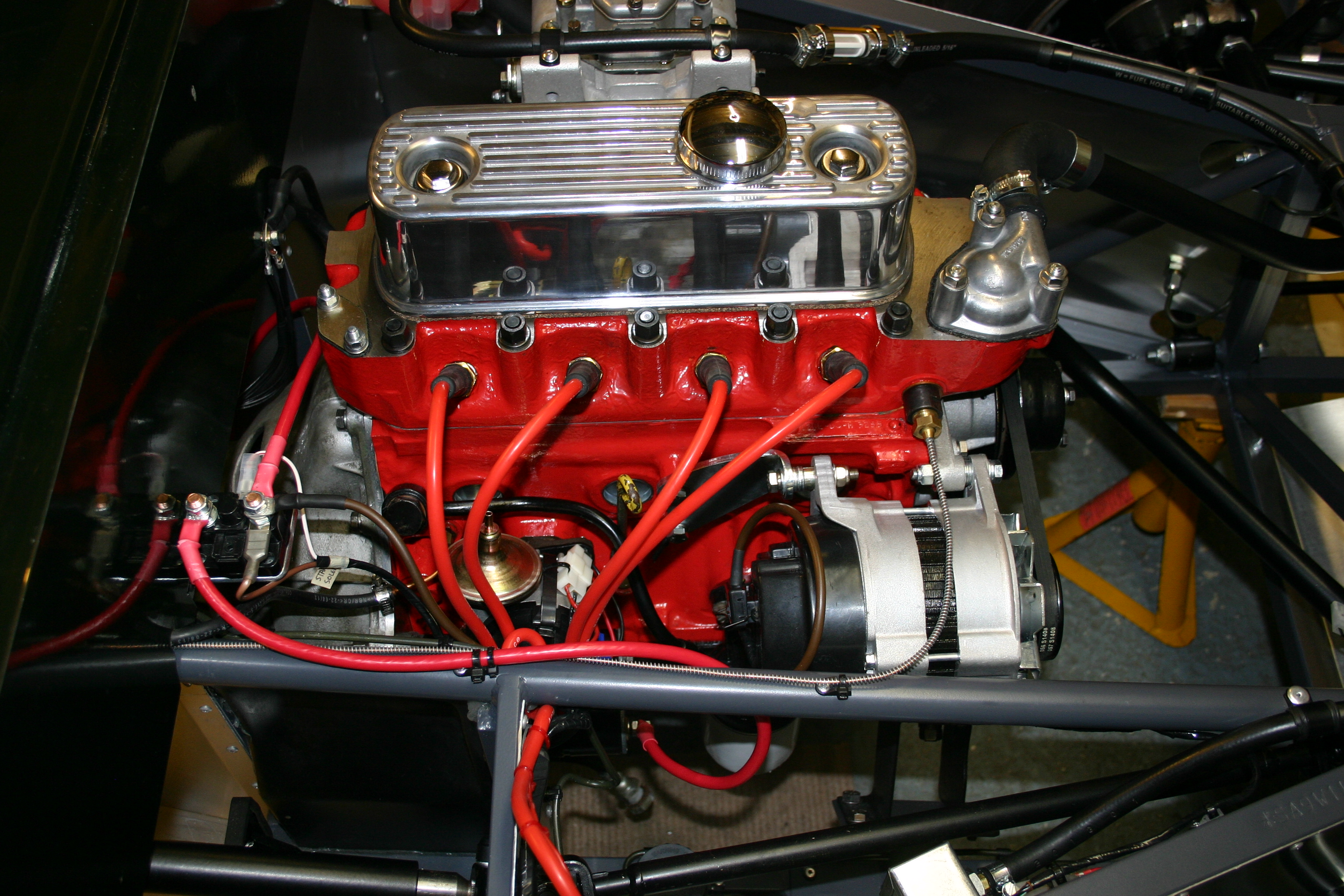

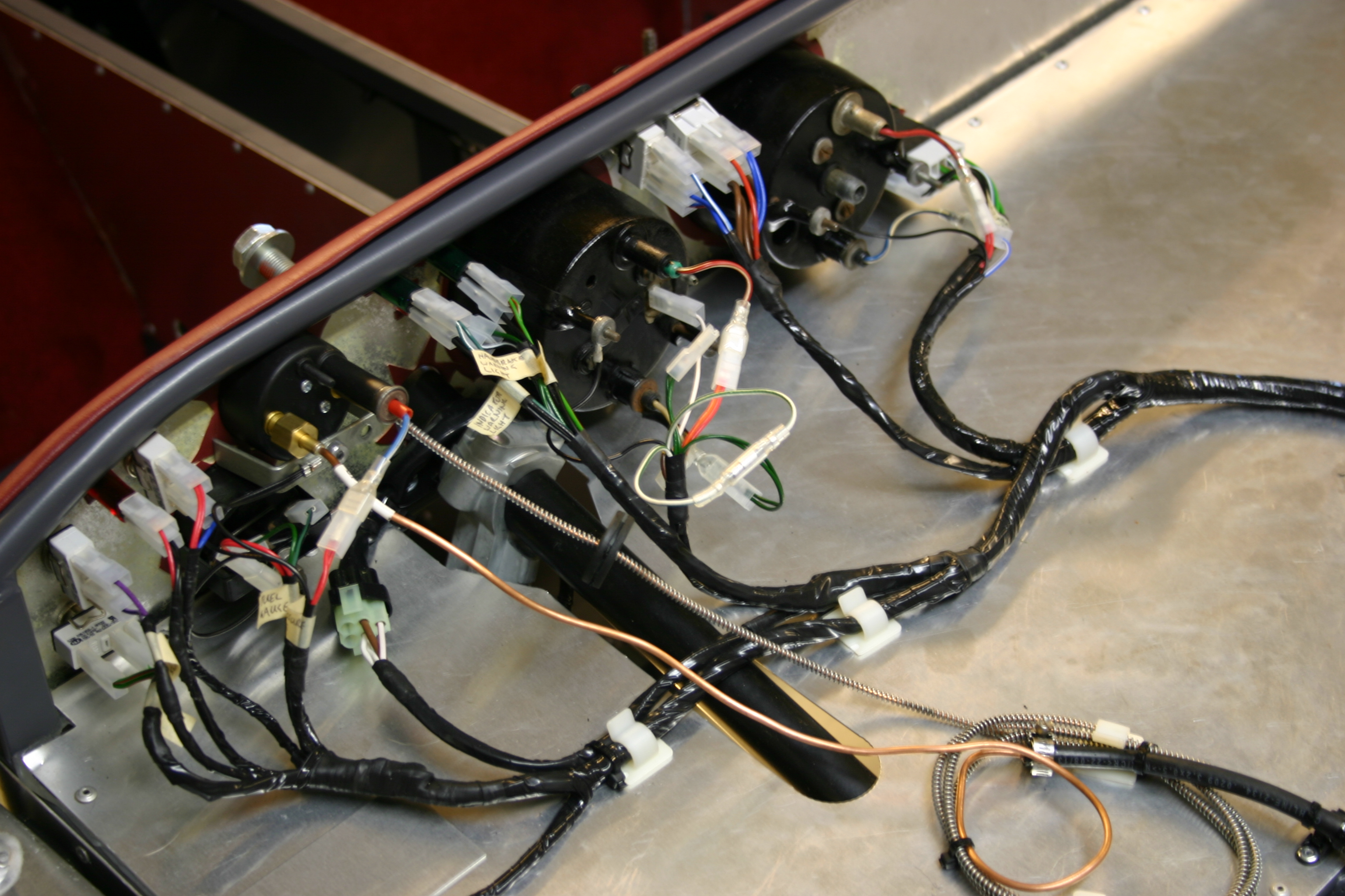

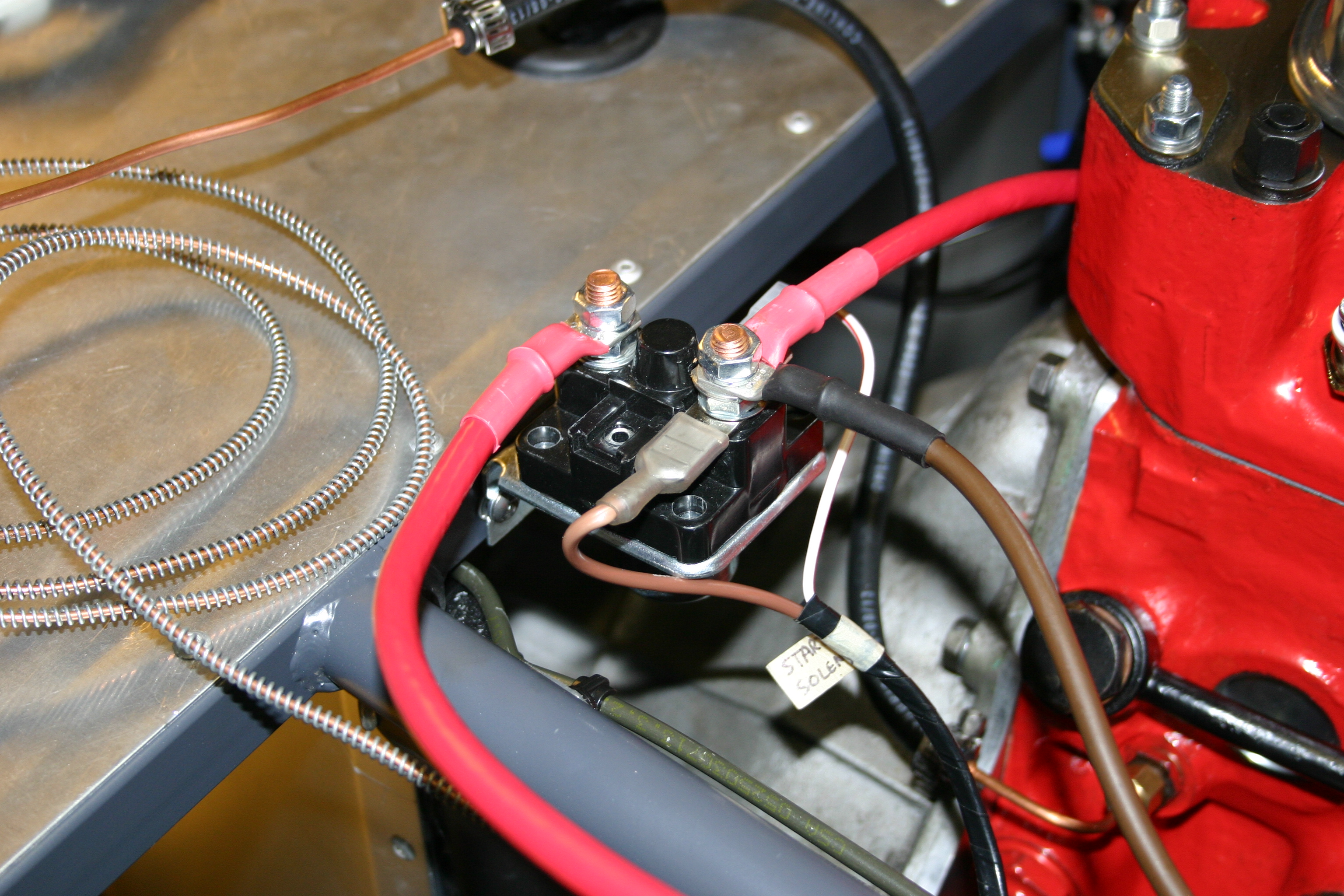

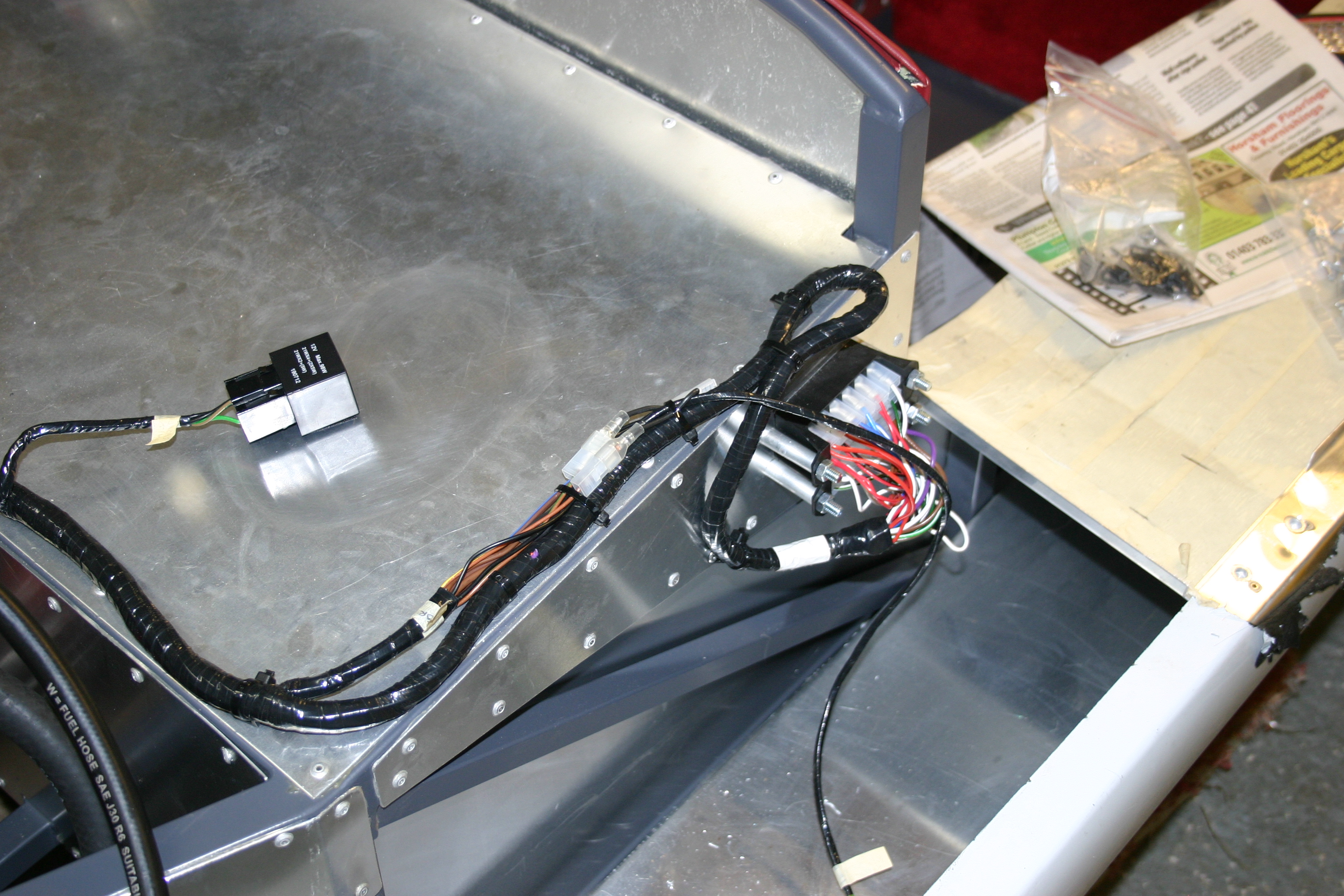

Hi Mark
The Alternator part of the wiring does require some terminating and joining which due to my miss spent youth (too many beers) the old brain has a poor information retention zone and I cant remember off the top of my head which was which but I spoke with Mark at Westfield and he explained what to do.
These pictures will hopefully help (it will only let me do 3 at a time so will do the other one below)
Cheers Si
Cheers Si
