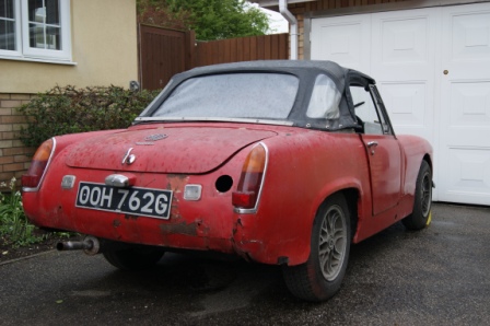

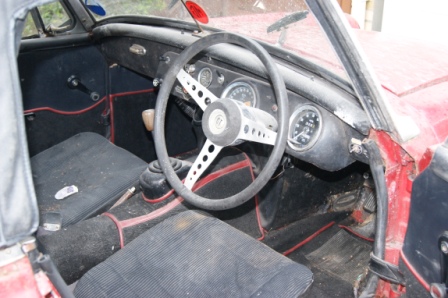

[attachment=0]mg midget 2 compressed.jpg[/attachment][attachment=1]mg midget 1 compressed.jpg[/attachment]Decided a few months ago that I would like to build a XI so with that in mind I checked a few things out with Westfield Sportscars and then spent day after day looking for a suitable donor Midget.
My plans are to gather all the components I need, recondition or rebuild as required and then order the kit. I prefer to do things way so has not to get too stressed with deadlines - had far too many stressful issues with race cars and deadlines in the past.
I am going to build a reasonably high spec car, with a MED (or SC) 7 port head coupled with a 1380 engine on fuel injection, a straight cut 4 speed box, LSD with 4:22:1 ratio etc etc.
So last week I finally managed to find a donor car at the right price (and in the right condition!) in Salisbury and collected in this weekend. My car will have wire wheels and my donor has Cosmic wheels fitted, but I also found in a scrapyard very close to me a 1964 Midget on wires but no V5C unfortunately so I have bought the rear axle complete and the front uprights/hubs.
That's it for the time being, but intend to start the dismantling next weekend.

Thanks for your replies, I will certainly be looking at uprated halfshafts but haven't yet decided which way to go wheel size yet I need to see what the various options look like when fitted to the car.
I totally agree with you Jorn, the XI is a race car and as such it will have the "right noise" from the gearbox and induction. I am leaning towards the 4:22:1 diff for better acceleration as I may be tempted out of retirement and do a few sprints with the car.
Out of interest whilst I was looking at which bit to remove from the car first I noticed that the VIN plate is not quite the same as the V5C and almost certainly looks like an error at sometime in the past, the VIN Plate reads GAN/4 62494G whilst the V5C reads EAN462494G how do I get this corrected with the DVLA while I still have time.
