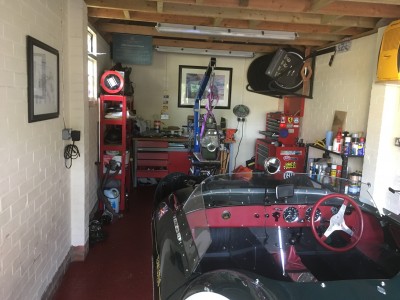

Shortly after our return from Le Mans, my car developed a very noticeable oil leak. It was black and loaded with moli-slip, which pointed to the T9 gearbox. I couldn't get onto it immediately, so I finally pulled the engine in mid-August.
With the engine out of the car it was obvious that the input shaft oil seal had failed. This is very simple to replace and I took the opportunity to suck out the old oil and refill. There's no drain plug on the T9, but with the bell-housing removed and the gearbox angled front down, I was able to suck out all bar about 50cc!
At the same time, I noticed that the aftermarket crankshaft oil seal was starting to fail. My car lost it's scroll-type seal many years ago and the bolt-on replacement kit has never worked perfectly, but it's been pretty good nonetheless. Certainly, it's leaked no more oil than you'd expect of an A-Series. But it was now starting to leak more than I would like. And anyway, the engine's was now out of the car.....
I bought a new seal from Moss, but then discovered that one of the two bolts that hold the two semi-circular halves of the seal holder had seized. Having tried just about everything else, I had to drill the head off. Anyhow...... I fitted the new seal and reinstalled the engine (with a new clutch plate for good measure!).
However, a short test run showed that the newly installed crankshaft seal was leaking like a sieve! So I pulled the engine again, and refitted the seal kit VERY CAREFULLY INDEED. There's a YouTube video (MiniMania, I think) showing it done in stages. The first part is installed and then left overnight for the silicone sealant to set. The second time around, I ditched the Blue Hylomar that comes with the kit in the UK, and used Loctite grey silicone for the rigid metal-to-metal joints and Loctite black silicone for the non-rigid joints. The reassembled engine was then left for a couple of days for the silicone to fully cure before being reinstalled.
That was a week ago. I've test run the car for about twenty miles and then been to the Goodwood Revival and back. So it's done about 150 miles since I refitted the crankshaft oil seal and it's been sat over a drip tray for 24 hours since.
And not a single drop of oil has dripped.
Something must be seriously wrong.................
